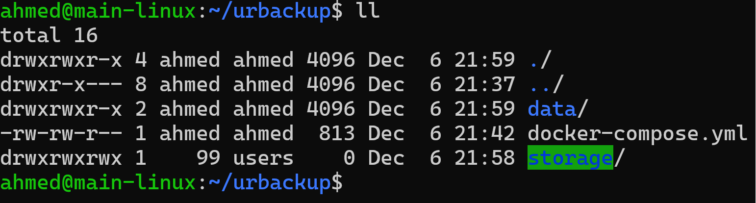

December 6, 20232 yr works like a charm but any idea why the weird user 99? docker was unable to access that folder that I mounted the share to Thanks
