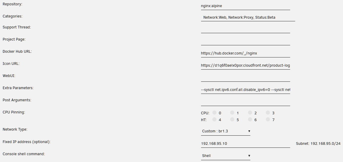

this is a snippet of my nginx reverse proxy running on VLAN3 with its own IP.
Unraid cannot be accessed from VLAN3, only nginx and any related containers on that same interface.
It's up to my router to restrict access to/from other VLANs
Edited by ken-ji
