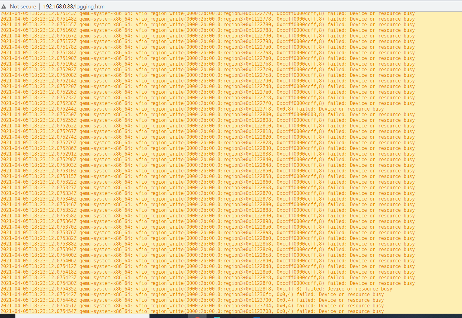

When starting up a VM (Win10 in this case) bellow is the error im getting on the log. (Screenshot also attached)
This is the error code in the log (Log Screenshot Attached)
2021-04-05T18:23:12.073130Z qemu-system-x86_64: vfio_region_write(0000:2b:00.0:region3+0x111d780, 0xccff0000ccff,8) failed: Device or resource busy
2021-04-05T18:23:12.074649Z qemu-system-x86_64: vfio_region_write(0000:2b:00.0:region3+0x1121708, 0x0,8) failed: Device or resource busy
