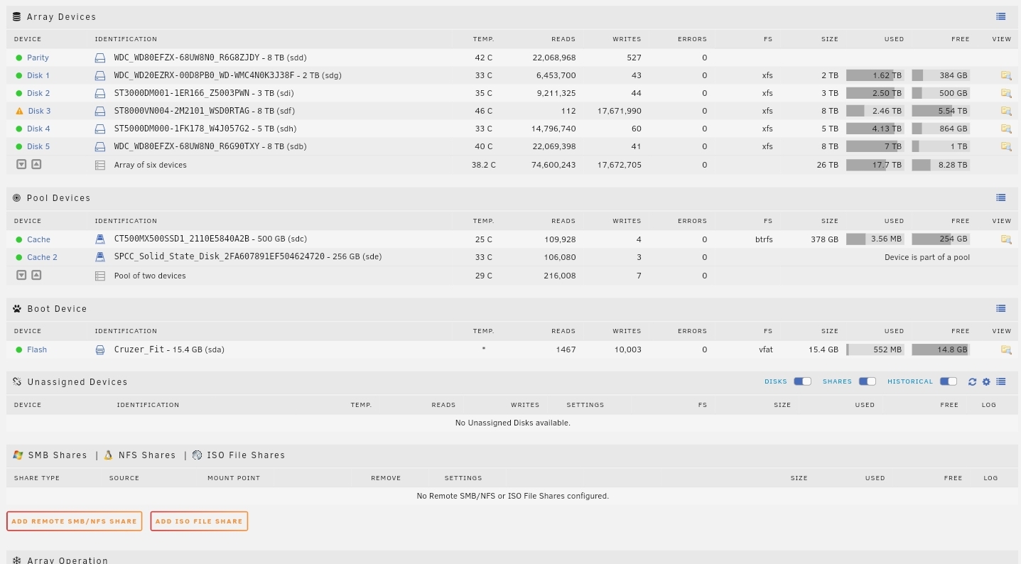

Hope you all can help. Over the weekend I started the process of swapping out two drives that were throwing errors (3tb hd and 500gd ssd).  I swap out the ssd without moving the data to my array and i've also stated syncing my new 8tb drive hd which its almost done.  Once my array is fully sync can I run ca app backup/restore to get my dockers and container and appdata to get my server back up and running with minimally hassle? Or can I just reinstall the faulty ssd (which still works) and then properly move the data to the array?
Sidenote: I have a cache pool (500gb and 250gb ssd).  Not sure of that changes things

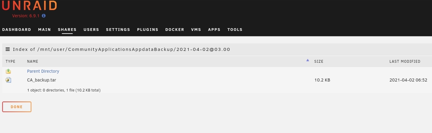

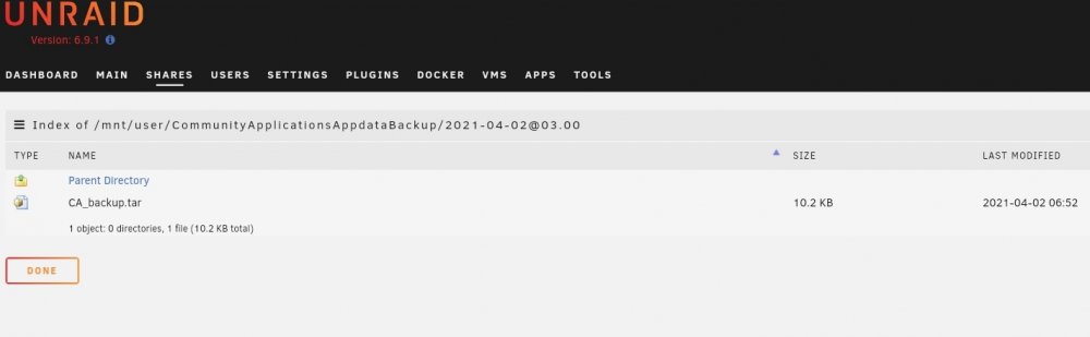

Soooooooo I dont think I have a good backup either :(
 I just tried the backup and there is nothing on the backup

Sidenote: my array is fully synced up with the new 8tb drive and server is back to normal (other then not having my appdata or dockers)
