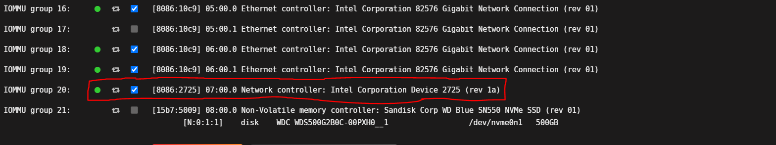

I really don't want to turn Bluetooth off from bios as I would like to transfer the Bluetooth module to Windows10 VM and use it to connect Bluetooth headphones.
Any suggestion on how can stop this log without turning Bluetooth off from bios? I have added Intel network controller 2725 to vfio-pci to isolate it from Unraid, but this is also not helping me!
Any clue how can I pass this to windows vm?
