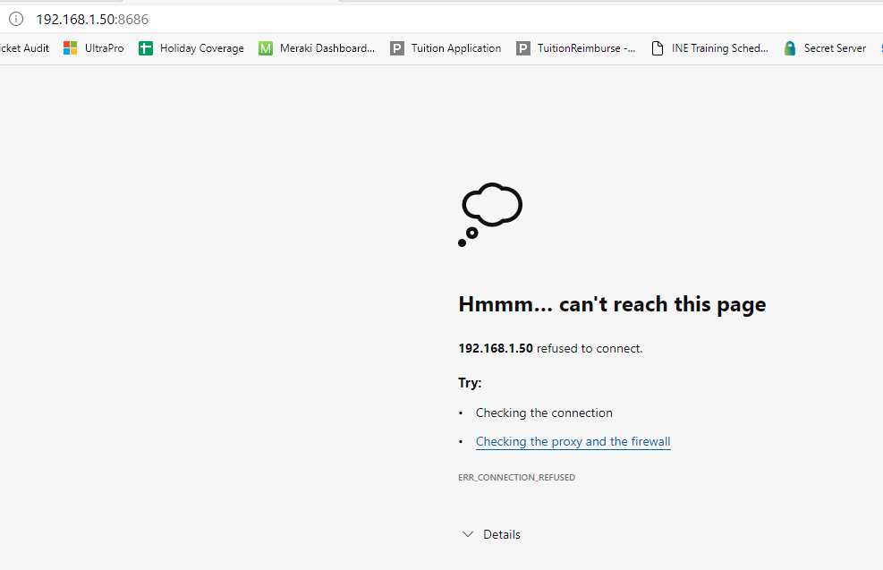

I am having issues with a number of dockers showing refused to connect:

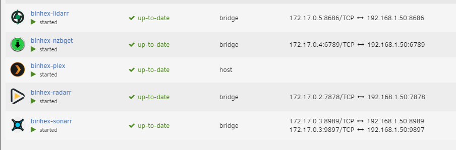

Below are the dockers I have so far:
Plex, NZBgetm and radarr have no issues.
Lidarr and Sonarr refuse to connect

All I can say is, I'm having the exact same problem. Plex, Radarr etc. working fine, sonarr won't be able to connect even though it's started. Setting is exactly matching the radarr setting.... Any ideas?
