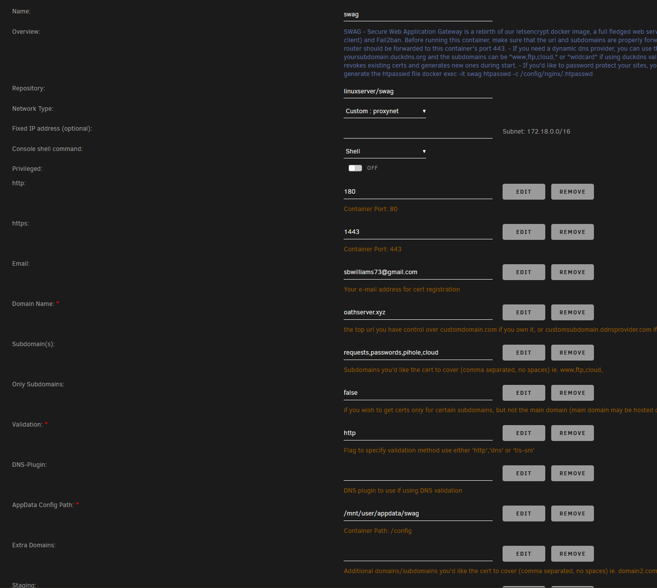

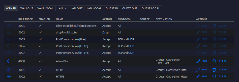

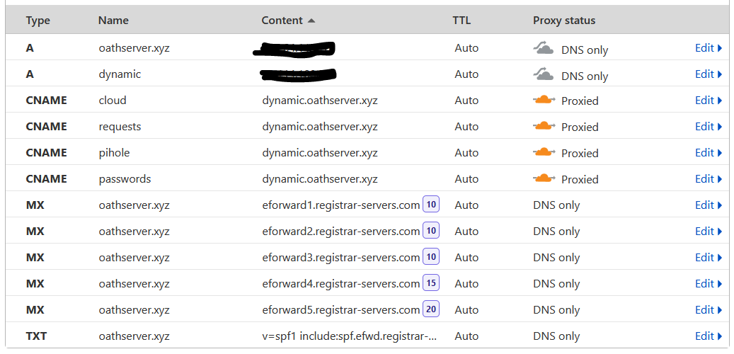

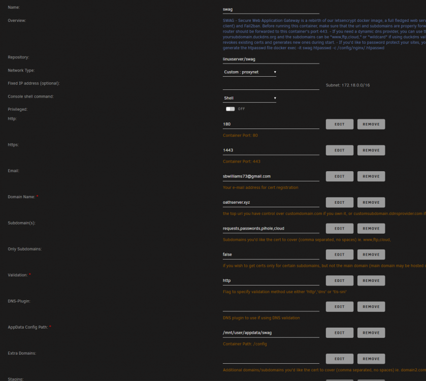

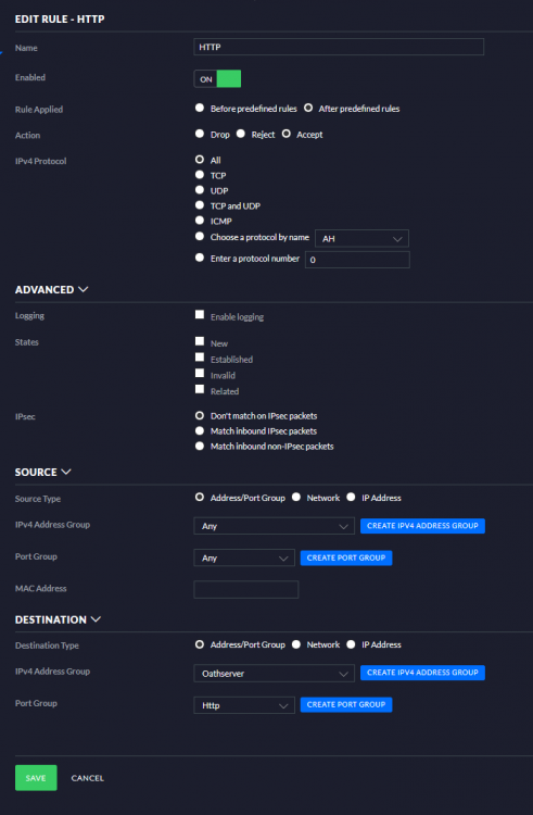

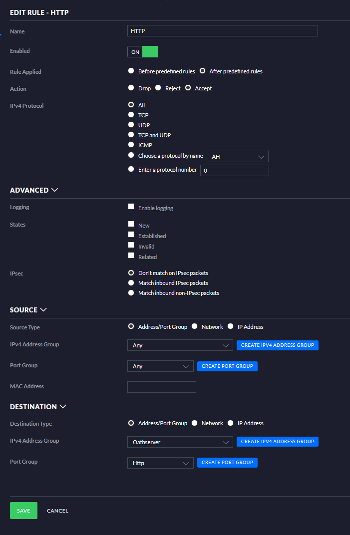

May 16, 20215 yr Hit all im having a heck of a time setting up a reverse proxy following Spaceinvaderones videos. I'm using swag and every time I try starting it up I get several warnings about Challenge Failed on all of my subdomains and an error at the bottom "ERROR: Cert does not exist! Please see the validation error above. The issue may be due to incorrect dns or port forwarding settings. Please fix your settings and recreate the container" Checking my ports with Canyouseeme.com I believe the issue is on my firewall side. I have a UDMP and I think I have the portforword and firewall rules configured correctly but Its likely not given the issues that Ive been having getting it enabled and set up. However when I check canyouseeme for my Plex port, it shows up as blocked also, but I have no issues accessing out of my home network Swag Docker Settings: Cloudflare DNS setting: Unifi Port Forword settings: Unifi Firewall Rules WANIN: All of the WANIN rules are configured the same way. Im on Xfinity and it looks likee they dont have port 80 or 443 blocked. What am I doing wrong and how can I Fix this?
May 16, 20215 yr Not sure if the UDMP is different from my USG but i didn't need additional WANIN rules other than the default port forward rules, (the 3000 rules) Try disabling them for a start. See if that gets you anywhere. I did have some very bizzare issues with VLANS and the USG so it can be very frustrating, it forced me to setup a syslog server just to get the firewall detailed logs to fix the issues. Flub

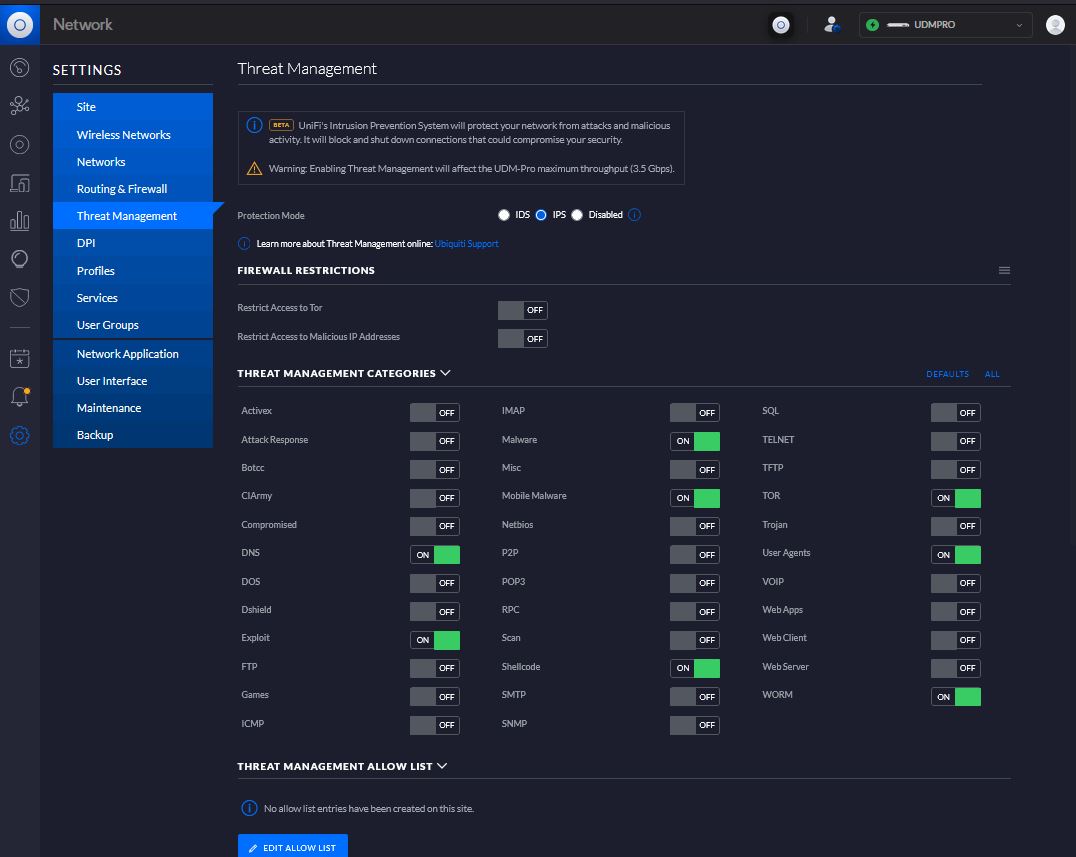

July 15, 20233 yr I had the same exact issue as you did and after a few hours of debuging I managed to make it work... I had some agresive threat management going on, on my UDMPRO, after setting it to defaults it started to work just fine.
