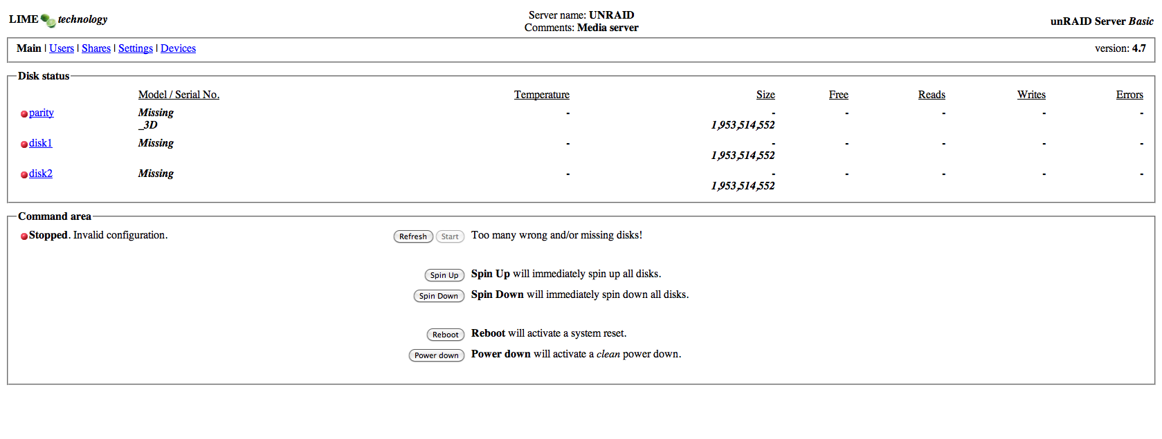

Thanks for the suggestions. I have downgraded to 4.7, but am still having issues. Next to parity disk, it now says "Missing _3D", and it simply says "Missing" next to disk1 and disk2. In the command area, it says "Stopped. Invalid Configuration." and "Too many wrong and/or missing disks!" It doesn't seem to want to recognize any disks now.

Ok, just got home and checked everything out. There didn't seem to be any loose connections, although the server did start up considerably faster this time around. I'm still not having any drives recognized though.
Post another syslog? Look for drive errors like in Rajahal's post.
Did you go to the devices page and check that you could assign the drives?
Peter
A new syslog is attached. I'm not receiving the same errors that were pointed out, but the drives continue to not be recognized. I have also attached a screenshot of my web interface, where the drives don't show up.

I will ask again - did you go to the devices page (look near the top just below and to the right of the Lime Technology) and try to re-assign the disks?
FYI - the main page will never have disk selection drop-downs like 5.0b6 had.
Peter

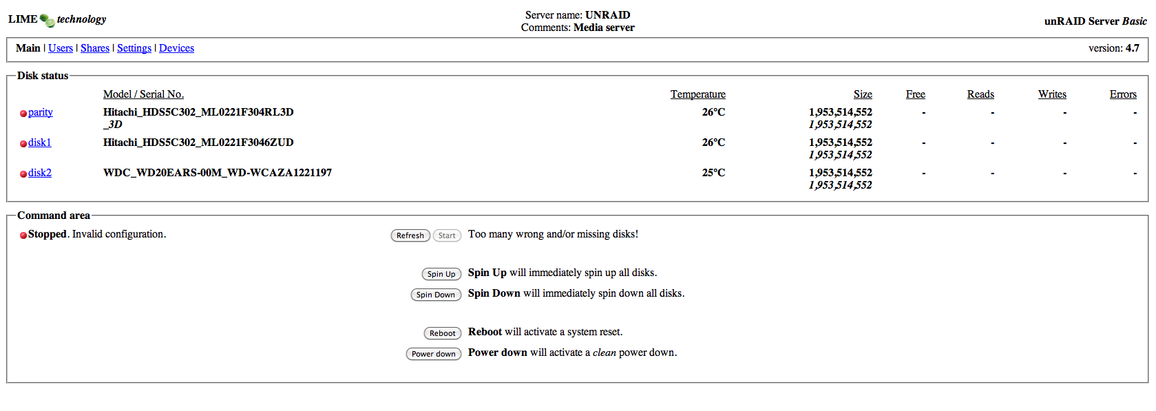

Well I feel like a goon. I was looking for the 5.0b6 interface. I now have the disks assigned, but it still says "Too many wrong and/or missing disks." I tried a few different combinations of assigning the drives, but continued to get the error.
Here is a screenshot of the current interface. Should I continue to post syslogs? I don't think anything's really changing on the server side of things.
You'll probably need to set a new initial configuration.  The old config files and the new (in the 5.0b6 version) are completely different in format.
Ya, log on at the terminal or via telnet and type initconfig. Answer with Yes. Refresh the web interface and you should be good to start.
You could also type -> //"your_server_name"/blank.htm?cmdInit=apply
in a web browser but replace "your_server_name" with Tower or whatever you called the server. This will reset with no confirmation prompt so be careful using it and that you don't accidentally use it at a later date due to say it being kept in your browser address pull-down.
You could also just erase the super.dat file on the flash drive. Share the flash, go to it, delete super.dat and then refresh the browser window.
Peter
