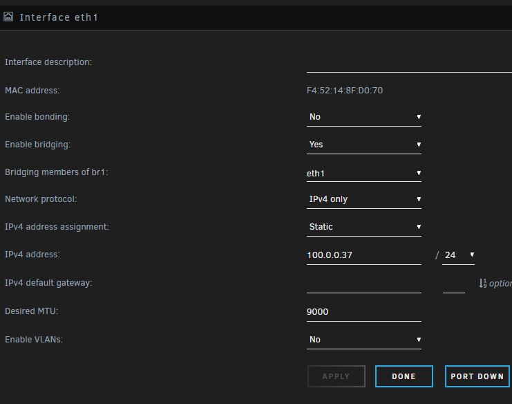

Hi All,
I have been fiddling with this for a while and I can't seem to get anywhere above 3Gb/s.
Both devices are connected to the home network over 1GbE. (10.0.0.0/24)
Both devices are directly connected using 10GbE with a 10M (32ft) Duplex Multimode OM3 fiber cable. (100.0.0.0/24)
I've set both MTUs at 9000.
I hope this info I provided is sufficient if not please let me know.
If anyone could point me at the right direction it would be greatly appreciated.

	Onboard 1GbE 10.0.0.37
	Mellanox MCX311A-XCAT 10GbE w/ MFM1T02A-SR SPF+ 100.0.0.37
