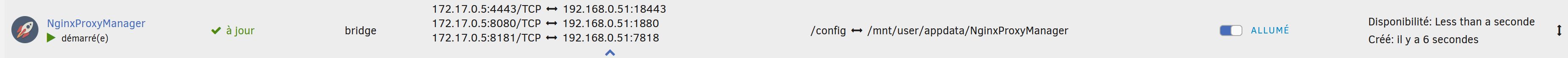

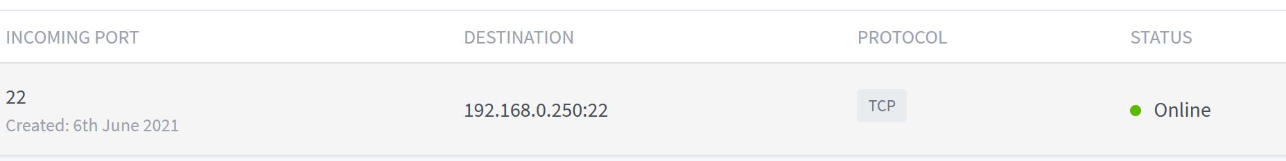

Hello, I was trying to redirect remote SSH access to a VM with Nginx Proxy Manager installed on my Unraid server IP 192.168.0.51 (172.17.0.5 docker).
Local VM IP is 192.168.0.250, access to SSH port 22 within local network is OK.
Access from outside network with SSH port 22 or 443 failed.
My router redirect port 443 to 192.168.0.51
I've tried to configure my router redirecting port 22 to 192.168.0.51:22 or 192.168.0.51:443, either doesn't work.
Any help is appreciated. My guess is that I need to redirect port 22 from 192.168.0.51 -> 172.17.0.5, but I don't know if there's any listening port on the docker for SSH configured.
