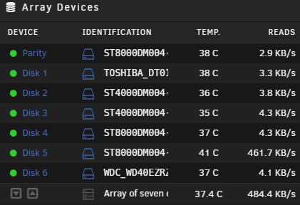

Hey,
The past few days i've noticed all my drives were awake, when they usually aren't as it's mainly plex media on my drives and they spin up when being streamed. Even the parity drive is being kept awake. I don't think i've changed anything but i've been running unraid for years without issue, and suddenly past few days they're all being kept awake. I'm noticing very small reads every 30seconds or so on all drives.

There are some known issues with v6.9.2 and spin down, you can try downgrading to v6.9.1 and see if it helps.

Unfortunately this didn't work, i'm still getting lots of little reads on every drive.
Than you likely have some plugin or other issue keeping the drives from spinning down, note that a frequent low number of reads is normal when the drives are up to get SMART/temp, but these shouldn't prevent them from spinning down.

After waiting a while, the drives are actually going to sleep. It's just misleading seeing all the little reads. The revert to 6.9.1 looks to of solved it, thanks :)
The same problem here. Each time I visit server's dashboard all drives wake up. This started after updating the "My Servers" plugin to version 2021.06.07.1845.
YES! That might actually be it for me too. Was wondering which app i updated that caused this, and i guess it was my servers...
Uninstall it is
Even made another thread...
