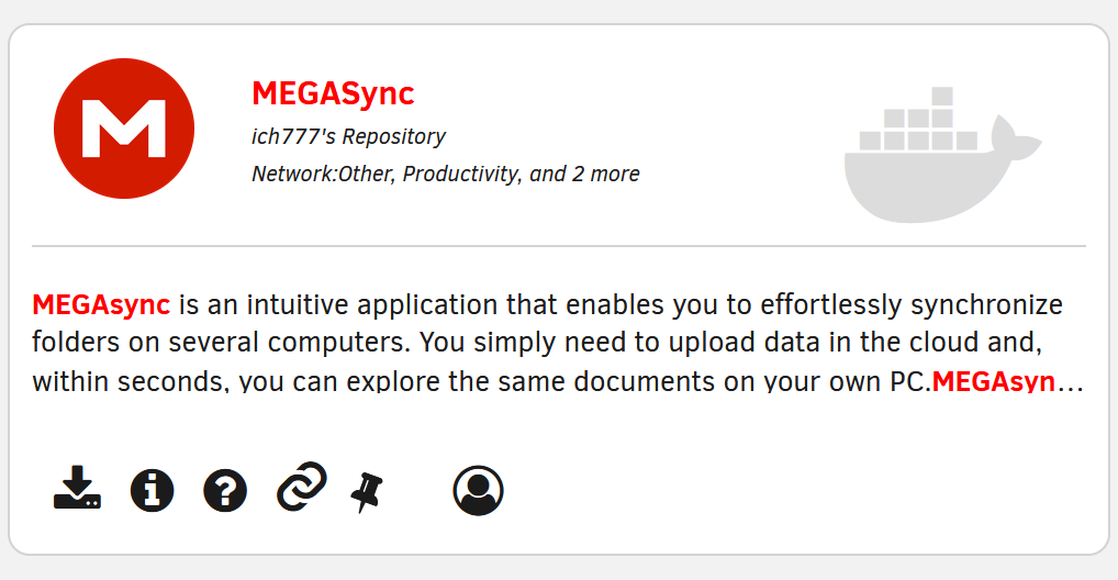

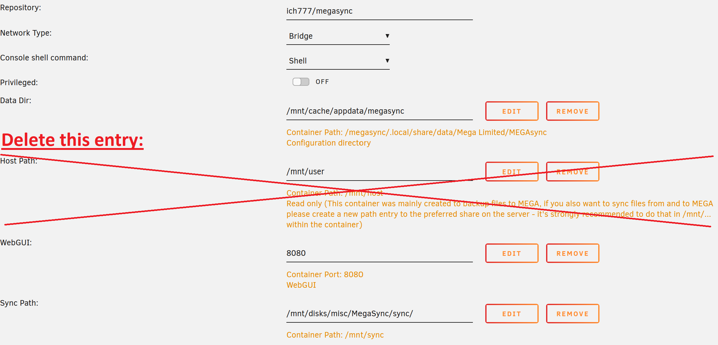

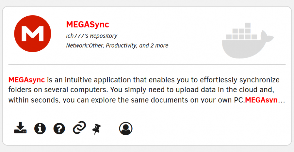

  1. Download the MEGASync container from the CA App:

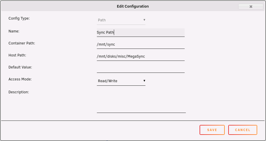

  2. In the container itself delete the Host Path and create a new one like described in the next step:
  3. Click on the bottom on 'Add another Path, Port, Variable, Label or Device' and create a path like this (please make sure that you change the path to something that exists on your system), click on Add and then on Apply to start the container:

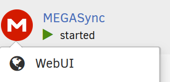

  4. After the container has started make sure that you enable Autostart:

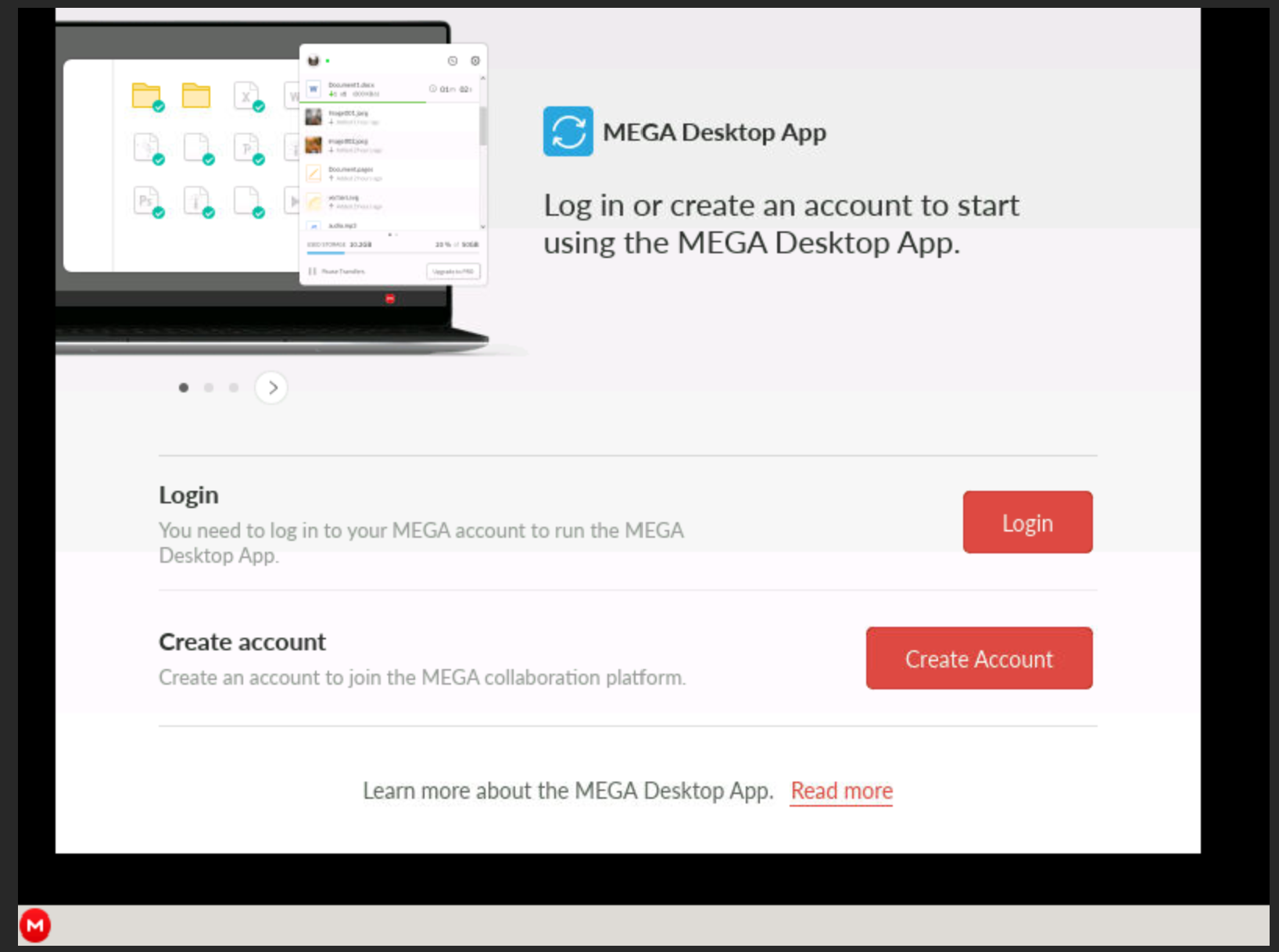

  5. Click on the MEGASync icon on your Docker page and click on WebUI:
  6. After the WebUI opened click on Login and login with your credentials (please not that the Create Account button won't work in the WebUI):

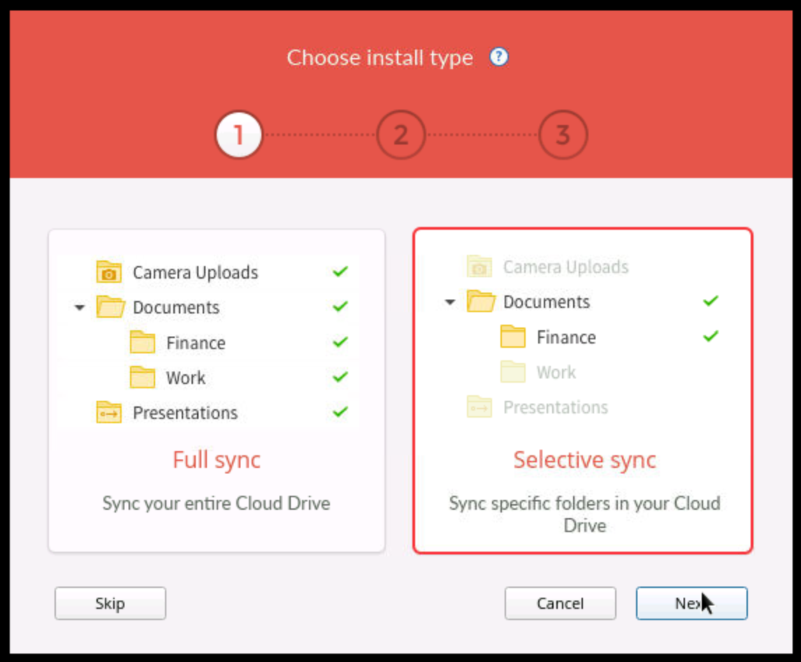

  7. At install type select Selective sync and click on Next:

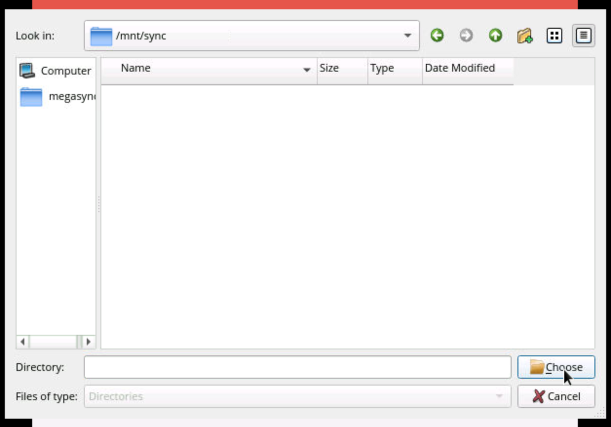

  8. Click on Change at local folder:
  9. Navigate to /mnt/sync and click Choose:

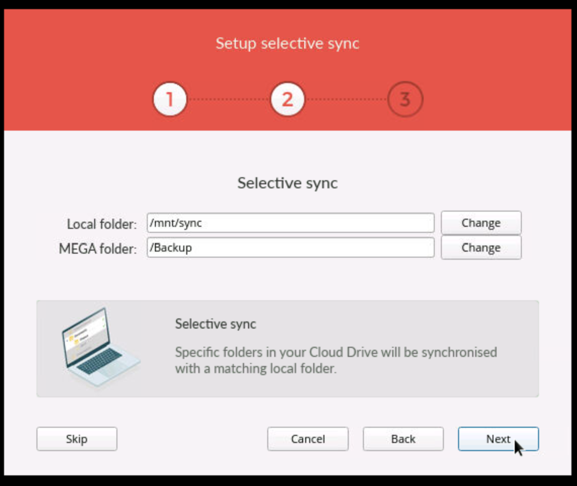

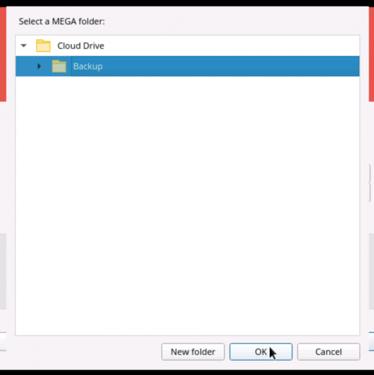

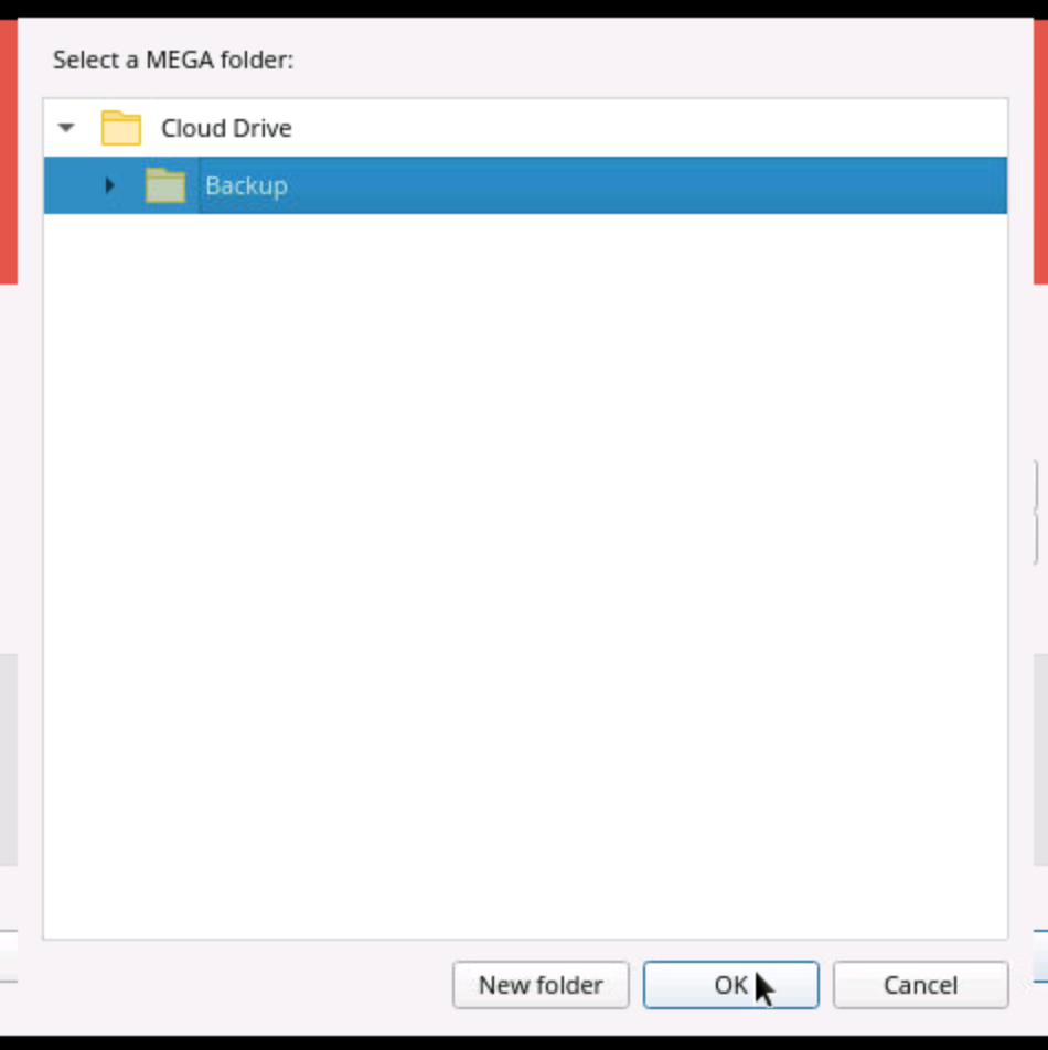

  10. Click on Change at MEGA folder:
  11. And create a new folder below Cloud Drive that is named Backup (if you backup more than one Server I would strongly recommend that you create individual sub folders in Backup for the individual machines that you back up):

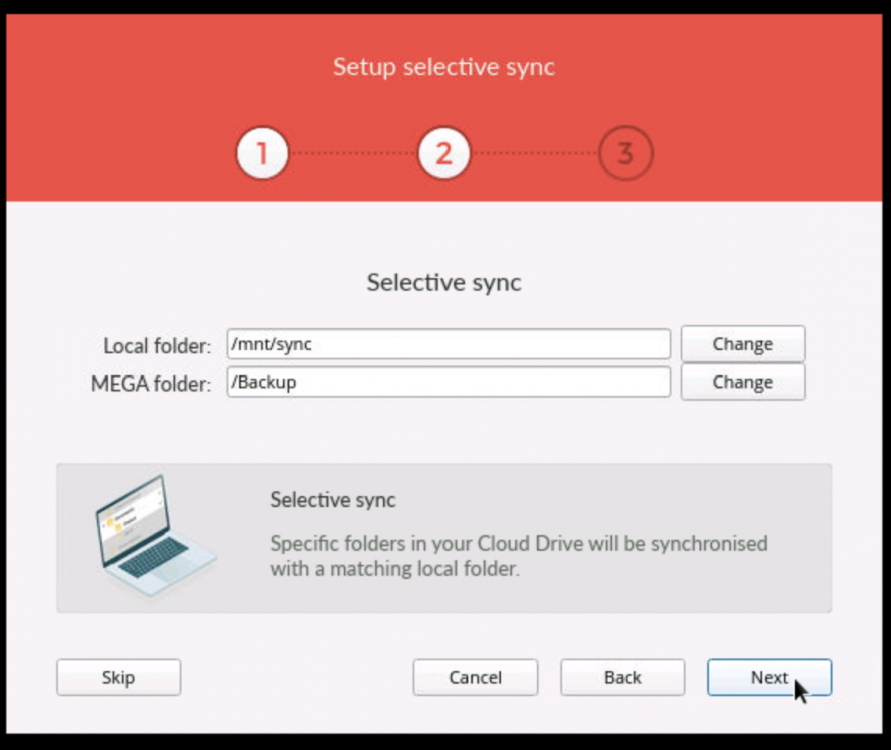

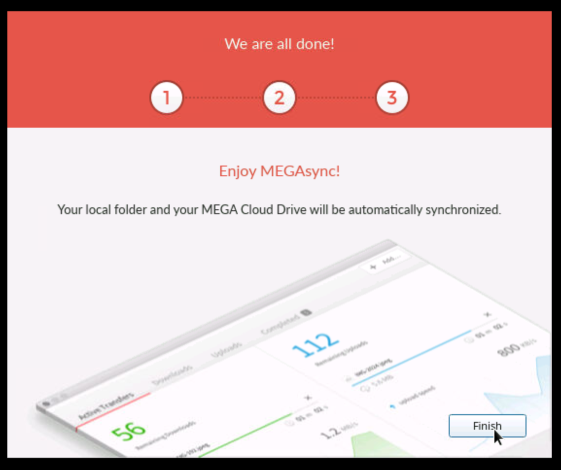

  12. Click on next:
  13. When you see this message click on Finish and close the WebUI:

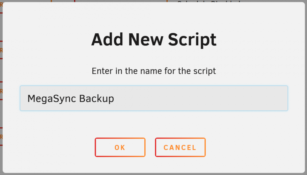

  17. Type in your preferred script name and click on OK:

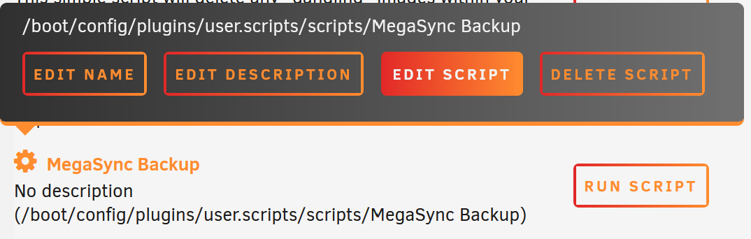

  18. Hover over the little gear icon and click on Edit Script:

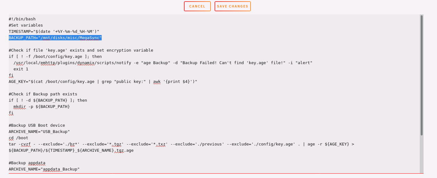

  19. Copy the contents from the downloaded script from Step 14 in the textbox
    (Please first read trough the script and see if it fit your needs!
    NEVER BLINDLY COPY A SCRIPT FROM THE INTERNET OR SOMEWHERE ELSE AND EXECUTE IT ON YOUR SERVER READ FIRST THROUGH IT AND MAKE SURE IT FIT YOUR NEEDS AND IS CONFIGURED PROPERLY) :
  20. Make sure to modify the BACKUP_PATH to the Host path that you configured in Step 3 for the MEGASync container (this should be a empty directory with nothing in it since the script deletes everything in it except the current backup):

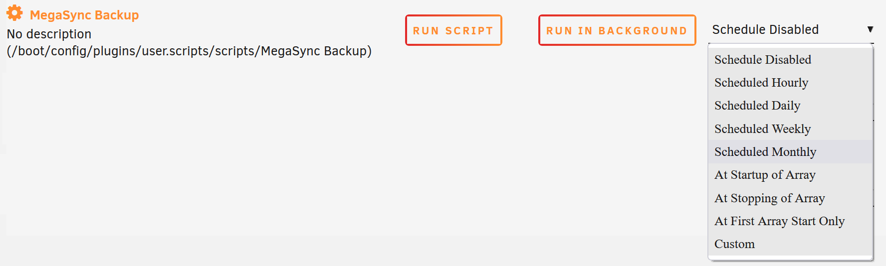

  22. Select a schedule from the drop-down menu or create a custom one (if you create a custom one I recommend looking into crontab.guru) :
  23. After you've selected a schedule don't forget to click on Apply on the bottom:
  24. Now you can click on Run Script to see the actual output from the script (keep in mind if you close this window the script will be aborted!) or you can click on Run in Background to run it in the Background now.

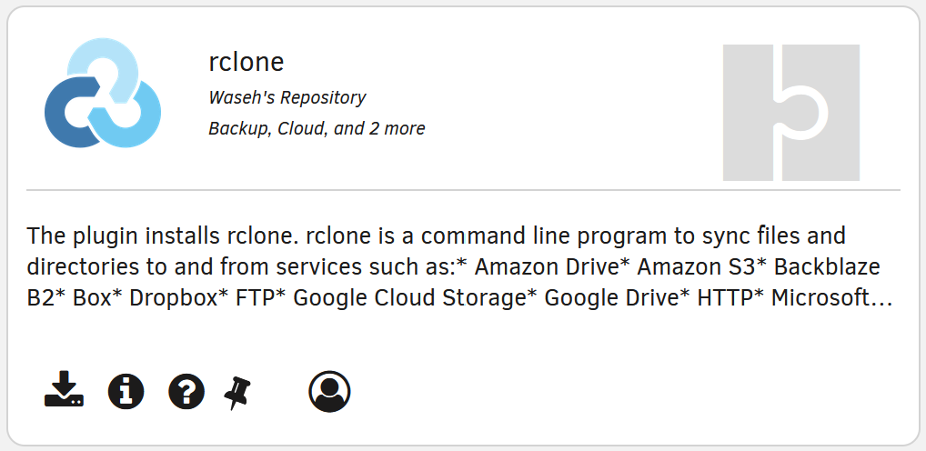

  1. Download the rclone plugin from the CA App:

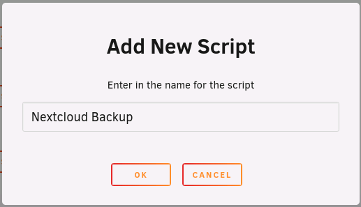

  17. Click on Add new Script:
  18. Type in your preferred script name and click on OK:

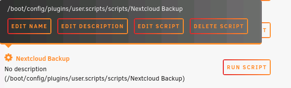

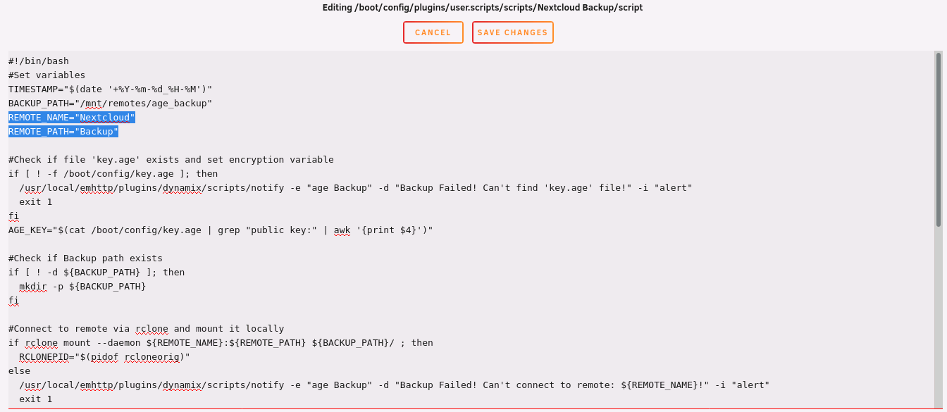

  19. Hover over the little gear icon and click on Edit Script:
  20. Copy the contents from the downloaded script from Step 15 in the textbox:
    (You don't need to change the BACKUP_PATH since this path is used to mount your cloud storage to your server, this path should
    be empty and is created if it doesn't exists!)

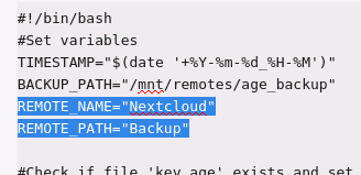

  21. Make sure to modify the REMOTE_NAME to the name that you specified in Step 4 in this case 'Nextcloud' and also make sure to modify the REMOTE_PATH to a directory that exists in the root of your Nextcloud or create a folder in the root of your Nextcloud named 'Backup' like in this example (if you want to sync to a subfolder you have to modify the REMOTE_PATH to something like this: 'Backup/MyUnraidServer') :
