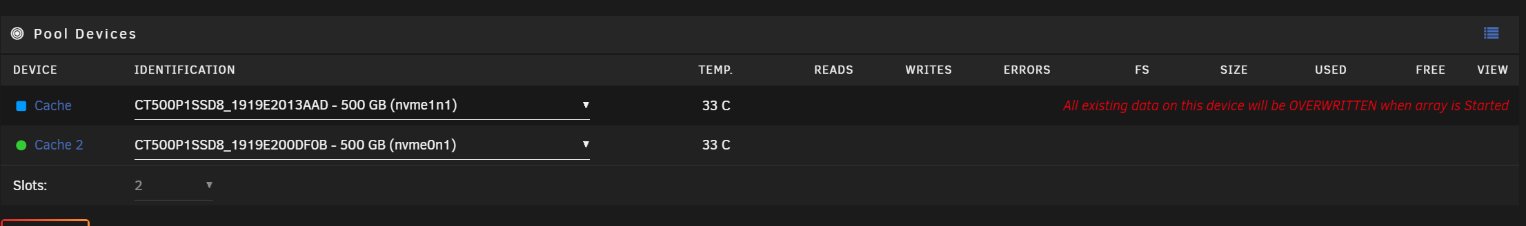

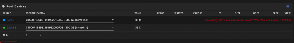

  8. if I try to assign the missing drive in it's original place it shows the following warning "All existing data on this device will be OVERWRITTEN when array is Started"
At no point have I started the array so I think I'm still safe...my initial instinct was to rebuild the flash from the online backup...BUT... it seem to have been overwritten just as I booted (even without starting the array...doh...)
Seems to me that there is probably a very simple solution here but I'm not seeing it ...maybe because of the scary warning

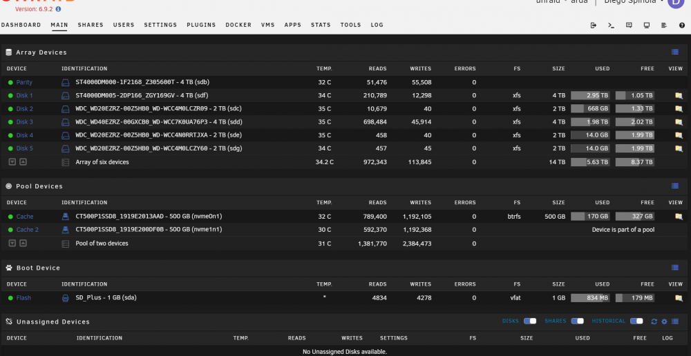

Here's a couple of screenshots... still haven't dared to start the array out of fear :
Now:
Before:

Remove both cache devices from pool, start array to force Unraid to forget them, stop array and assign both as they were, the all existing... message should go away.

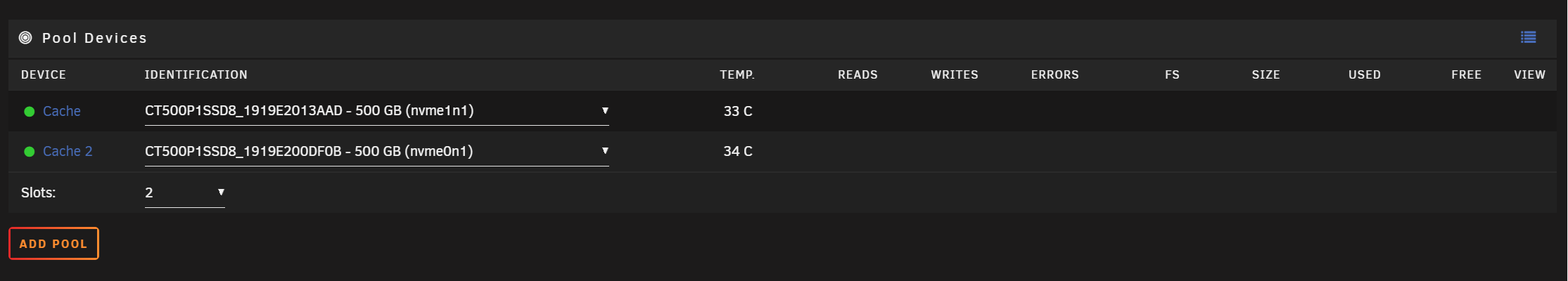

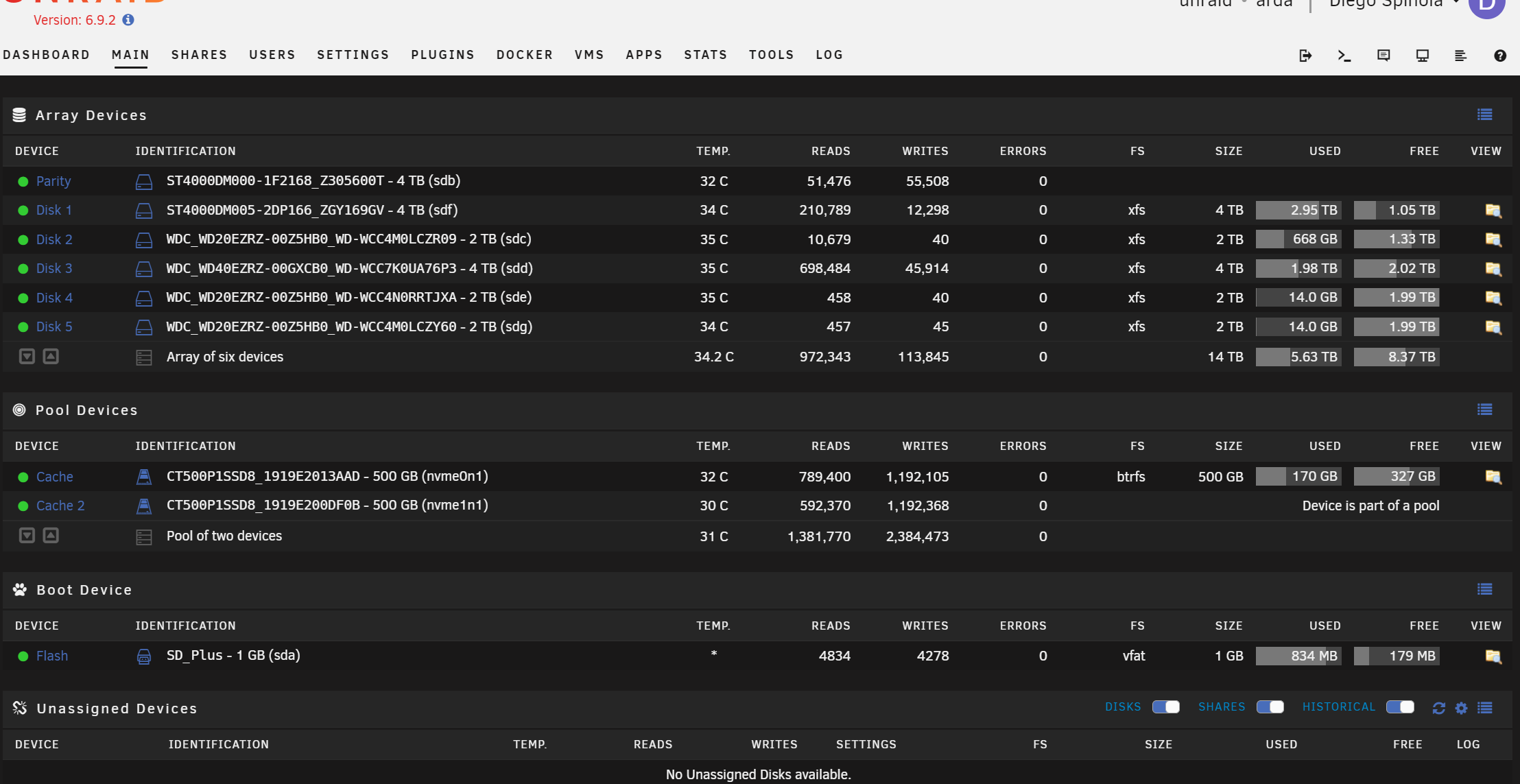

Something really weird just happened: I rebooted the server (Again without starting the array) and it seem to have "remembered" the disk:
all by itself...
any way to check that it won't destroy my data before staring the array?

Since the message is gone it should be fine.
Thanks @jonathanm , it ended up working perfectly , strange behavior tho , I'll report it as soon as I'm finished with the upgrades
