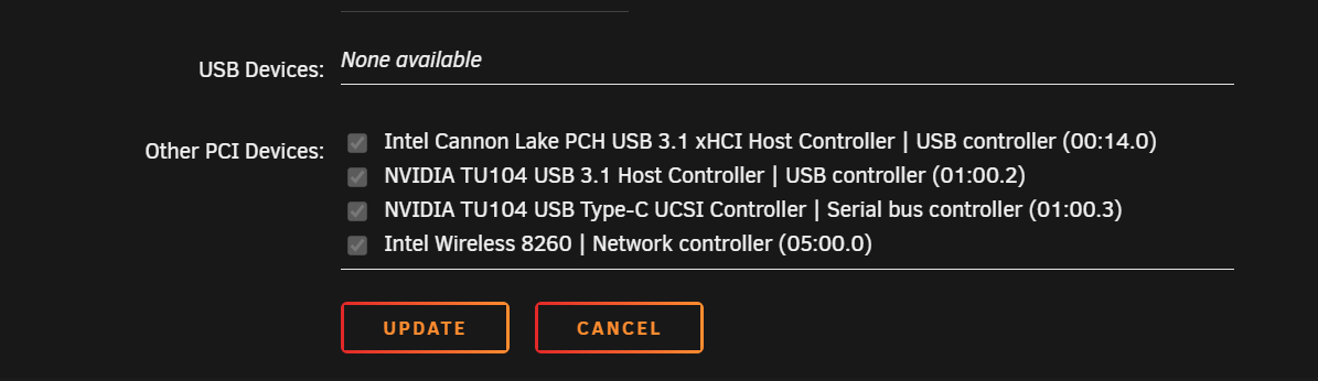

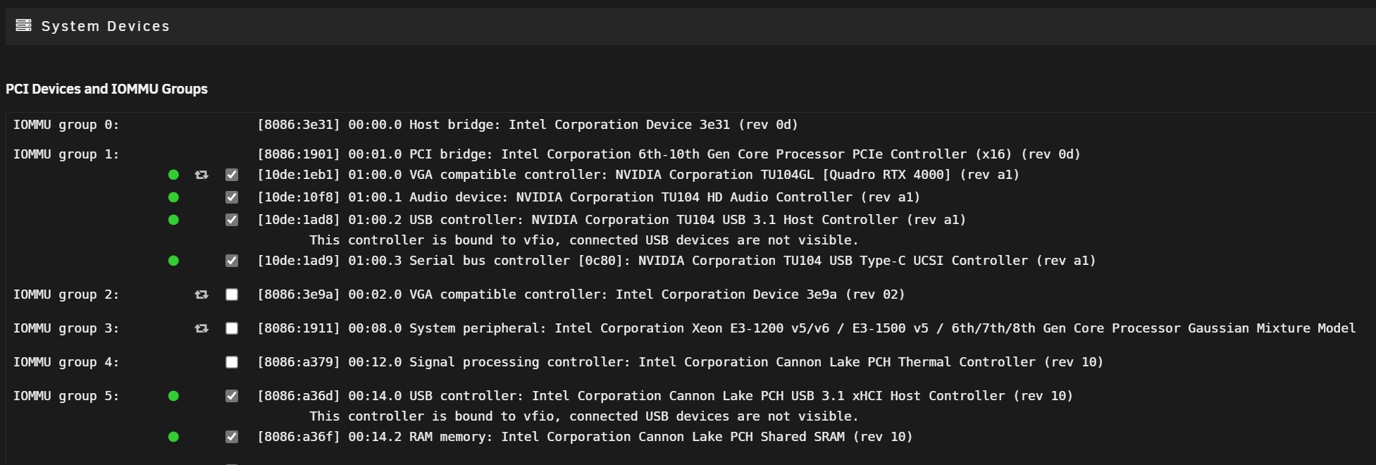

I have a Windows VM with a passthrough Nvidia GPU (Quadro RTX 4000), and I also passthrough the primary USB Host controller (which is bound to VFIO at boot):
I have the primary Monitor connected through USB-C connection (which in turn allows me to use the monitor's USB hub for keyboard, mouse, etc ...) There are also two other monitors connected through DisplayPort.
Everything works fine... typically ... except if I reboot the server (when doing upgrades) Windows VM will not load while the USB-C is connected! if I disconnect the USB-C and keep the other DP connections, windows will boot just fine, and I can connect the USB-C cable after the login screen shows up and everything is peachy ...
