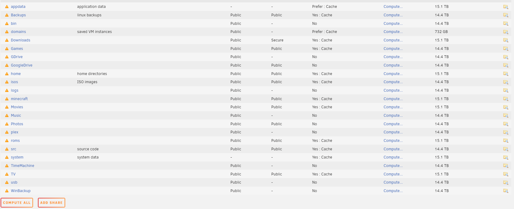

I am having some issues with my array.
Firstly unraid is not detecting a disk, even though the disk shows up in the raid controller.
the array shows the disk with a red tick and is unassigned.
When I start the array it says that the array is unprotected?
how can i remove the dead/undetected disk from the array and start the parity check?

Firstly, if you do not need all those packages being installed with NerdPack, set them to not install.  Some of them (notably atop) will cause you issues.
I don't see why it's not detecting disk 3 at all, but you need to either replace it and rebuild onto the replacement, or remove all of the files from the emulated disk (unbalance plugin) and then do a new config and then rebuild parity to reflect the non-existant drive.
Are you sure it's showing up in the controller's BIOS?
