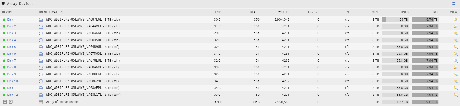

Image attached of the setup in UNRAID
Have I setup UNRAID Array correctly as Raid0?
I'm beginning to think I have not!!!

Unraid does not implement what is normally meant by RAID0 (and hence the name).  Unraid will never have the performance of a more typical RAID system for a number of reasons
  • Each array drive is a self-contained filing system and so files cannot span drives and striping cannot be used.  Reads are therefore limited to the read speed of any drive involved in the read.
  • For writes Unraid updates parity in a completely different way to a standard RAID system which leads to significant performance overhead.
The techniques used for Reads and Writes are described here in the online documentation that can be accessed via the Manual link at the bottom of the Unraid GUI.
If you want to use Unraid with performance as the main criteria then you should not use the main array for the data but instead look into use Unraid BTRFS pools as these operate more like a traditional RAID system.
