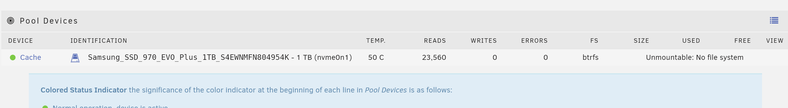

Current situation:
  • Original cache drive is still in the cache pool - but it says Unmountable: no file system'

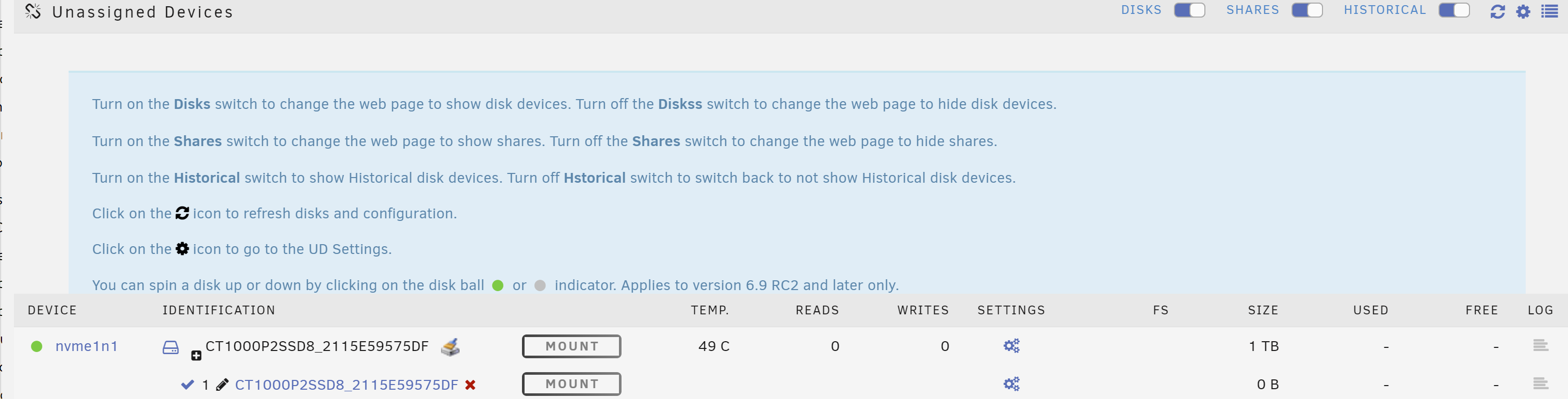

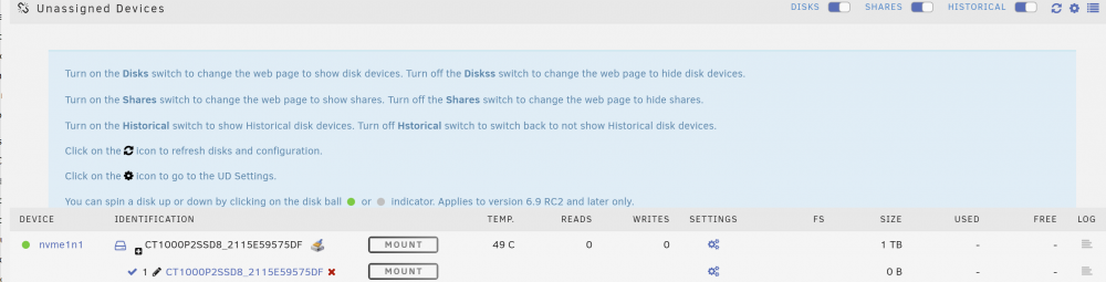

  • Second cache drive is in unassigned drives
  • I'm realising now that I should have just added the second SSD as an unassigned device ( I actually did this first but then changed my mind.. )
Please does anyone have any advice of where to go from now? I can only assume that somehow setting the pool to 'Single Device' has severely messed things up and I really have no clue how to reverse the damage. I likely don't need to recover any data from the second ssd as it was only fitted today and the only thing I've really done today is install games. But I do need to get back full access to the original cache drive.

Error log from original cache drive:
Jun 26 22:29:09 Andromeda emhttpd: Samsung_SSD_970_EVO_Plus_1TB_S4EWNMFN804954K (nvme0n1) 512 1953525168
Jun 26 22:29:09 Andromeda emhttpd: import 30 cache device: (nvme0n1) Samsung_SSD_970_EVO_Plus_1TB_S4EWNMFN804954K
Jun 26 22:29:29 Andromeda emhttpd: Samsung_SSD_970_EVO_Plus_1TB_S4EWNMFN804954K (nvme0n1) 512 1953525168
Jun 26 22:29:29 Andromeda emhttpd: import 30 cache device: (nvme0n1) Samsung_SSD_970_EVO_Plus_1TB_S4EWNMFN804954K
Jun 26 22:30:20 Andromeda emhttpd: Samsung_SSD_970_EVO_Plus_1TB_S4EWNMFN804954K (nvme0n1) 512 1953525168
Jun 26 22:30:20 Andromeda emhttpd: import 30 cache device: (nvme0n1) Samsung_SSD_970_EVO_Plus_1TB_S4EWNMFN804954K
Jun 26 22:30:48 Andromeda kernel: BTRFS info (device nvme0n1p1): turning on async discard
Jun 26 22:30:48 Andromeda kernel: BTRFS info (device nvme0n1p1): allowing degraded mounts
Jun 26 22:30:48 Andromeda kernel: BTRFS info (device nvme0n1p1): using free space tree
Jun 26 22:30:48 Andromeda kernel: BTRFS info (device nvme0n1p1): has skinny extents
Jun 26 22:30:48 Andromeda kernel: BTRFS warning (device nvme0n1p1): devid 2 uuid b9ae0a19-3f76-4397-97b2-15a989e9472c is missing
Jun 26 22:30:48 Andromeda kernel: BTRFS warning (device nvme0n1p1): chunk 2949533270016 missing 1 devices, max tolerance is 0 for writable mount
Jun 26 22:30:48 Andromeda kernel: BTRFS warning (device nvme0n1p1): writable mount is not allowed due to too many missing devices
Jun 26 22:30:48 Andromeda root: mount: /mnt/cache: wrong fs type, bad option, bad superblock on /dev/nvme0n1p1, missing codepage or helper program, or other error.
Jun 26 22:30:48 Andromeda kernel: BTRFS error (device nvme0n1p1): open_ctree failed
Jun 26 22:31:48 Andromeda emhttpd: Samsung_SSD_970_EVO_Plus_1TB_S4EWNMFN804954K (nvme0n1) 512 1953525168
Jun 26 22:31:49 Andromeda emhttpd: import 30 cache device: (nvme0n1) Samsung_SSD_970_EVO_Plus_1TB_S4EWNMFN804954K
Jun 26 22:32:32 Andromeda emhttpd: Samsung_SSD_970_EVO_Plus_1TB_S4EWNMFN804954K (nvme0n1) 512 1953525168
Jun 26 22:32:32 Andromeda emhttpd: import 30 cache device: (nvme0n1) Samsung_SSD_970_EVO_Plus_1TB_S4EWNMFN804954K
Jun 26 22:32:50 Andromeda emhttpd: Samsung_SSD_970_EVO_Plus_1TB_S4EWNMFN804954K (nvme0n1) 512 1953525168
Jun 26 22:32:50 Andromeda emhttpd: import 30 cache device: (nvme0n1) Samsung_SSD_970_EVO_Plus_1TB_S4EWNMFN804954K
Jun 26 22:33:38 Andromeda emhttpd: Samsung_SSD_970_EVO_Plus_1TB_S4EWNMFN804954K (nvme0n1) 512 1953525168
Jun 26 22:33:38 Andromeda emhttpd: import 30 cache device: (nvme0n1) Samsung_SSD_970_EVO_Plus_1TB_S4EWNMFN804954K
Jun 26 22:33:48 Andromeda kernel: BTRFS info (device nvme0n1p1): turning on async discard
Jun 26 22:33:48 Andromeda kernel: BTRFS info (device nvme0n1p1): allowing degraded mounts
Jun 26 22:33:48 Andromeda kernel: BTRFS info (device nvme0n1p1): using free space tree
Jun 26 22:33:48 Andromeda kernel: BTRFS info (device nvme0n1p1): has skinny extents
Jun 26 22:33:48 Andromeda kernel: BTRFS warning (device nvme0n1p1): devid 2 uuid b9ae0a19-3f76-4397-97b2-15a989e9472c is missing
Jun 26 22:33:48 Andromeda kernel: BTRFS warning (device nvme0n1p1): chunk 2949533270016 missing 1 devices, max tolerance is 0 for writable mount
Jun 26 22:33:48 Andromeda kernel: BTRFS warning (device nvme0n1p1): writable mount is not allowed due to too many missing devices
Jun 26 22:33:48 Andromeda root: mount: /mnt/cache: wrong fs type, bad option, bad superblock on /dev/nvme0n1p1, missing codepage or helper program, or other error.
Jun 26 22:33:48 Andromeda kernel: BTRFS error (device nvme0n1p1): open_ctree failed
Jun 26 23:11:15 Andromeda emhttpd: Samsung_SSD_970_EVO_Plus_1TB_S4EWNMFN804954K (nvme0n1) 512 1953525168
Jun 26 23:11:15 Andromeda emhttpd: import 30 cache device: (nvme0n1) Samsung_SSD_970_EVO_Plus_1TB_S4EWNMFN804954K
Jun 26 23:23:46 Andromeda kernel: BTRFS info (device nvme0n1p1): turning on async discard
Jun 26 23:23:46 Andromeda kernel: BTRFS info (device nvme0n1p1): allowing degraded mounts
Jun 26 23:23:46 Andromeda kernel: BTRFS info (device nvme0n1p1): using free space tree
Jun 26 23:23:46 Andromeda kernel: BTRFS info (device nvme0n1p1): has skinny extents
Jun 26 23:23:46 Andromeda kernel: BTRFS warning (device nvme0n1p1): devid 2 uuid b9ae0a19-3f76-4397-97b2-15a989e9472c is missing
Jun 26 23:23:46 Andromeda kernel: BTRFS warning (device nvme0n1p1): chunk 2949533270016 missing 1 devices, max tolerance is 0 for writable mount
Jun 26 23:23:46 Andromeda kernel: BTRFS warning (device nvme0n1p1): writable mount is not allowed due to too many missing devices
Jun 26 23:23:46 Andromeda root: mount: /mnt/cache: wrong fs type, bad option, bad superblock on /dev/nvme0n1p1, missing codepage or helper program, or other error.
Jun 26 23:23:46 Andromeda kernel: BTRFS error (device nvme0n1p1): open_ctree failed
Error log from second cache drive:
un 26 22:29:09 Andromeda emhttpd: CT1000P2SSD8_2115E59575DF (nvme1n1) 512 1953525168
Jun 26 22:29:09 Andromeda emhttpd: import 31 cache device: (nvme1n1) CT1000P2SSD8_2115E59575DF
Jun 26 22:29:29 Andromeda emhttpd: CT1000P2SSD8_2115E59575DF (nvme1n1) 512 1953525168
Jun 26 22:29:29 Andromeda emhttpd: import 31 cache device: (nvme1n1) CT1000P2SSD8_2115E59575DF
Jun 26 22:30:20 Andromeda emhttpd: CT1000P2SSD8_2115E59575DF (nvme1n1) 512 1953525168
Jun 26 22:30:45 Andromeda emhttpd: shcmd (436): /usr/sbin/cryptsetup luksErase /dev/nvme1n1p1
Jun 26 22:30:46 Andromeda root: Device /dev/nvme1n1p1 is not a valid LUKS device.
Jun 26 22:30:46 Andromeda emhttpd: shcmd (437): /sbin/wipefs -a /dev/nvme1n1p1
Jun 26 22:30:46 Andromeda root: /dev/nvme1n1p1: 8 bytes were erased at offset 0x00010040 (btrfs): 5f 42 48 52 66 53 5f 4d
Jun 26 22:30:50 Andromeda unassigned.devices: Don't spin down device '/dev/nvme1n1'.
Jun 26 22:31:48 Andromeda emhttpd: CT1000P2SSD8_2115E59575DF (nvme1n1) 512 1953525168
Jun 26 22:31:49 Andromeda emhttpd: import 31 cache device: (nvme1n1) CT1000P2SSD8_2115E59575DF
Jun 26 22:32:32 Andromeda emhttpd: CT1000P2SSD8_2115E59575DF (nvme1n1) 512 1953525168
Jun 26 22:32:50 Andromeda emhttpd: CT1000P2SSD8_2115E59575DF (nvme1n1) 512 1953525168
Jun 26 22:32:50 Andromeda emhttpd: import 31 cache device: (nvme1n1) CT1000P2SSD8_2115E59575DF
Jun 26 22:33:38 Andromeda emhttpd: CT1000P2SSD8_2115E59575DF (nvme1n1) 512 1953525168
Jun 26 22:33:50 Andromeda unassigned.devices: Don't spin down device '/dev/nvme1n1'.
Jun 26 23:11:15 Andromeda emhttpd: CT1000P2SSD8_2115E59575DF (nvme1n1) 512 1953525168
Jun 26 23:11:15 Andromeda emhttpd: import 31 cache device: (nvme1n1) CT1000P2SSD8_2115E59575DF

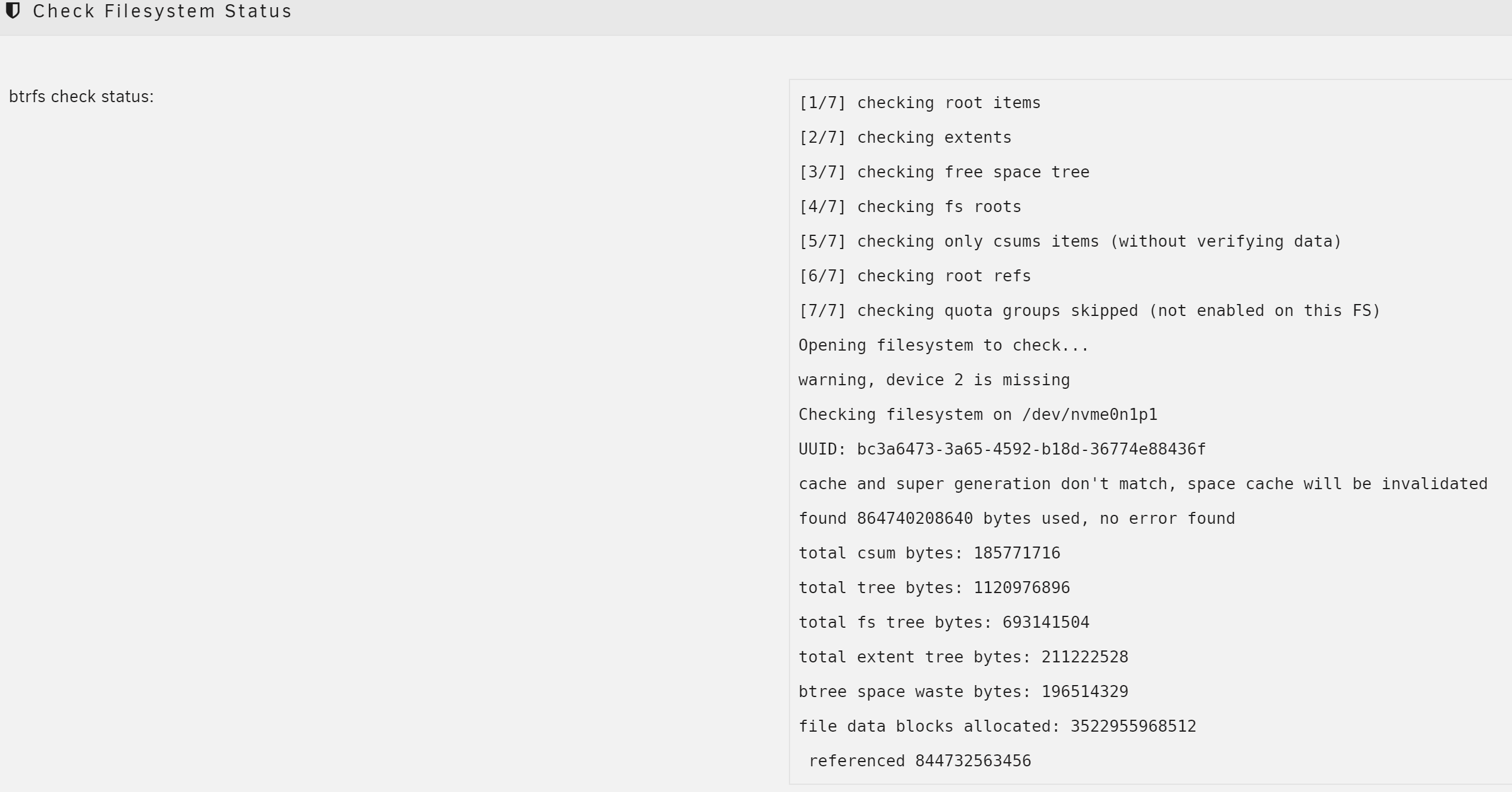

BTRFS check of original drive:
Update: I was running the commands on the drive, rather than the partition. Running the commands on the partition is successful so I am currently restoring the data to my array and then I will attempt to repair it.

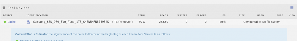

10 hours ago, andeekaii said:
  • Removed second cache drive from the 'pool' (although I guess technically not a pool as it was set to 'Single Device' mode?.
  • Lost access to my cache completely
You can't remove drives from a pool using single profile with the GUI, only manually.
You can try this on the removed drive (ckeck that it's still the correct device):
btrfs-select-super -s 1 /dev/nvme1n1p1
Then reset the pool config in Unraid:
Unassign all cache devices, start array to make Unraid "forget" current cache config, stop array, reassign both cache devices (there can't be an "All existing data on this device will be OVERWRITTEN when array is Started" warning for any cache device), start array and see if it mounts.
Thank you Jorge. I wasn't aware of that but I will certainly remember that in the future.
Luckily I was already able to retrieve all of my data using the 'btrfs restore' command suggested in your FAQ post, so I am very thankful for that.
Something funky was happening with the new cache drive anyway so it's probably a good thing to format the drives and start again anyway.
