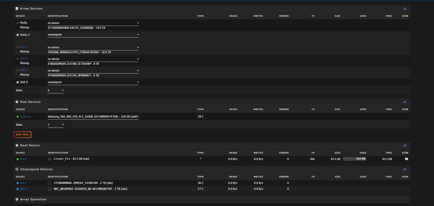

July 8, 20215 yr Author have flashed and verified it but no hdd showed do i have to enable somthing in bios or what
July 8, 20215 yr 3 minutes ago, EduAid said: do i have to enable somthing in bios or what No, you can post the diagnostics so we can check if the HBA is being correctly detected, another common issue for this is using the wrong cables.

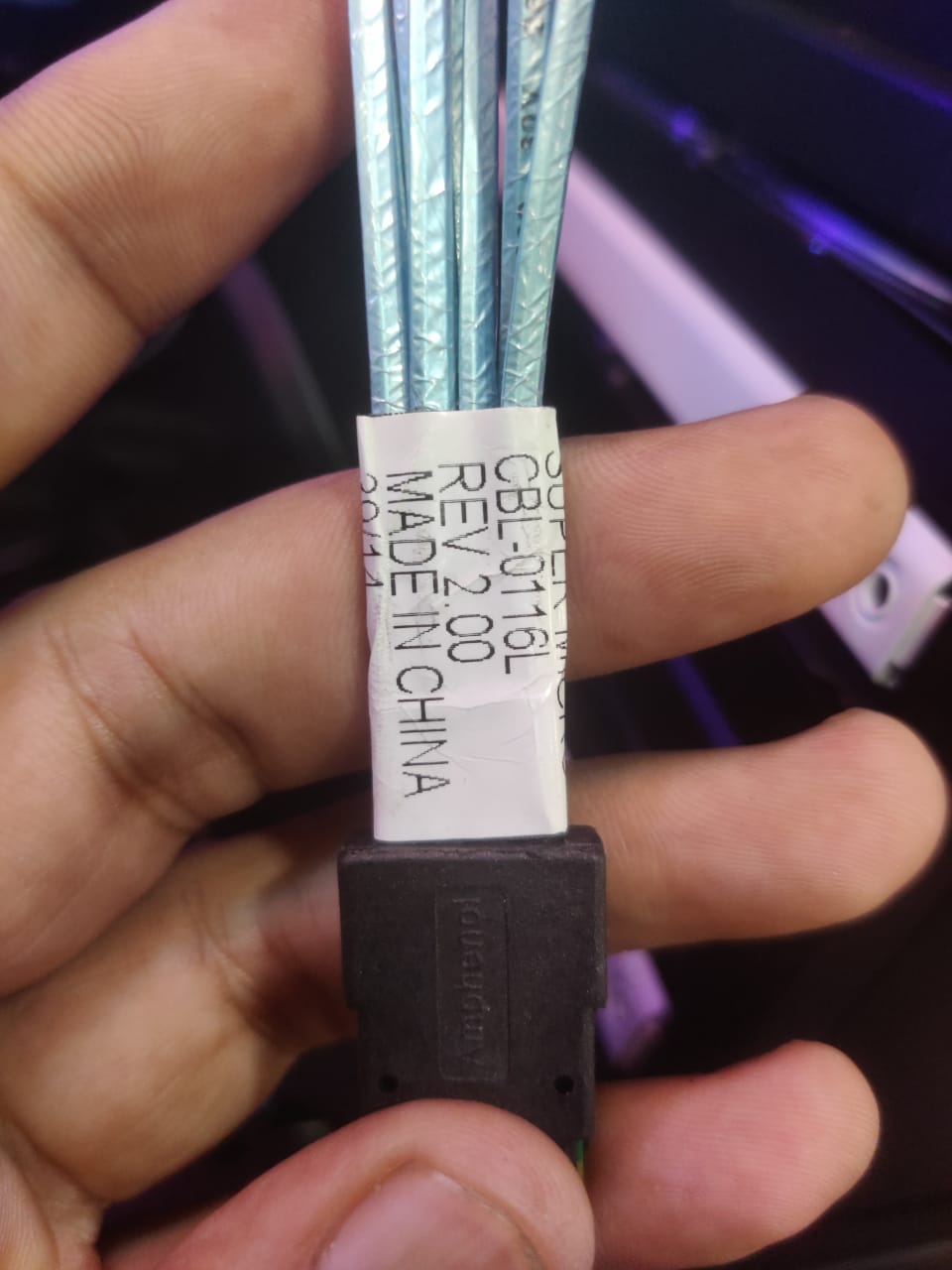

July 8, 20215 yr Author https://store.supermicro.com/supermicro-internal-reverse-breakout-crossover-minisas-to-4-sata-50-50-50-50cm-cable-cbl-0116l.html this is the exact cable i m using
July 8, 20215 yr 1 minute ago, EduAid said: this is the exact cable i m using Those won't work, you need forward breakout.

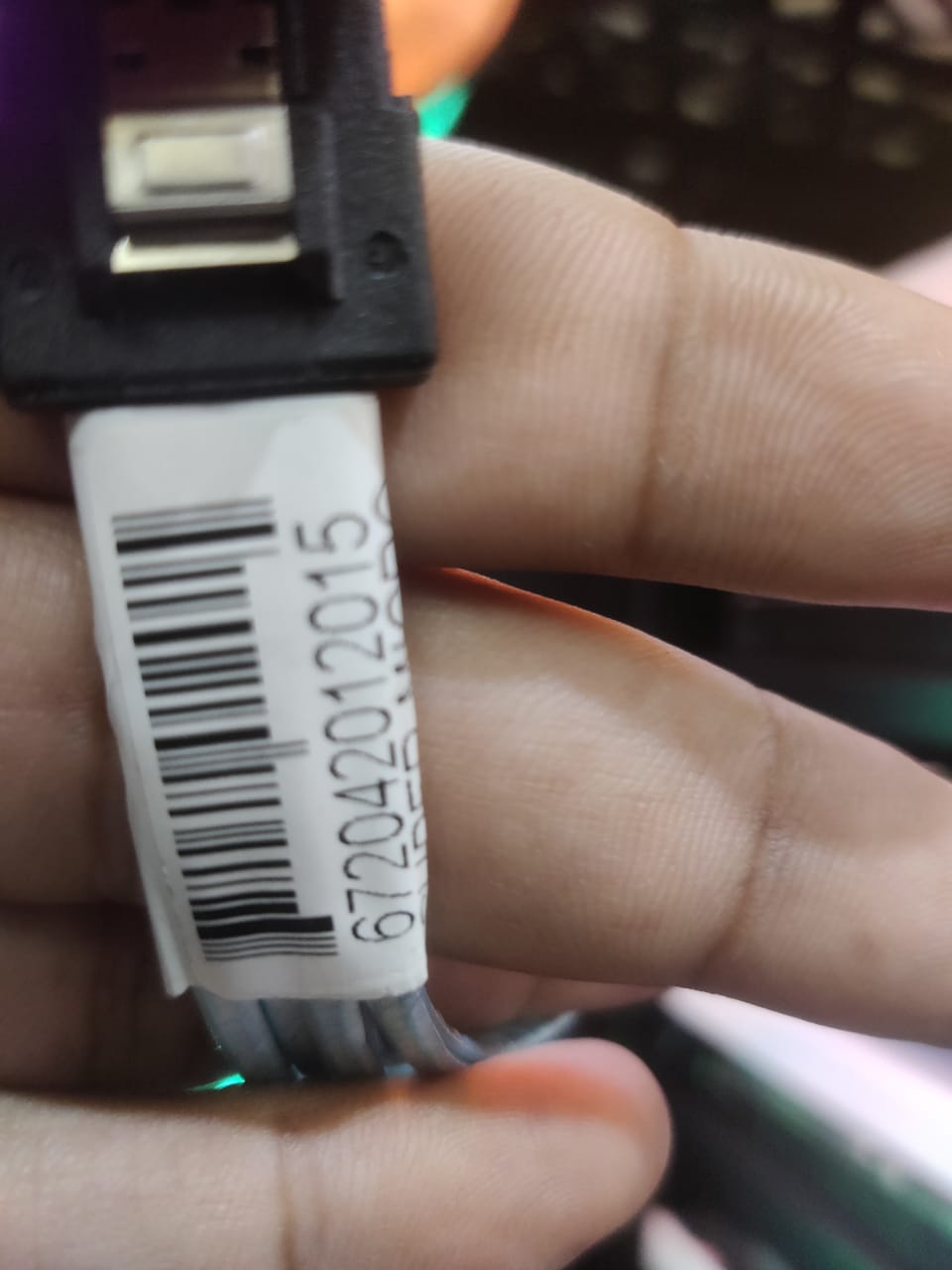

July 8, 20215 yr Author Can u please send me the part number of the cable so that i can be sure that it will work
July 8, 20215 yr For example: https://store.supermicro.com/supermicro-minisas-to-4x-sata-51-51cm-cable-cbl-0097l-03.html?queryID=167cdf8d0cf1db5e79a2daf9b572f9f2&objectID=672&indexName=supermicro_default_products
July 8, 20215 yr Author https://www.amazon.in/dp/B013G4FEGG/ref=cm_sw_r_wa_apa_glt_fabc_RSJMY9J1VPFNNC4HDZZ1?psc=1 Can this connector cable be used
July 8, 20215 yr They should work, they are for SAS devices, which will accept a SATA device, strangely the description mentions they are only for SATA devices, which doesn't make any sense, why use SAS plug for SATA devices?
