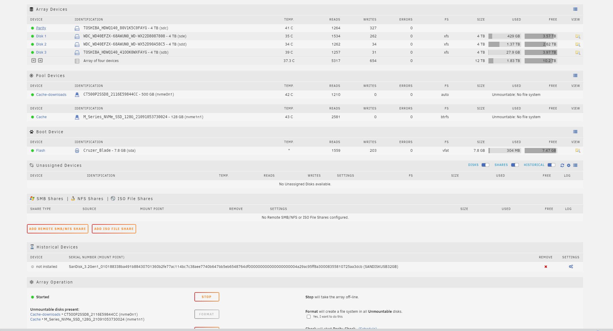

I've been trying to understand the below post but am new to unraid/linux so am struggling to do so.
Please can someone confirm what the exact terminal line entries I should be tryping to recover a unmountable cache pool as seen in the attached screenshot.
To clarify, I was trying to seperate the two cache drives into seperate pools when they were prevously one combined pool.
Edit: I have worked out the correct terminal entry for the BTRFS filecheck however am now getting the following error:
Starting repair.
Opening filesystem to check...
No valid Btrfs found on /dev/nvme1n1
ERROR: cannot open file system
