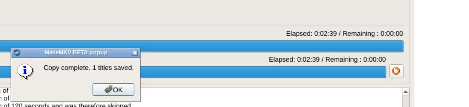

Alright I got my server and did thee testing. Very strange results as the times are identical. It seems to be some kind of limitation. Any ideas?
The hardware shouldn't be a problem as I'm using a Ryzen 5600X with 64GB RAM and two 1GB Seagate IronWolf 530 NVMe SSDs. The file in question was 46gb in size and it took 2:39 minutes, a lot slower than I was expecting.
