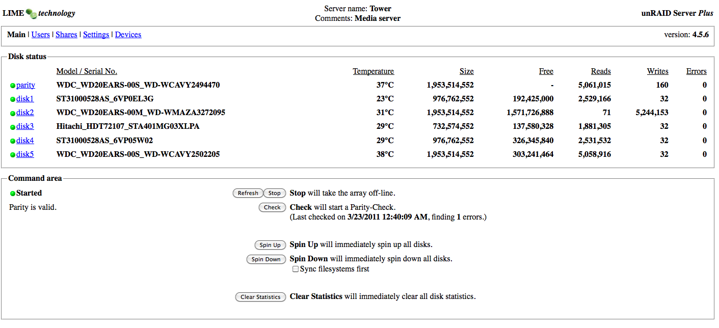

- I did NOT run the "mdcmd check NOCORRECT" command but after the rebuilding I still have the 1 error. What I shoud do now? Normal parity test and forgive?
I have attached the new smartctl report of the disk 2
smartctl_post.txt
Well, it's solved.
After the rebuilding I run a NONCORRECT test and now I don't have any errors. I suppose that the error from the previous post is a bug. The system remembers that there WAS a sync error.

But I have run the test with the NOCORRECT option. The second time has NOT found any errors. I think everything is ok now.
In my opinion the error happened when Unraid rebuilt the disk the first time. I mean:
-Before opening the case, I run a parity check. -> No errors.
-I change the old disk with the new one.
-Unraid rebuilt the data (here there was 1 error because:)
-I run the test with NOCORRECTION option -> It found the error
-I unassigned the disk and precleared it.
-I put again the disk to the system. Unraid rebuilt again the data.
-I run the test with NOCORRECTION option -> It did not found any error.
So, the second rebuilt was done correctly and my data is safe.
p.d: Maybe I have been paranoid, it's just one bit!! (or byte?)
