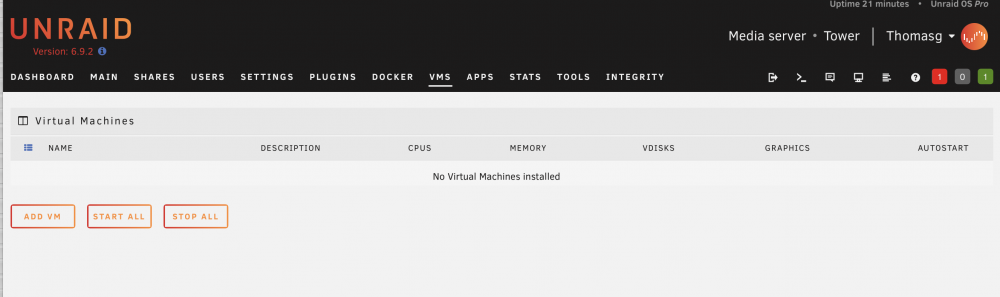

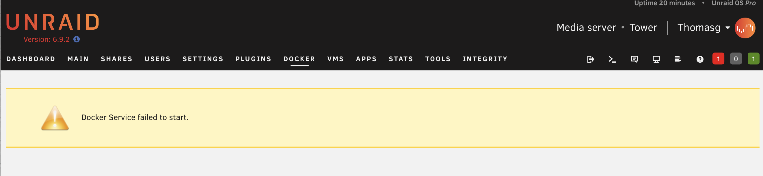

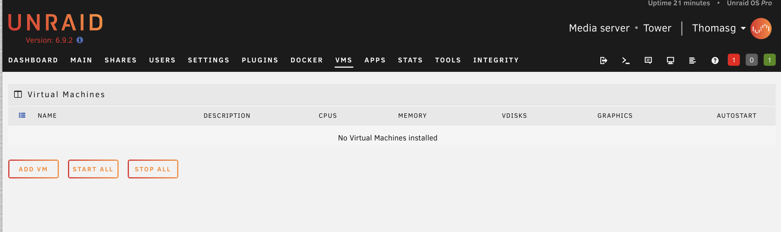

Please help as my unraid is not starting after 2 power failures from the main in a row.
It was running fine and then we had 2 times in a row a power failure to the house and now Docker is not starting and the VMs are not showing.

Docker image is corrupt, delete and re-create, VM service is disable in the diags posted, enable and post new diags if there are still problems.
Thank you! The Docker is running now.

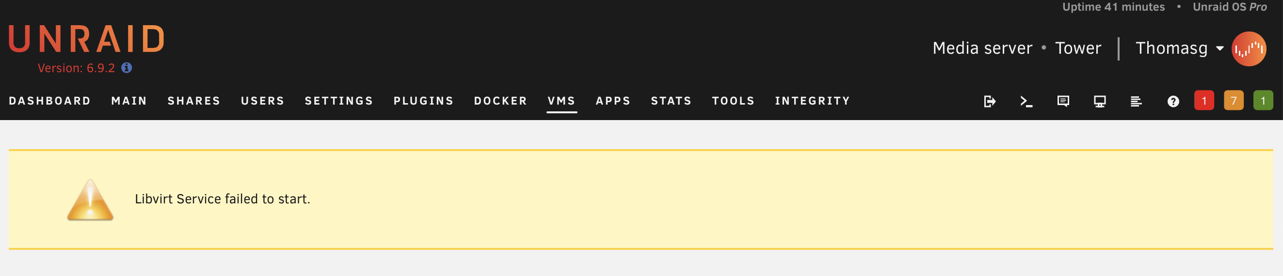

I stopped and started the VM manager under service and now I get this.
Ok... It seems the be getting back together. I stopped the VM manager and update the "Default Windows VirtIO driver ISO (optional)" and now it is starting with the VM's showing up again. Thank God!
