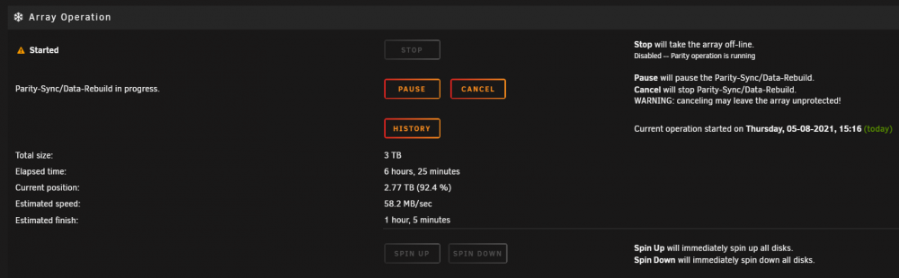

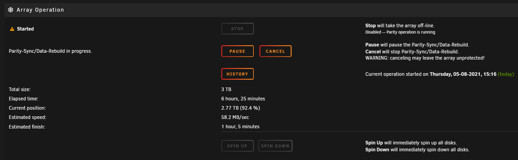

August 5, 20215 yr Author So close. Made it to 92.4% before the server crashed again. Array is currently stopped as I disabled autostart. I don't believe anything has been written to the array since I started this process. I don't have VMs and I stopped and disabled docker right at the start before attempting to swap out the parity drive for the larger one. I've attached the latest diagnostics. Is the next thing to try New Config - Trust Parity and then the parity swap procedure? Thanks. tower-diagnostics-20210805-2214.zip Edited August 5, 20215 yr by outofmysystem
August 6, 20215 yr Community Expert Parity build shouldn't cause crash even if you have a bad disk or disk connection problems. Unfortunately, syslog resets on reboot, so those diagnostics don't show if there was anything causing problems during parity build. Have you eliminated connection to Marvell? Do you have backups of anything important and irreplaceable? 9 hours ago, trurl said: Check connections, run an extended SMART test on that disk (will take several hours), and post new diagnostics.

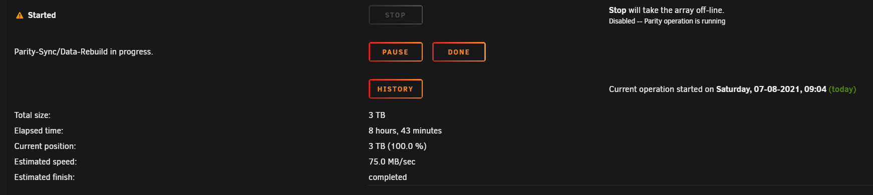

August 7, 20215 yr Author So, I've changed out all of the SATA cables and reseated everything. All 6 HDDs are online with the parity drive showing as emulated. A Parity-Sync/Data-Rebuild operation is running at the moment but it'll likely fail like the rest. I've dug out an old server that only has 6 SATA ports so I've got no way to add all 6, plus the SSD cache drive. I can order a PCI Express (PCIe) SATA III (6G) SSD Adapter but that will take a while to arrive. Annoyingly, I just found 2 x 3TB Reds in the old server I forgot I had so could have done a straight swap for the dodgy disk. Quote Another possibility would be to unassign parity, start the array, and then try to copy whatever you can from the problem disk. Then work on getting parity build without that disk. I think it's possible to get the data off the faulty disk 2. Would using unBalance to scatter the data from it be an option or should I just bite the bullet and rsync all it's contents to another server on my network?
August 7, 20215 yr Community Expert unBALANCE would be one way to do that, but not sure how well it would do unless the issues you are having with building parity are resolved. I was thinking more of copying to an Unassigned Device, or possibly removing parity if it can't be rebuilt and trying to copy to another disk in the array. Might be simpler and safer to put the disk in another computer that can read Linux filesystems to do the copy and so sidestep the issues you are currently having with your server.
August 7, 20215 yr Author Well, that last parity rebuild finished successfully. I guess I'll go and check a few things that live on Drive 2 and see if they look intact. This morning I took out all of the SATA cables and replaced them with ones I had and actually slotted 4 of them into the Marvell SATA ports (I know!). So either one of the SATA cables is dodgy or one of the SATA ports on the board. This morning I ordered an LSI SAS 9207-8i and cables which will arrive next week which should remove either the ports or the SATA cables from the equation. Seeing as Disk 2 passed an extended SMART test, I'm wondering if the reads errors were down to the ports/cables, but don't know enough to make that call. I'm hoping I'm out of the woods now but thank you SO much for your help and patience with this. Coming back to the thread over multiple days is very much appreciated. Edited August 9, 20215 yr by outofmysystem
