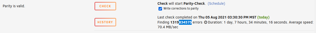

August 5, 20215 yr The last two times I have run a parity check, there are no reads or writes on the parity drive and it ends with over a billion errors. Unraid still says the Parity is valid. Whats the best way to start diagnosing this?
August 6, 20215 yr Community Expert Are you sure you are running a correcting parity check? With that many sync errors, are you sure parity was ever valid, ever built, nothing was done to invalidate it completely such as New Config-Trust Parity when that wasn't appropriate? Post diagnostics, hopefully you haven't rebooted since parity check.

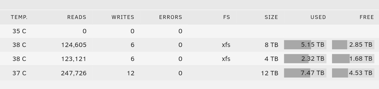

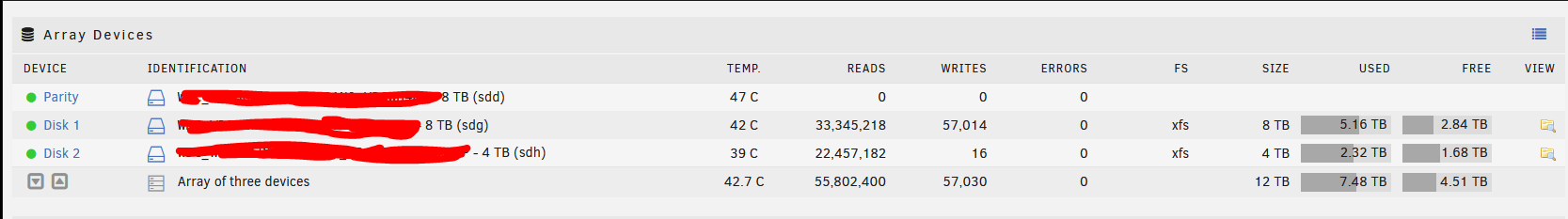

August 6, 20215 yr Author 2 hours ago, trurl said: New Config, Preserve All will keep all disks just as they are and rebuild parity on any disk assigned to a parity slot. I am almost 1% in the rebuild at the writes to the parity are zero. EDIT: Should I zero out the drive with unassigned devices and try again? Edited August 6, 20215 yr by AnnHashaway

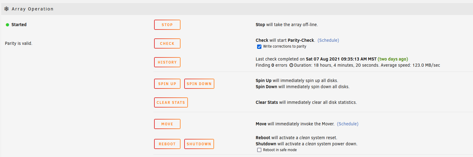

August 8, 20215 yr Community Expert Aug 6 15:30:53 Denali kernel: mdcmd (37): check correct Aug 6 15:30:53 Denali kernel: md: recovery thread: recon P ... ... Aug 7 09:35:13 Denali kernel: md: sync done. time=65060sec Aug 7 09:35:13 Denali kernel: md: recovery thread: exit status: 0 Seems to indicate it completed successfully after 18+ hours which is reasonable for 8TB parity. Post a screenshot of Main - Array Operation
August 9, 20215 yr Author 18 hours ago, trurl said: Aug 6 15:30:53 Denali kernel: mdcmd (37): check correct Aug 6 15:30:53 Denali kernel: md: recovery thread: recon P ... ... Aug 7 09:35:13 Denali kernel: md: sync done. time=65060sec Aug 7 09:35:13 Denali kernel: md: recovery thread: exit status: 0 Seems to indicate it completed successfully after 18+ hours which is reasonable for 8TB parity. Post a screenshot of Main - Array Operation Attached
August 9, 20215 yr Community Expert That first screenshot seems to agree parity successfully checked with no sync errors. Maybe something with your webUI not showing correct numbers for I/O on that disk for some reason. I don't know.
