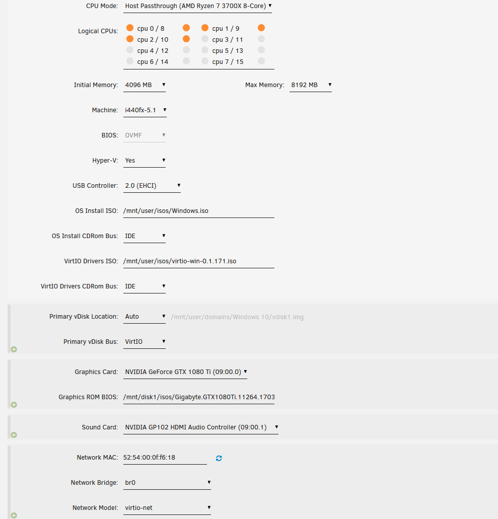

i have been trying to get video output from vm,
my system is for now a test build from left over parts, i want to well cheaply expand , buying a new nas with more drive slots is quite expansive,
my system
amd ryzen 7 3700x
asrock x570 pro4
16 gb ddr4 3600mhz cl 18 corsair vengeance
gigabyte aorus 1080ti
2x nvme sam evo 970 1tb
thing is i tried all 3 bios files i got from https://www.techpowerup.com/vgabios/?architecture=NVIDIA&manufacturer=Gigabyte&model=GTX+1080+Ti&interface=&memType=&memSize=&since=
but none of the 3 works or i do something wrong,
i updated my gpu to the latest driver of gigabyte,
as so as i start the vm the screen blacks out and no visuals, the unraid still works fine from remote,
i posted the vm log in attachments, if you need more info i have to google how to

Dump your own V-BIOS. I never had any luck with hex editing one.
this is the method I use.
however this is a newer method.
I would check you can pass the GPU to a VM as a secondary card as this is easier because you don’t need a v-bios file.
can you RDP into the VM (assuming windows) is the GPU detected in device manager?
Edited by gray squirrel
That is the point , i cant install windows because screen blacks out,
i created vm with gpu passtrough
so remote to windows , is that possbile without it being installed ?
Install windows using VNC graphics first.
Follow this guide.
