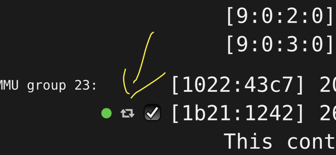

  14. Again good you found a solution but I would advise watching some of spaceinvader one videos on the subject. It is super easy when you know the process. I would personally recommend running your GPU for the VM as a secondary video device first to check it works. Then Dump your own bios using the command line method. This his proven so much more reliable for me. a few of ed’s video on the topic. Some are a little outdated now. However still relevant. dumping your on vbios newer method (didn’t work for my RTX 3080) Advanced GPU passthrough vfio config and binding - now built into unraid
