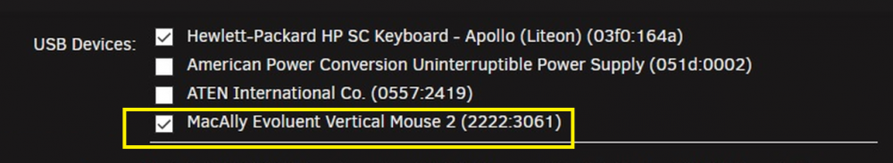

August 11, 20215 yr Hi All, I am using an old Evoluent Vertical 2 mouse in my Windows VM and it's identification number is: 2222:3061 as shown below. I now purchased a new Evoluent Vertical 5 Mouse and I honestly thought changing something as basic as a mouse in my Windows VM was going to be as easy as unplugging the old mouse and plugging in the new one. Nevertheless, UnRaid gives me an error message that reads "Can't find USB device 2222:3061 when I plug in the new Evoluent Vertical 5 Mouse. What is the correct way to perform a Mouse upgrade to my Windows VM so the 2222:3061 ID number changes to the correct new Mouse ID number? I have gone to my Windows 10 VM template and I do not see a place where I could update the Mouse identification number. I hope such a hardware change does not mean I have to reinstall my entire Windows 10 VM all over again from scratch because that would be a lot of work. Any advice will be greatly appreciated. Edited August 11, 20215 yr by slipstream

August 11, 20215 yr The VM editor hides hardware no longer connected, but this is a PITA when you try and remove missing hardware from the config as you found out, the VM will fail to start if configured hardware is not available. You need to go into the XML view and remove that section yourself to clear it, save, then try adding the mouse after.
August 11, 20215 yr Author 12 hours ago, tjb_altf4 said: The VM editor hides hardware no longer connected, but this is a PITA when you try and remove missing hardware from the config as you found out, the VM will fail to start if configured hardware is not available. You need to go into the XML view and remove that section yourself to clear it, save, then try adding the mouse after. Thanks to all for your postings. tjb_alt4 can you please clarify what you mean with PITA? Not familiar with this acronym. I will try what you advise. I'm going to go into the XML for the Windows10 VM and manually remove the 222:3061 then SAVE the change. Then disconnect the Vertical 2 mouse and plugin the Vertical 5 mouse followed by rebooting the Windows10 VM. Hopefully, this will fix my problem. Thanks again.
