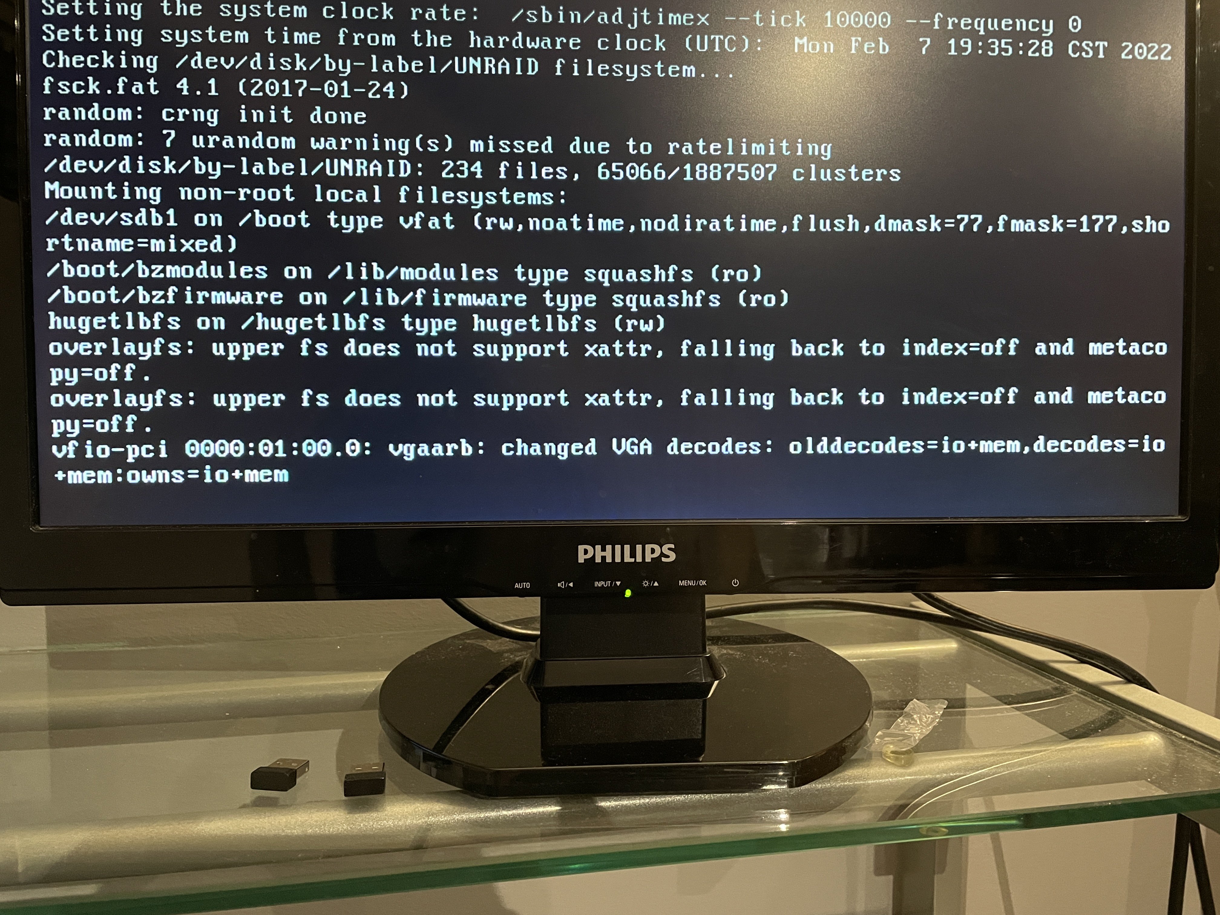

February 8, 20224 yr 9 hours ago, jonp said: Check your BIOS settings and make sure that GPU is enabled and set to act as the primary GPU for your system. If its not, the add-on GPU may get used by the host where problems can then occur with GPU pass through. I’ve done it and it still doesn’t work. To do so, I had to activate UEFI boot otherwise my motherboard wouldn’t let me select the iGpu as first screen. I’ve also disabled the the secondary screen. Something strange though appeared on the boot screen when rebooting Unraid. I don’t know if it has something to do with the issue but just in case… at this point, nothing to loose!!
