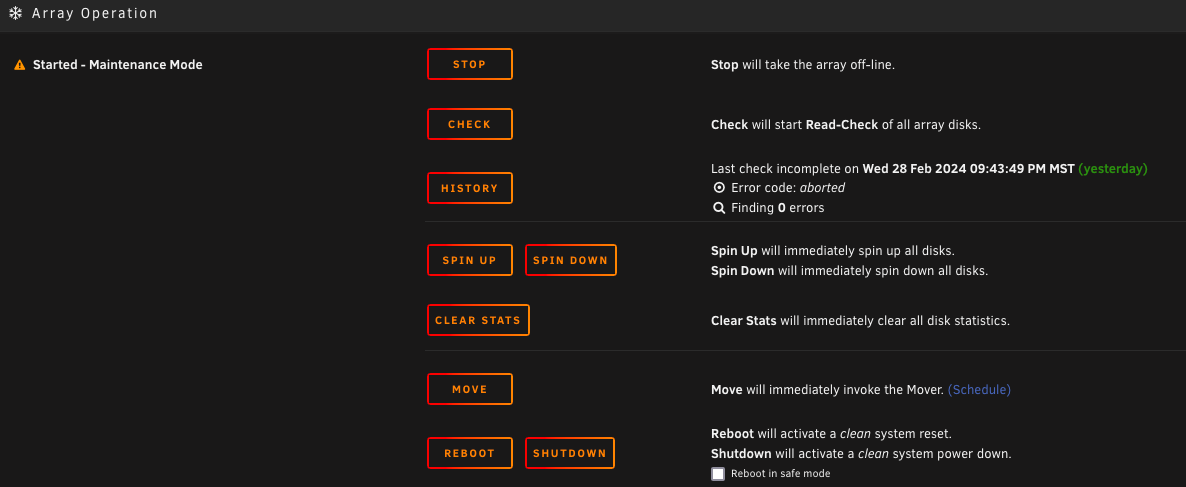

  10. Thank you for the fast reply, I started the in maintenance mode but there is no option to sync, only check. Is the proper way to remove the parity 1, and 2, and after start array, remove, re-add and start the array in maintenance mode to get the sync? -
