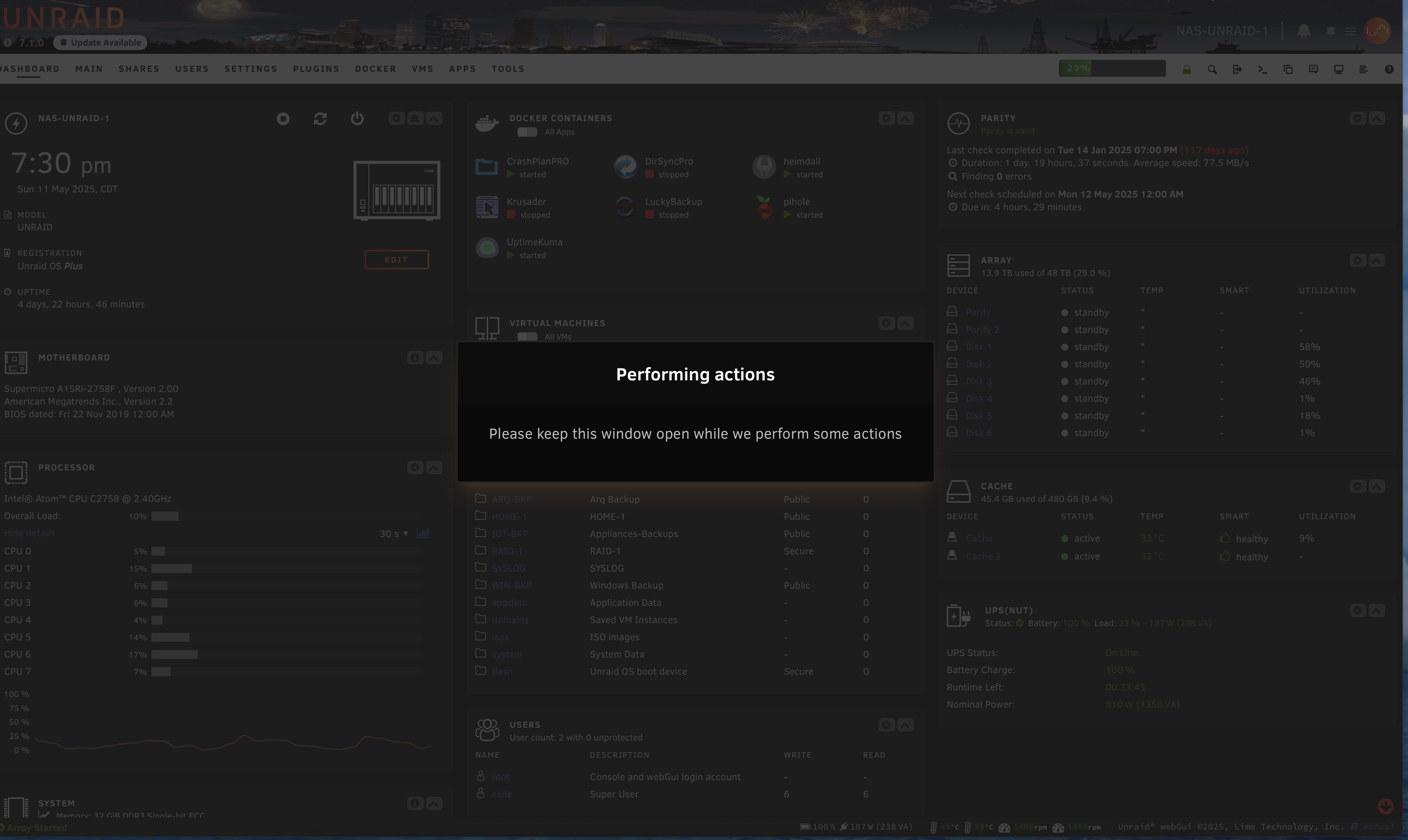

This is all I get, trying to upgrade 2 boxes.  Any idea?

It looks like you have no working DNS.
My DNS if fine. But you may be pointing to something. I need to look at my pi-hole logs and see if the request is getting denied.  It worked perfect up to this point when upgrading the UnRaid boxes?

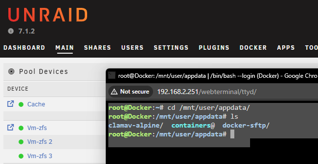

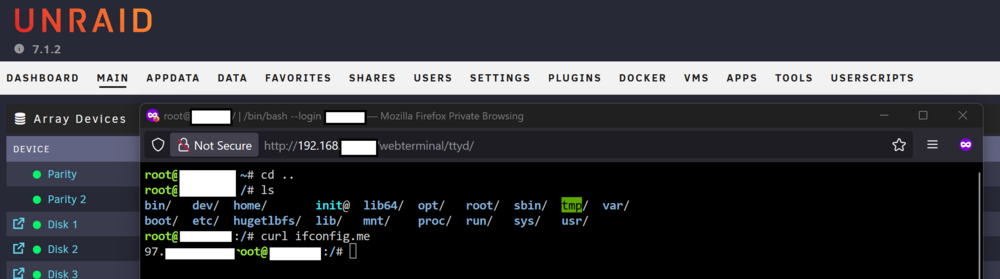

In 7.1.1 and 7.1.2, after typing a command in terminal, it finishes then does not return to a new line. Just at the end of the output.
what command can you give an example?
as i run script and tested this and unless the command is still doing stuff it will not show a new line
what command are you running?

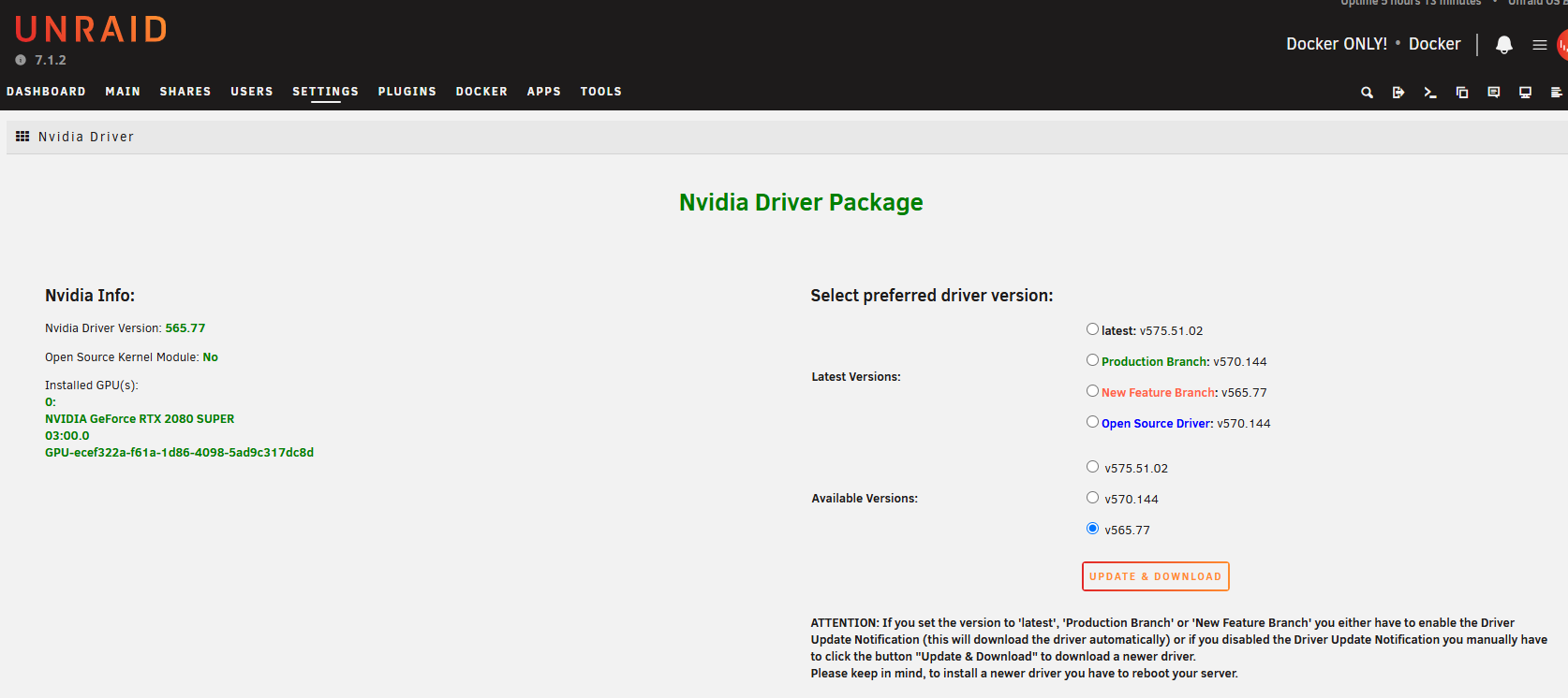

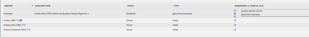

nvidia is a known issue with older hardware as the nvidia plugin will force update you to latte v570 drivers. and will not show older v550 drivers. as NVIDIA killed support for those driver versions...
NVIDIA had some updates when there were kernel change as v7.0,1 is on kernel v6.6 while unraid v7.1 is on kernel version 6.12
also they added novua open source driver that may conflict...
Noted in the release and on ich777 nvdia driver page. Kernel shifts to LTS...
try ich777 oldest known nvida drive v565
make sure nouveau is blacklisted... as you want to use ich777 driver version... not Linux open-source NVIDIA drivers.

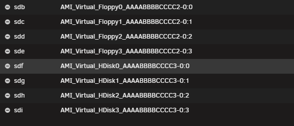

Performed update from 7.0.1 and caught an 'Unknown pci header type '127' for device' error related to a pfsense VM.  Specifically pointing at an intel i226v rev4 dual nic (first port).  Could not resolve quickly and rolled back to 7.0.1 and it came back up.
No interest in troubeshooting this one, more of an fyi.

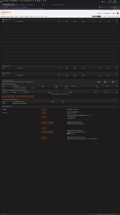

Seems to be a docker network bug? Am changing network type and nothing changes it remains on host. As a test I also set it to none and it remained showing as host. Didn't peak behind the curtain to see what it's doing but here's some screenshots. Anyone else or is it just my server? Maybe it's folder view plugin?
Screenshot context - we have changed the network type to [none] but it shows as [host] could be frontend bug?
Edited by dopeytree
