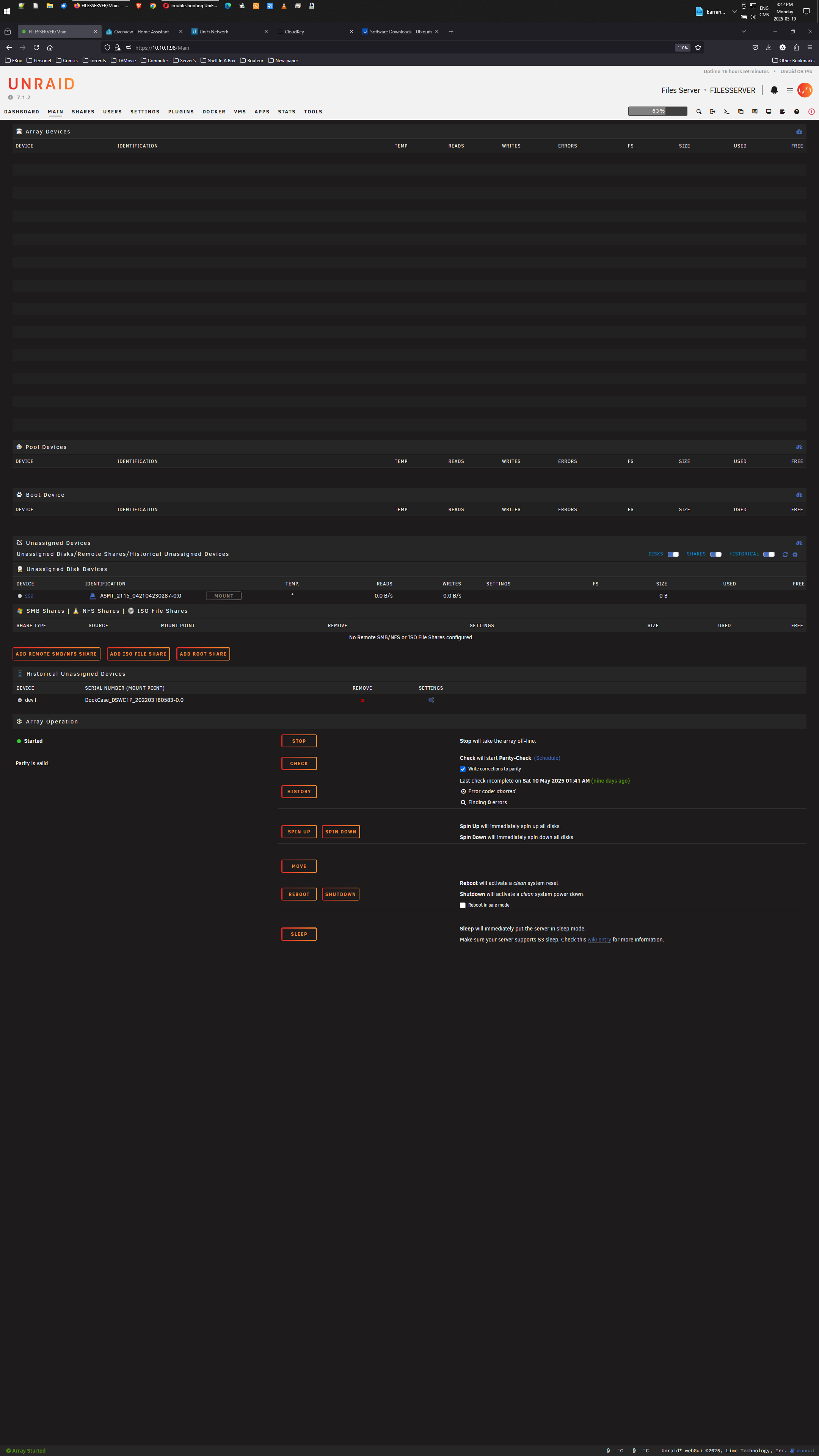

I all, i upgraded my 3 servers and on of them as a problem, i lost all my drive... i need help please, what i did wrong ???
i did revert to the previous upgrade but nothing appeared back.
Have you tried using another browser to access the GUI, or clear the cache of your browser and restart. Just to clear that out.
Edited by MartyMcfly
Yes all five of them, edge, brave, Opera, Firefox and Chrome all the same problem no drive...
and safe mode i see all drive but i can't do anything here so i rebooted in and all is the same no Drive
If it works in safe mode, it suggests a plugin is the problem, you can try to disable them all and re-enable one by one, if you need more help, please start a new thread on the general support forum.

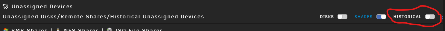

I see this now in my unassigned historical devices list. I'm sure they are safe to remove (?), but don't know why they show up there in the first place. Is this something to do with the update or maybe do I have another issue?
Other than this, update went smooth and all is working as expected so far.
13 hours ago, wirenut said:
upgrade from 7.0.1
This is probably related to Unassigned Devices, not base Unraid.
But you should be able to hide those with a toggle :
