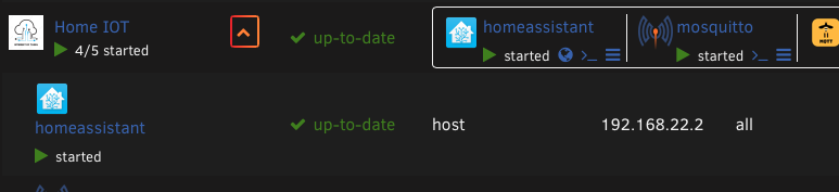

4 hours ago, dopeytree said:
Seems to be a docker network bug?
Is this "really" a bug? And why do you change the Netweork type?
On my Plex-Docker, it says "Host" - i can change it to somethig else, but then plex is no longer working... so it doesnt make sense...

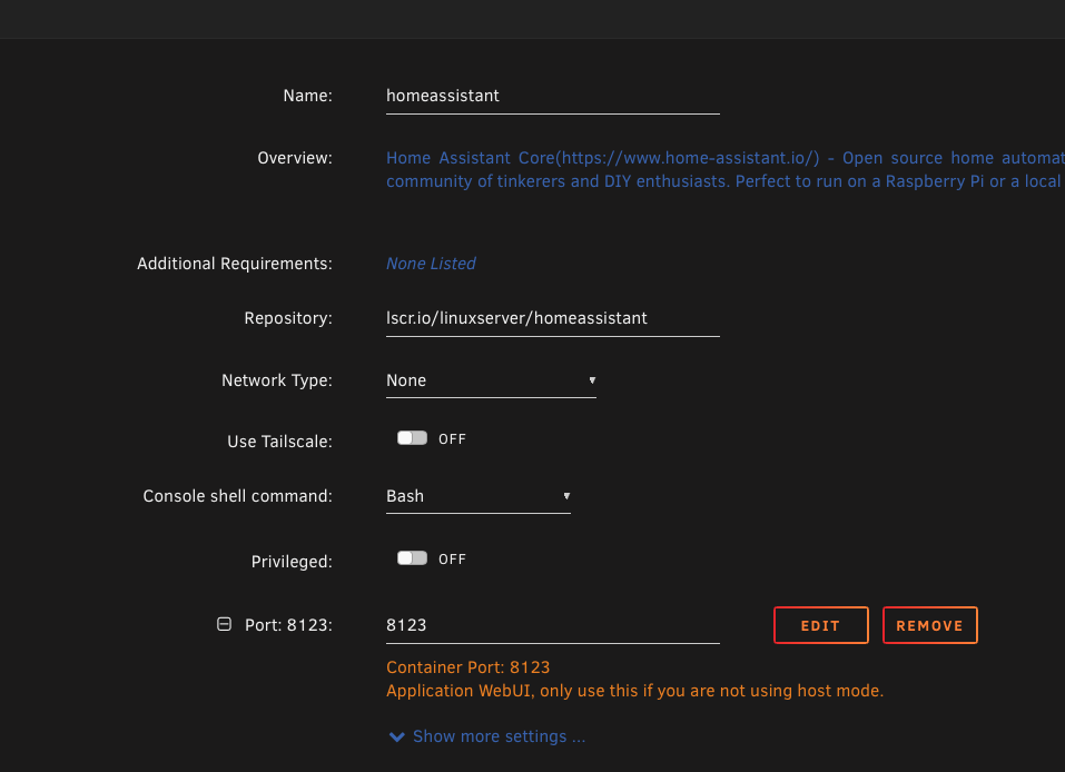

Seems to be a docker network bug? Am changing network type and nothing changes it remains on host. As a test I also set it to none and it remained showing as host. Didn't peak behind the curtain to see what it's doing but here's some screenshots. Anyone else or is it just my server 😂
Screenshot context - we have changed the network type to [none] but it shows as [host] could be frontend bug?
Tried it.  Works fine for me.  Can you retry without folder.view installed.  If that fixes the issue, then post in the plugin's support thread

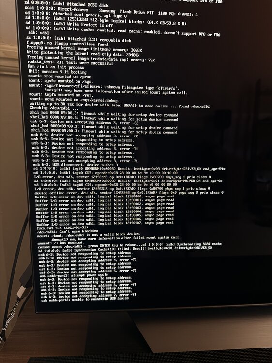

I've been running unraid for over a year, decided to update today from 7.0.1 to 7.1.2, surprised it didn't come back online. So I plugged an HDMI cable to check what was up and noticed it was booting straight into the bios, I changed the USB drive to another port, force reboot and it started booting but to this error. Apologies for being a photo, as I have the server in my living room, never plugged to a monitor. Any idea on what to do here?
Never encountered this before and all updates were a breeze. Until today :D
Looks like a flash drive issue.

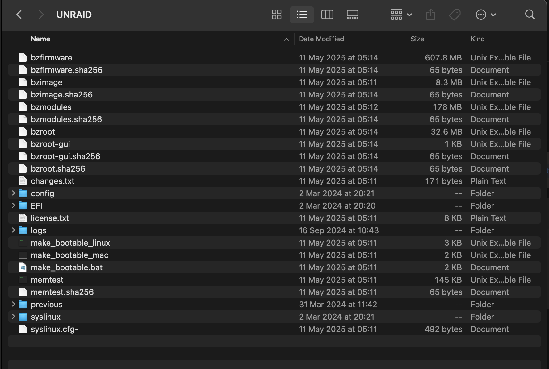

I just plugged it on my mac and everything seems to be there. Don't know what to do now lol, it's been rock solid until this update today

Unfortunately my advice is not going to be very helpful as I do not know exactly what causes this.  It happened to me during a 6.12.x upgrade.  First time I thought it was a bad flash drive and building a replacement resolved the issue.  Then it happened again and when trying a third drive i figured out there was nothing wrong with the first drive I replaced.  I just had this happen again during one of the 7.x upgrades, and all I do now is just change the USB port and it boots without issue.  I thought maybe I had a USB controller going out so I replaced the MOBO and it has happened on that one too.  Needless to say I really have no clue what causes it, but moving to a different port on the MOBO always seems to allow it to boot.  I am still using the first flash drive again too.  Maybe I just have horrible luck with flash drives...idk.

Run the MAC equivalent of Windows'   chkdsk   on the Unraid Flash drive.  I suspect that some sectors on the flash drive may have gotten corrupted when the new files were being written to the drive.
EDIT:  If this does not fix it, start a new thread in the General Support forum.  This thread is for comments not solving problems that take more then one of two posts.

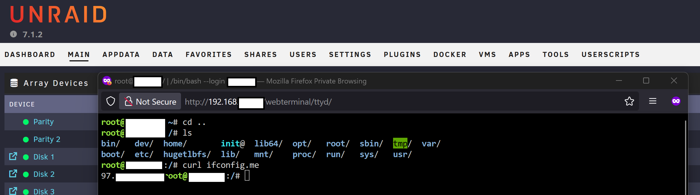

On 5/12/2025 at 4:09 PM, bmartino1 said:
what command can you give an example?
as i run script and tested this and unless the command is still doing stuff it will not show a new line
what command are you running?
Disable Fast Boot in BIOS, should solve this (had the same issue)

curl doesn't print a new line by default. The ls did.
