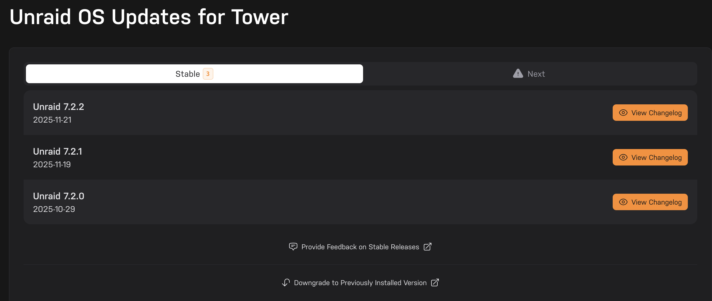

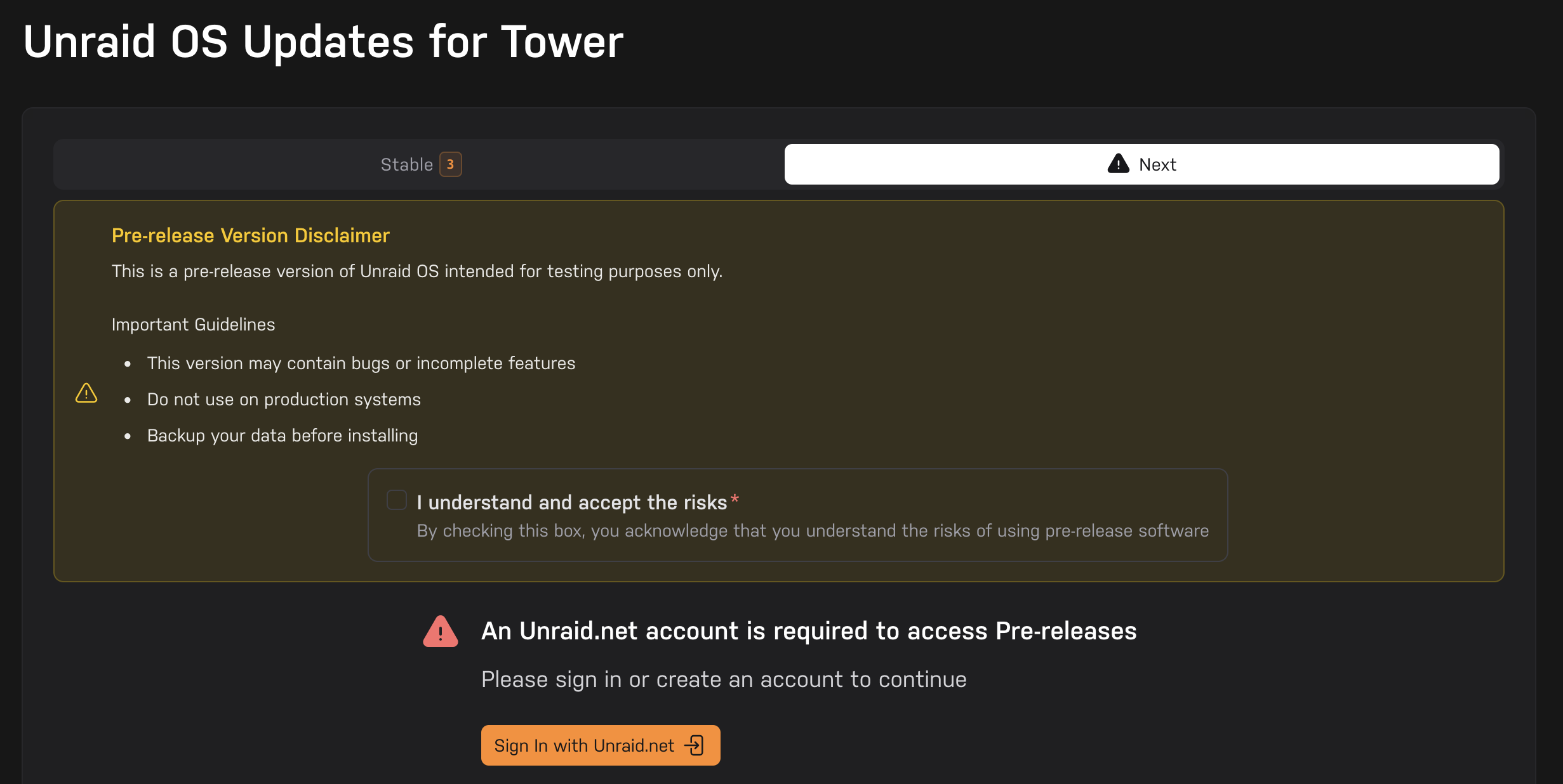

  9. I still see this. Under the Tools tab I select this: I then get this screen: To me this looks like the "Stable" branch is selected. I then click "Next" and get this: Where you can see the Pre-rlease Version Disclaimer. Sorry for my slow response; I've been out of town and unable to take screenshots. Kevin
  10. When I go through the update tool in 7.1.4 although I see 7.2.0 listed under stable releases (dated 29-October-2025), when I try to progress, it presents a warning and disclaimer that this is pre-release. If this is not actually pre-release, will that warning/disclaimer be corrected? Thanks. Kevin
