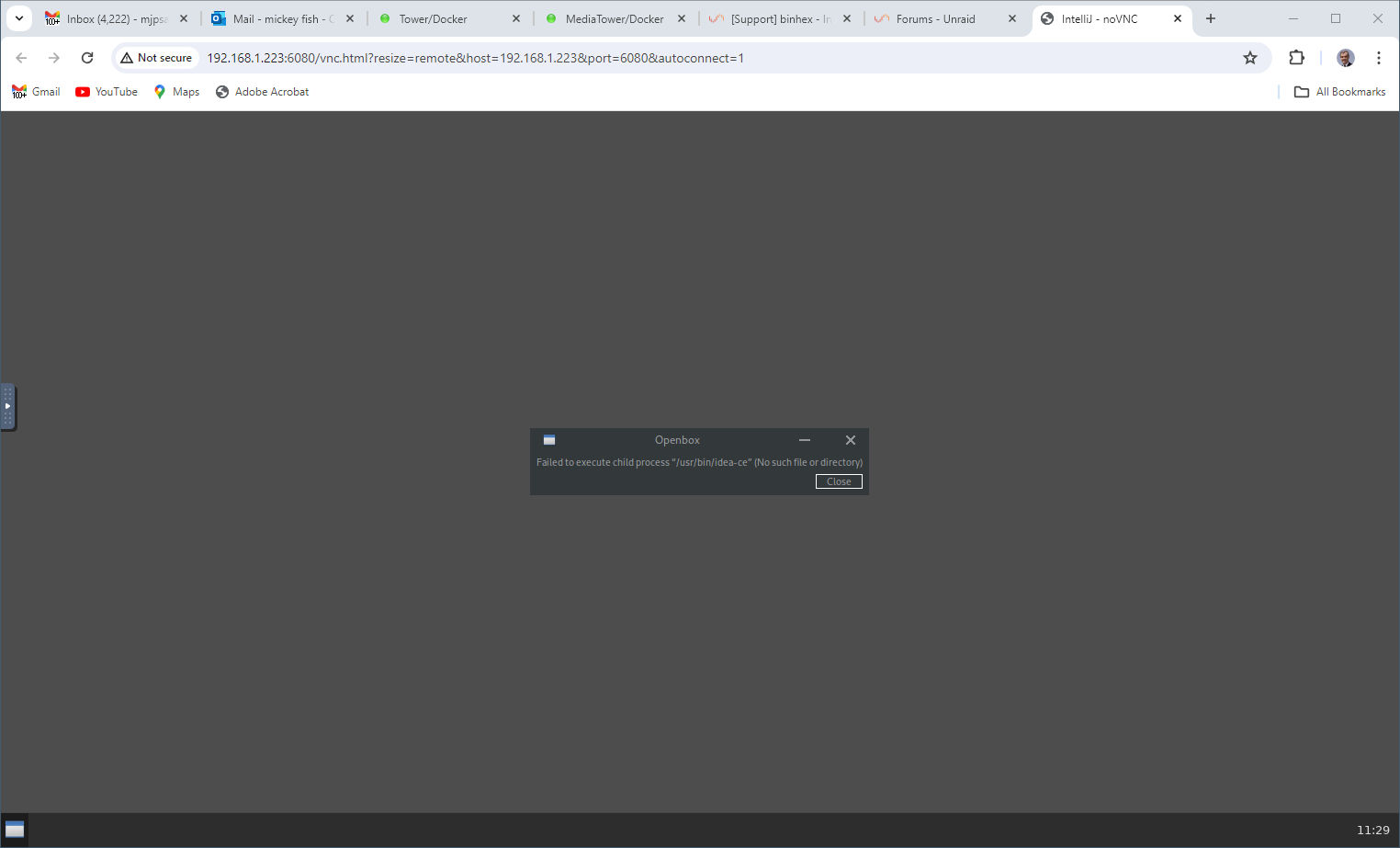

  5. Hi, Upgraded to the latest intellij docker and the GUI won't start. When I right click on the VNC screen and select IntelliJ I see this. There is no file /usr/bin/idea-ce. Any suggestions? Thanks in advance.
