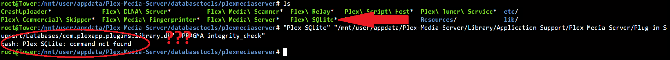

rdawg1234 Posted December 1, 2022 Share Posted December 1, 2022 (edited) I have been following through the video which is far more helpful than most content out there! i got to the step for running the SQL Lite command and it tells me the command is not found. When i type ls it shows up as “SQL\ Lite*” and whether i try and run SQL Lite, SQL Lite*, SQL\ Lite* nothing runs. any suggestions? (Also trying to get support from Plex forums here: https://forums.plex.tv/t/plex-media-server-docker-in-unraid-media-libraries-something-went-wrong/814674/2) Edited December 1, 2022 by rdawg1234 Quote Link to comment

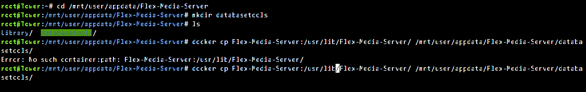

rmp5s Posted December 4, 2022 Author Share Posted December 4, 2022 (edited) Had to start the container, start a terminal INTO the container, go to /usr/lib and find what the Plex directory is called. For me, even though the container is called "Plex-Media-Server", the directory is /plexmediaserver...got it! Now to continue through the vid. 👍 Edited December 4, 2022 by rmp5s Quote Link to comment
rmp5s Posted December 4, 2022 Author Share Posted December 4, 2022 Uuuuuuuuuuuuuuuuuuuuuuuuum... Why can't anything just WORK!? What am I missing here??? Quote Link to comment

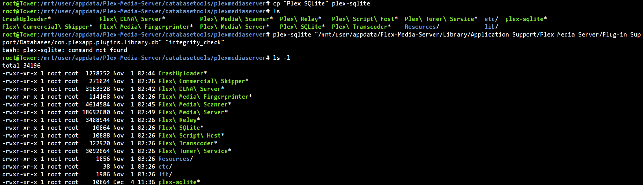

rmp5s Posted December 4, 2022 Author Share Posted December 4, 2022 I thought it may be freaking out because of that escape character so I renamed it to plex-sqlite...still nothing. Thought maybe it didn't have executable permissions...nope. Sure does. I'm at a loss... Quote Link to comment

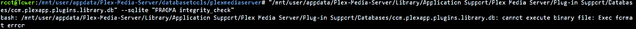

rmp5s Posted December 4, 2022 Author Share Posted December 4, 2022 Running "/mnt/user/appdata/Plex-Media-Server/Library/Application Support/Plex Media Server/Plug-in Support/Databases/com.plexapp.plugins.library.db" --sqlite "PRAGMA integrity_check" as described here, I get: "bash: /mnt/user/appdata/Plex-Media-Server/Library/Application Support/Plex Media Server/Plug-in Support/Databases/com.plexapp.plugins.library.db: Permission denied"...maybe it IS a permissions issue?... Quote Link to comment
rmp5s Posted December 4, 2022 Author Share Posted December 4, 2022 Thought maybe it was saying the permissions of the DB files are the problem so I ran in and gave them a quick 777, ran it again and got this... So. Yea. No idea. I'm lost. Quote Link to comment
Kilrah Posted December 4, 2022 Share Posted December 4, 2022 4 hours ago, rmp5s said: Thought maybe it was saying the permissions of the DB files are the problem so I ran in and gave them a quick 777, ran it again and got this... So. Yea. No idea. I'm lost. You have your quotes such that you're trying to execute the db file, unlike what the post you linked to shows. Quote Link to comment
rmp5s Posted December 5, 2022 Author Share Posted December 5, 2022 42 minutes ago, Kilrah said: You have your quotes such that you're trying to execute the db file, unlike what the post you linked to shows. Yea, I tried it both ways...neither worked. Quote Link to comment

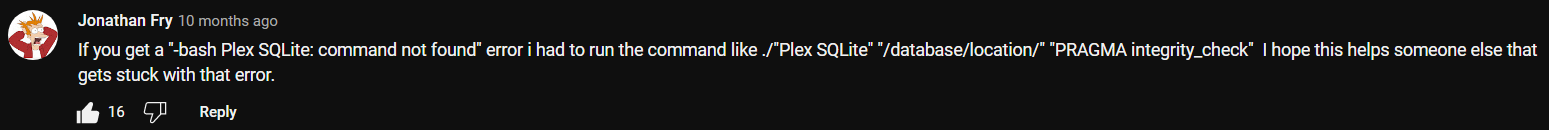

rmp5s Posted December 5, 2022 Author Share Posted December 5, 2022 Literally the very last comment on desktop is literally the very first comment on mobile because...reasons...I guess. The hero we don't deserve...kind of embarrassed I didn't try that, honestly. lol #fail Back in business!...until the next damn thing doesn't work, anyway...🤣 Quote Link to comment
