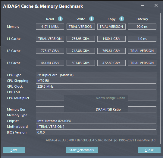

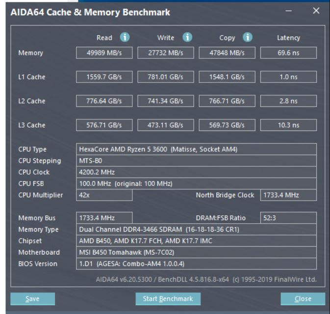

Maximizing Gaming Performance (CPU Bottleneck) - or give up a build a new gaming rig?
Disabling SMT is a bad idea. Very poor multicore performance with no improvement to single core or gaming performance. Unraid also doesn't like this, with very high utilization across the non isolated cores, even with docker service off. I have noticed that assigning more emulator pin's does provide about a 15% uplift in CSGO. However, GPU usage is still very low in COD and F1 2019 (in the 50-70% range) but no CPU core goes over 60% utilization
So I have taken a look at cache and Memory within the VM and compared against results i have found online for a 3600x (effectively what i have passed though the VM). Results in VM Example 3600x - note memory is running at 3466 - im using 3200 RAM. future work, disable SMT to see if that makes a difference? Benchmark one die to create a close representation to my VM,
So after reading some more troubleshooting threads, I have also added the following options. Added iothreads: <vcpu placement='static'>12</vcpu> <iothreads>2</iothreads> <cputune> <vcpupin vcpu='0' cpuset='6'/> <vcpupin vcpu='1' cpuset='18'/> <vcpupin vcpu='2' cpuset='7'/> <vcpupin vcpu='3' cpuset='19'/> <vcpupin vcpu='4' cpuset='8'/> <vcpupin vcpu='5' cpuset='20'/> <vcpupin vcpu='6' cpuset='9'/> <vcpupin vcpu='7' cpuset='21'/> <vcpupin vcpu='8' cpuset='10'/> <vcpupin vcpu='9' cpuset='22'/> <vcpupin vcpu='10' cpuset='11'/> <vcpupin vcpu='11' cpuset='23'/> <emulatorpin cpuset='0,12'/> <iothreadpin iothread='2' cpuset='1,13'/> </cputune> changed the topology to 2 dies to represent the 2 CCX i have passed though to the OS. <cpu mode='host-passthrough' check='none' migratable='on'> <topology sockets='1' dies='2' cores='3' threads='2'/> <cache mode='passthrough'/> <feature policy='require' name='topoext'/> </cpu> No impact to single core performance. I have noticed that my CPU doesn't boost passed 4.2. Even in the single core R15 test. i need to check if it's the same on my BM install. However, i thought a 3900x was good for 4.6GHz single core. It would be useful if anybody else with a 3900x could run the same test and report back frequency. my cooling is more than adequate for this chip. I get the same results with performance / on-demand governor and bosting is enabled. root@Megatron:~# grep MHz /proc/cpuinfo cpu MHz : 3631.139 cpu MHz : 2954.867 cpu MHz : 2688.229 cpu MHz : 2471.153 cpu MHz : 2918.217 cpu MHz : 2566.181 cpu MHz : 2799.979 cpu MHz : 1866.616 cpu MHz : 2176.914 cpu MHz : 2524.751 cpu MHz : 2484.969 cpu MHz : 4196.191 cpu MHz : 3308.898 cpu MHz : 2822.740 cpu MHz : 2706.690 cpu MHz : 2804.207 cpu MHz : 2732.578 cpu MHz : 2215.498 cpu MHz : 2799.974 cpu MHz : 1866.641 cpu MHz : 2264.219 cpu MHz : 2163.178 cpu MHz : 2569.725 cpu MHz : 4216.841 EDIT: a quick BM boot into windows shows cores 4.4Ghz
So, a bit of history. I was planing to move house in the middle of last year and consolidated my Unraid server and my gaming rig into one box. I was shocked the performance was almost identical at the time, so stuck with it when I moved as the convenience was much better, and I was getting more out of my PC. this was with a 3900x and GTX1080. Fast-forward to now, I have an RTX308FE in my box, and it looks like I'm starting to lose an unacceptable amount of performance due to virtualization overhead. This is most noticeable in CPU bound games where the GPU now sits at 60% utilization and I have no performance uplift over my GTX1080. Full system spec: x470 gaming plus max 3900x - 6 cores (one die isolated for VM use) 32GB 3200Mhz Ram 6 - array drives 1TB sabrent NVME - stubbed to VM I have tried a lot of different configs. Most of them have come from this thread: CPU Scaling Governor: On Demand vs Performance = no noticeable difference isolating first 6 cores vs last 6 cores = better performance on last 6 (marginal) Assigned difference combination of cores - same CCX vs cross CCX. Including a 3C6T system I have pined emulation core off / on the isolated thread and now leave it on 0/12. I have benchmarked i440fx vs Q35 with little to no difference. I am still seeing a significant lack in single core performance, but no core is overutilized in game. My benchmark results are: (all ran 3 times) Cinebench R20 Multi - BM = 6912.3 VM = 3393.0 (49.09%) R20 Single - BM = 502.3 VM = 461.0 (91.77%) R15 Multi - BM = 254.4 VM = 1484.7 (48.6%) R15 Single - BM = 201.7 VM = 184.0 (91.24%) 3DMark - Fire strike Extreme Score - BM = 17375.3 VM = 16468.0 (94.78%) Graphics -BM = 18300.7 VM = 18574.3 (101.50%) Physics - BM = 19214.0 VM = 17701.7 (92.13%) Combined - BM = 9005.7 VM = 8430.3 (93.61%) 3DMark - Tiem Spy Score -BM = 14876.0 VM = 13238 (88.99%) Graphics -BM = 16085.7 VM = 16495 (102.54%) CPU -BM = 10432.0 VM = 6248 (59.89%) Mankined Devided - Ultra Preset 1440P Average BM = 74.3 VM = 72.8 (97.9%) RD2 - All ultra 1440P Average BM = 72.7 VM = 67.5 (92.8%) Civ 6 Graphics ultra Av FPS BM - 197.3 VM = 136.0 (68.96%) Tern Time BM = 6.64 VM = 7.14 (93%) F1 2019 Av FPS BM = 170.7 VM = 127.0 (74.41%) - note low GPU usage CSGO Av FPS Benchmark Map BM = 402.1 VM = 306.7 (76.3%) - note low GPU usage Control Average framerate BM = 82.2 VM = 75.8 (92.21%) - MAX GPU usage Warzone Call of Duty not benchmarked, but can happily run the game at 140-160 FPS BM, but around 100 FPS in the VM. my KVM config <?xml version='1.0' encoding='UTF-8'?> <domain type='kvm' id='4'> <name>XXXXXXXXX</name> <uuid>XXXXXXXXX</uuid> <description>Dual Boot WIN 10 VM</description> <metadata> <vmtemplate xmlns="unraid" name="Windows 10" icon="windows.png" os="windows10"/> </metadata> <memory unit='KiB'>16777216</memory> <currentMemory unit='KiB'>16777216</currentMemory> <memoryBacking> <nosharepages/> </memoryBacking> <vcpu placement='static'>12</vcpu> <cputune> <vcpupin vcpu='0' cpuset='6'/> <vcpupin vcpu='1' cpuset='18'/> <vcpupin vcpu='2' cpuset='7'/> <vcpupin vcpu='3' cpuset='19'/> <vcpupin vcpu='4' cpuset='8'/> <vcpupin vcpu='5' cpuset='20'/> <vcpupin vcpu='6' cpuset='9'/> <vcpupin vcpu='7' cpuset='21'/> <vcpupin vcpu='8' cpuset='10'/> <vcpupin vcpu='9' cpuset='22'/> <vcpupin vcpu='10' cpuset='11'/> <vcpupin vcpu='11' cpuset='23'/> <emulatorpin cpuset='0,12'/> </cputune> <resource> <partition>/machine</partition> </resource> <os> <type arch='x86_64' machine='pc-i440fx-5.1'>hvm</type> <loader readonly='yes' type='pflash'>/usr/share/qemu/ovmf-x64/OVMF_CODE-pure-efi.fd</loader> <nvram>/etc/libvirt/qemu/nvram/5f45766e-314f-6714-c52b-7b7a581ab713_VARS-pure-efi.fd</nvram> <boot dev='hd'/> </os> <features> <acpi/> <apic/> <hyperv> <relaxed state='on'/> <vapic state='on'/> <spinlocks state='on' retries='8191'/> <vendor_id state='on' value='none'/> </hyperv> </features> <cpu mode='host-passthrough' check='none' migratable='on'> <topology sockets='1' dies='1' cores='6' threads='2'/> <cache mode='passthrough'/> <feature policy='require' name='topoext'/> </cpu> <clock offset='localtime'> <timer name='hypervclock' present='yes'/> <timer name='hpet' present='no'/> </clock> <on_poweroff>destroy</on_poweroff> <on_reboot>restart</on_reboot> <on_crash>restart</on_crash> <devices> <emulator>/usr/local/sbin/qemu</emulator> <controller type='usb' index='0' model='ich9-ehci1'> <alias name='usb'/> <address type='pci' domain='0x0000' bus='0x00' slot='0x07' function='0x7'/> </controller> <controller type='usb' index='0' model='ich9-uhci1'> <alias name='usb'/> <master startport='0'/> <address type='pci' domain='0x0000' bus='0x00' slot='0x07' function='0x0' multifunction='on'/> </controller> <controller type='usb' index='0' model='ich9-uhci2'> <alias name='usb'/> <master startport='2'/> <address type='pci' domain='0x0000' bus='0x00' slot='0x07' function='0x1'/> </controller> <controller type='usb' index='0' model='ich9-uhci3'> <alias name='usb'/> <master startport='4'/> <address type='pci' domain='0x0000' bus='0x00' slot='0x07' function='0x2'/> </controller> <controller type='pci' index='0' model='pci-root'> <alias name='pci.0'/> </controller> <controller type='virtio-serial' index='0'> <alias name='virtio-serial0'/> <address type='pci' domain='0x0000' bus='0x00' slot='0x03' function='0x0'/> </controller> <interface type='bridge'> <mac address='52:54:00:1e:9d:c0'/> <source bridge='br0'/> <target dev='vnet0'/> <model type='virtio'/> <alias name='net0'/> <address type='pci' domain='0x0000' bus='0x00' slot='0x02' function='0x0'/> </interface> <serial type='pty'> <source path='/dev/pts/0'/> <target type='isa-serial' port='0'> <model name='isa-serial'/> </target> <alias name='serial0'/> </serial> <console type='pty' tty='/dev/pts/0'> <source path='/dev/pts/0'/> <target type='serial' port='0'/> <alias name='serial0'/> </console> <channel type='unix'> <source mode='bind' path='/var/lib/libvirt/qemu/channel/target/domain-4-Sideswipe/org.qemu.guest_agent.0'/> <target type='virtio' name='org.qemu.guest_agent.0' state='disconnected'/> <alias name='channel0'/> <address type='virtio-serial' controller='0' bus='0' port='1'/> </channel> <input type='mouse' bus='ps2'> <alias name='input0'/> </input> <input type='keyboard' bus='ps2'> <alias name='input1'/> </input> <hostdev mode='subsystem' type='pci' managed='yes'> <driver name='vfio'/> <source> <address domain='0x0000' bus='0x27' slot='0x00' function='0x0'/> </source> <alias name='hostdev0'/> <rom file='/mnt/user/domains/vbios/RTX3080FE.rom'/> <address type='pci' domain='0x0000' bus='0x00' slot='0x04' function='0x0'/> </hostdev> <hostdev mode='subsystem' type='pci' managed='yes'> <driver name='vfio'/> <source> <address domain='0x0000' bus='0x27' slot='0x00' function='0x1'/> </source> <alias name='hostdev1'/> <address type='pci' domain='0x0000' bus='0x00' slot='0x05' function='0x0'/> </hostdev> <hostdev mode='subsystem' type='pci' managed='yes'> <driver name='vfio'/> <source> <address domain='0x0000' bus='0x01' slot='0x00' function='0x0'/> </source> <alias name='hostdev2'/> <address type='pci' domain='0x0000' bus='0x00' slot='0x06' function='0x0'/> </hostdev> <hostdev mode='subsystem' type='pci' managed='yes'> <driver name='vfio'/> <source> <address domain='0x0000' bus='0x26' slot='0x00' function='0x0'/> </source> <alias name='hostdev3'/> <address type='pci' domain='0x0000' bus='0x00' slot='0x08' function='0x0'/> </hostdev> <memballoon model='none'/> </devices> <seclabel type='dynamic' model='dac' relabel='yes'> <label>+0:+100</label> <imagelabel>+0:+100</imagelabel> </seclabel> </domain> Any pointers in how to librate a bit more CPU performance?
