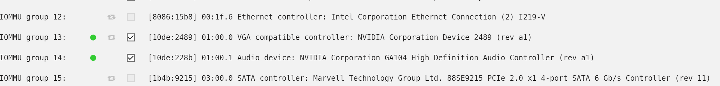

August 8, 20215 yr Hi community, I beg your help, because I'm not able to understand where is the problem. Just bought a nvidia 3060TI, installed. Connected the HDMI cable to my monitor. I know that is works, because I can see all the bootup process running on the screen. But whn I go to "System devices" I can't see my brand new card. I just saw an anonymous : " 01:00.0 VGA compatible controller: NVIDIA Corporation Device 2489 (rev a1) " but not the name of the new card. Tried to install the nvidia plugin but still I don't see any clear indication of the new card but I got this message : "NVIDIA-SMI has failed because it couldn't communicate with the NVIDIA driver. Make sure that the latest NVIDIA driver is installed and running. " Tried to install either the latest version and the production one's and refreshed every tim. About this I understood that nvidia plugin it doesn't wok for Vm, therefore I removed the plugin. At any change I rebooted the server. In the " settings " I put into the " PCIe ACS override" : " both " as option, no results and still not able to passthorugh my GPU in the VM. I have a Apple VM installed, tried to set the nvidia card wjth the one mentioned ( 01:00.0 VGA compatible controller: NVIDIA Corporation Device 2489 (rev a1) ) update the settings with the no warnings, but when I start the VM, the screen is still blank. Is there someone that is able to give me some indicatiions ? Should I hve to install the ROM file ? ( I didn't in this case, because I saw on youtube some tutorial where they didn't do and were able to passthorugh in any case ) In case should i leave the extension as *.rom or should I rename it ? In case the file has to be in the same folder where I keep the ISO's ? btw : I'm newbie on unraid, therefore all the suggetions are more than welcome THX really appreciate your support
August 11, 20215 yr On 8/8/2021 at 4:56 PM, cristiano1492 said: Just bought a nvidia 3060TI, installed. Connected the HDMI cable to my monitor. I know that is works, because I can see all the bootup process running on the screen. But whn I go to "System devices" I can't see my brand new card. I just saw an anonymous : " 01:00.0 VGA compatible controller: NVIDIA Corporation Device 2489 (rev a1) " but not the name of the new card. Are you speaking about a windows vm? Make sure that in the vm xml video and audio are on the same bus, same slot and different function (multifunction device), and install latest nvidia drivers. On 8/8/2021 at 4:56 PM, cristiano1492 said: I have a Apple VM installed, tried to set the nvidia card wjth the one mentioned ( 01:00.0 VGA compatible controller: NVIDIA Corporation Device 2489 (rev a1) ) update the settings with the no warnings, but when I start the VM, the screen is still blank. Bad choice for an apple vm, no apple os is compatible with a 3060ti, no driver available, it's a no go. Edited August 11, 20215 yr by ghost82
August 13, 20215 yr Author Hi Ghost82, first, thanks for your answer and suggestions. - Ok, for Apple, I won't use the 3060.... got it ? Any other card could work ? perhaps a little bit older ? like a GTX 760 ? - Yes, I'm speaking about a Win WM. you see the two parts of the card are in group different, and this should be the best option, according to the several tutorial I saw ( is it correct ? ) - How can I install drivers ? Do you mean to put in the VM configuration the ROM file of the card ? is that you meant ? If yes, can I leave extension as ROM file or should I rename somehow ( as I saw in a Spaceinvaders tutorials on VM ) ? THx a lot for helping me

October 8, 20215 yr I just had a similar issue and thought I would post here for anyone else that encounters similar behaviour with black screen (or no output) from the GPU where everything else looks like it should work. My Nvidia 3060ti also got detected as an "NVIDIA Corporation Device 2489" but this is not an indicator of any problem in itself. Some Nvidia GPUs do get detected as strange names, especially the newer RTX 30XX series. Symptoms I got: VM when started with GPU passed though correctly in terms of config on unraid, goes green in the UI and everything looks as though it would work fine. But no output occurs to a monitor on HDMI or Display port. When used with pure VNC as graphics card it functions fine. When the server boots a display output can be seen during post and BIOS so you know it works normally. What I changed which caused this issue to occur: Upgraded the GPU in my system from an Nvidia 3060 to an Nvidia 3060ti Actual issue: Nvidia drivers in windows VM itself. I believe that because I did not unintall the old nvidia driver before I did the upgrade, Windows kept trying to use the existing driver to work with the card. The problem I think, was that the driver I had installed was a specific one which only works with non LHR 3060 cards as this was the leaked dev driver which unlocks 3060s so they can be mined with. I should have uninstalled this driver first whilst the card was in the server still and whilst inside the VM and used a generic windows auto one, or just installed the latest nvidia drivers first for the 3060. They would probably be similar enough to the 3060ti that it may have initiated it and worked. I don't think you can simply use VNC connection to go in and remove the driver because then the GPU is not listed in device manager to be able to uninstalled if you see what I mean. Although... How you might be able to fix it: A. It may be possible to use something like DDU free software to force to remove all references of the nvidia drivers. Then it may be possible to start the VM with GPU passed through and it may become auto detected and initiated with a basic found driver by Windows. B. Create a new VM from scratch would probably solve the issue and initiate the GPU fresh. How I fixed it: In my case since I already had the new GPU installed in the server and didn't want to put the old one back in or try either of the above two things yet, I decided to: (If remote desktop is already possible on your VM then skip to step 6) 1. Configure the VM to only use VNC as GPU. 2. Start the VM in unraid GUI 3. Using VNC, access the VM and go to remote desktop settings inside windows. Ensure remote desktop connections are allowed and that you can connect with a valid user. 4. Exit remote desktop and VNC. 5. Stop/shutdown the VM from unraid GUI 6. Configure the VM to now use the GPU passed through as per other instructions in various other threads/youtube videos (out of scope for this explanation as too long) 7. Start the VM form the unraid GUI 8. Remote desktop into the VM 9. In device manager you should now see the nvidia GPU as a device which can be right clicked and then uninstalled. This should remove the problematic and non functional/compatible nvidia driver which is not able to work with the currently installed and passed through GPU. In this case my new 3060ti is the GPU existing, and the driver uninstalled was the old 3060 dev mining driver. 10. Go to nvidia website and download and install the latest driver for your GPU as you normally would. I would recommend with nvidia that you select "CUSTOM" install and then do a "CLEAN" install to properly clear out any remains of older drivers. The VM will reboot to complete installation. Just remote desktop back in once done to verify it completes and exit installation. 11. Disconnect remote desktop and test direct GPU connectivity to a monitor now. You should find you have output as normal on your screen.
