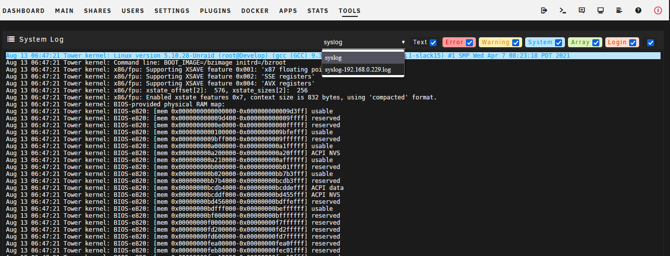

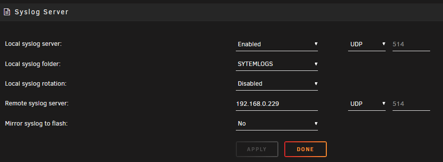

August 13, 20215 yr Author 33 minutes ago, trurl said: syslog in Diagnostics is the one in RAM so nothing in it from before reboot. This is exactly the situation where we need syslog from Syslog Server attached separately from Diagnostics. More here: I'm a bit confused as the one i provided was from a share on the system thats crashing. That'd the log you would want in this case correct? taken from the troubleshooting page> Persistent Logs (Syslog server) Logging to file local to Unraid server Using a bit of trickery we can use the Unraid server with the problem as the Local syslog server. Edited August 13, 20215 yr by XceRpt
August 13, 20215 yr Author I may have things backwards I'm honestly pretty new at this. But theres also this "syslog' if thats the one you're referring to. Edited August 13, 20215 yr by XceRpt
August 13, 20215 yr Community Expert 3 hours ago, XceRpt said: I'm a bit confused My point was that you had correctly given us a syslog from before crash. In addition to the syslog already in Diagnostics which is only since reboot. Many people don't know about Syslog Server or what is in Diagnostics. So they give us Diagnostics, plus also another attachment that is simply the syslog already in the Diagnostics they attached. Another thing they often attach is SMART report from one or more disks, but Diagnostics already includes SMART report for all attached disks. Diagnostics also includes a lot of information about your hardware and configuration. Take a look at it, all but one file in the zip is plaintext. Some of the files are just copies of configuration files from settings you make in the webUI.

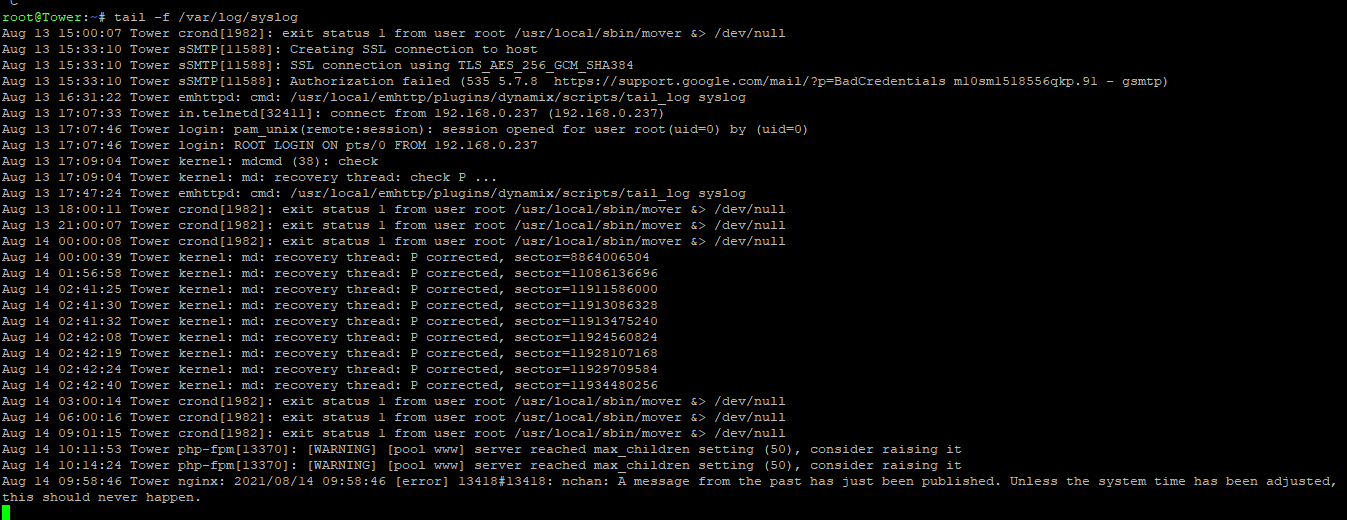

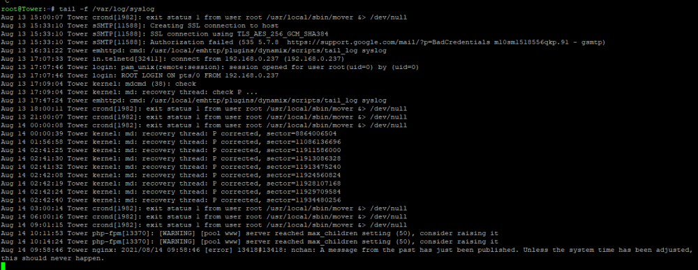

August 14, 20215 yr Author through putty i've tried tailing the log but still not seeing what's causing the issue/crash. Whats weird is right now it's like the parity is stuck but "most" the webui tabs are accessible though nothing works. Edited August 14, 20215 yr by XceRpt
