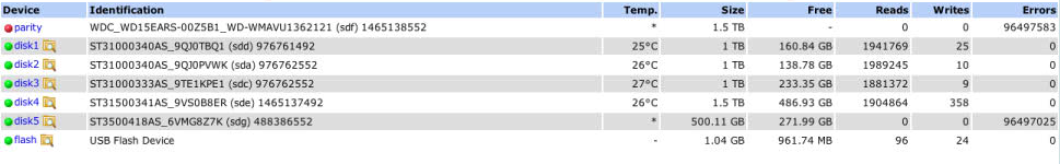

Running 5 beta 5b. Just put in a 500Gb drive, has been running in another computer with no issues. It attached itself to the array without any issues. I ran parity check after this and didn't experience any issues. Used it as a TimeMachine backup drive for a few weeks, just ran another Parity check and it came up with a top of errors. Syslog is 2Gb. Here's a screenshot, and slice of the issues below:
Mar 23 11:57:17 Media kernel: md: disk0 read error
Mar 23 11:57:17 Media kernel: handle_stripe read error: 308000192/0, count: 1
Mar 23 11:57:17 Media kernel: md: disk5 read error
Mar 23 11:57:17 Media kernel: handle_stripe read error: 308000192/5, count: 1
Mar 23 11:57:17 Media kernel: handle_stripe read error: 308000200/0, count: 1
Mar 23 11:57:17 Media kernel: handle_stripe read error: 308000200/5, count: 1
It seems your parity has gone offline. I would check the cables on both and pull SMART reports on both. The parity red-ball will not fix itself. You will have to get that drive back on-line or a new one in there and then re-build parity. You can start the array with that one unassigned and then it will be considered new when you assign it again.

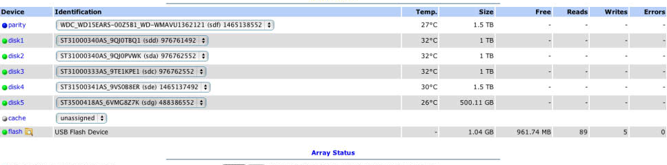

Yeah just checking it from work, restarted and it showed the setup below. Basically said I've plugged in a new parity drive. Size and serial look the same, and Beta 5 doesn't have the slots issues beta 6 has? First thing to check cables as you said, then I'll figure out what to do from SMART reports.
