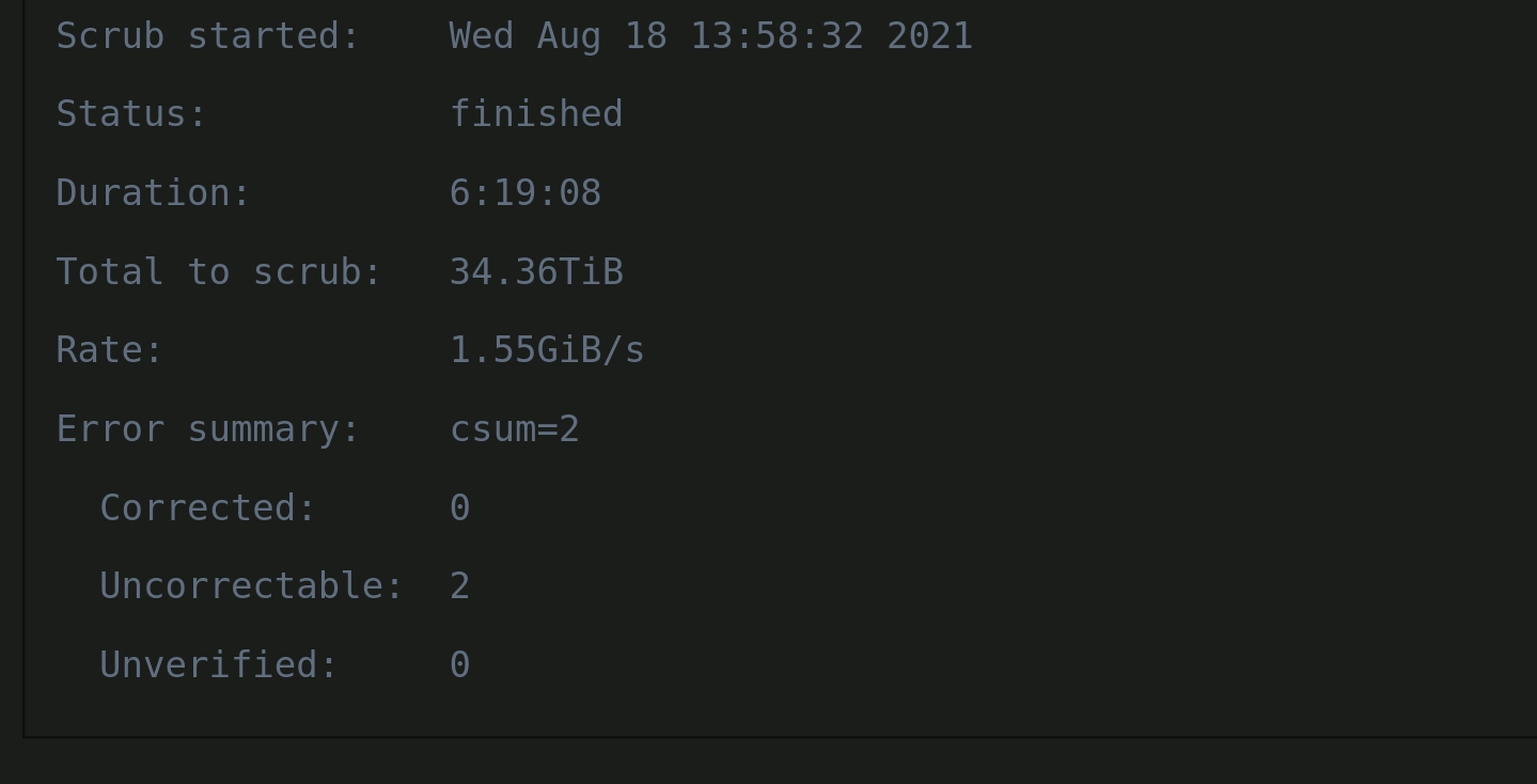

August 19, 20215 yr Author Ok, two uncorrectables, any assist on what to do to resolve / find what they are to fix?
August 19, 20215 yr Community Expert 5 hours ago, fmp4m said: Ok, two uncorrectables Check syslog for name of the file(s), delete them or restore from backup.
