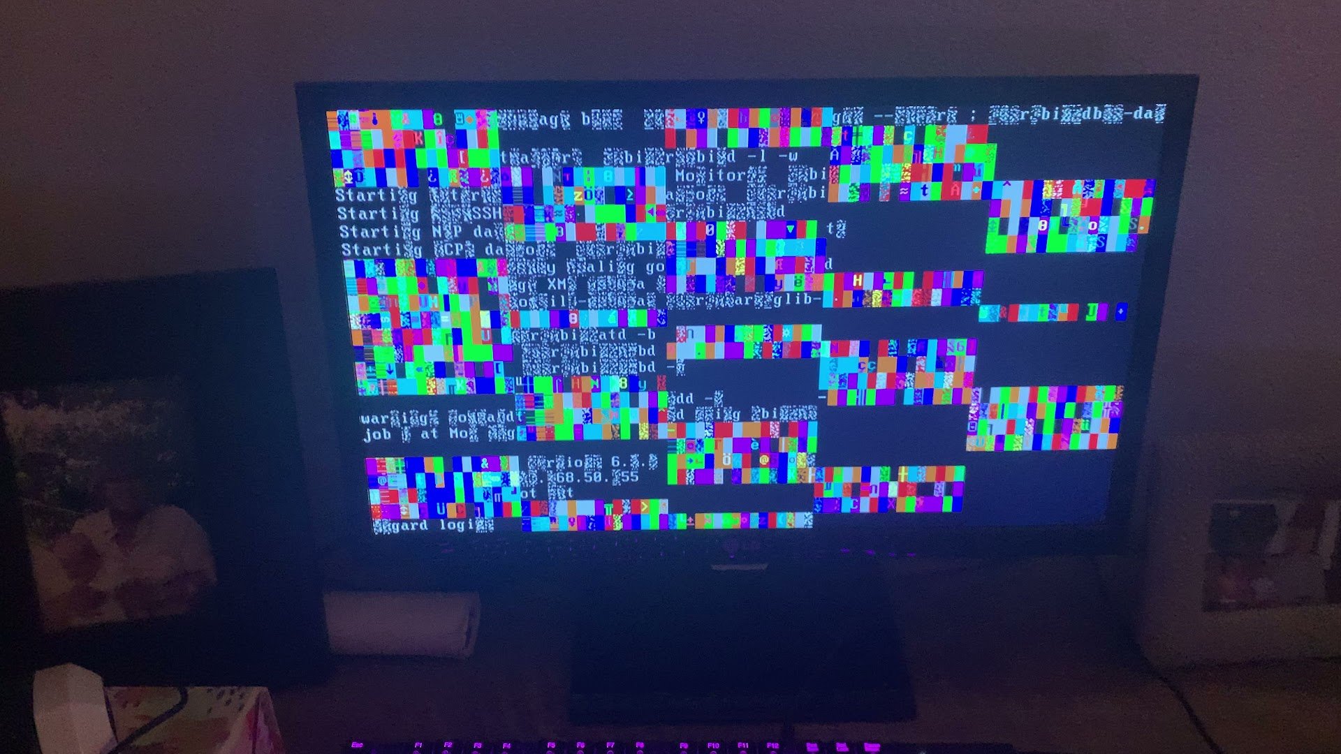

I'm getting to my wits end trying to figure this out. I need some help diagnosing an issue with random crashes, which seem to be occurring during, or after a parity check which takes roughly 12 hours. There was 1 or 2 power outages recently, and this seems to have started after that.
No video output from the iGPU once it crashes (running in command line mode) so I don't get an error message. If I run the Unraid GUI, it will show a garbled output. SSH and webserver not accessible. I thought it might be the CPU going idle so I disabled C1 and C3 power states in the BIOS.

  2. NOT Running in GUI mode (GUI mode crash photo attached).

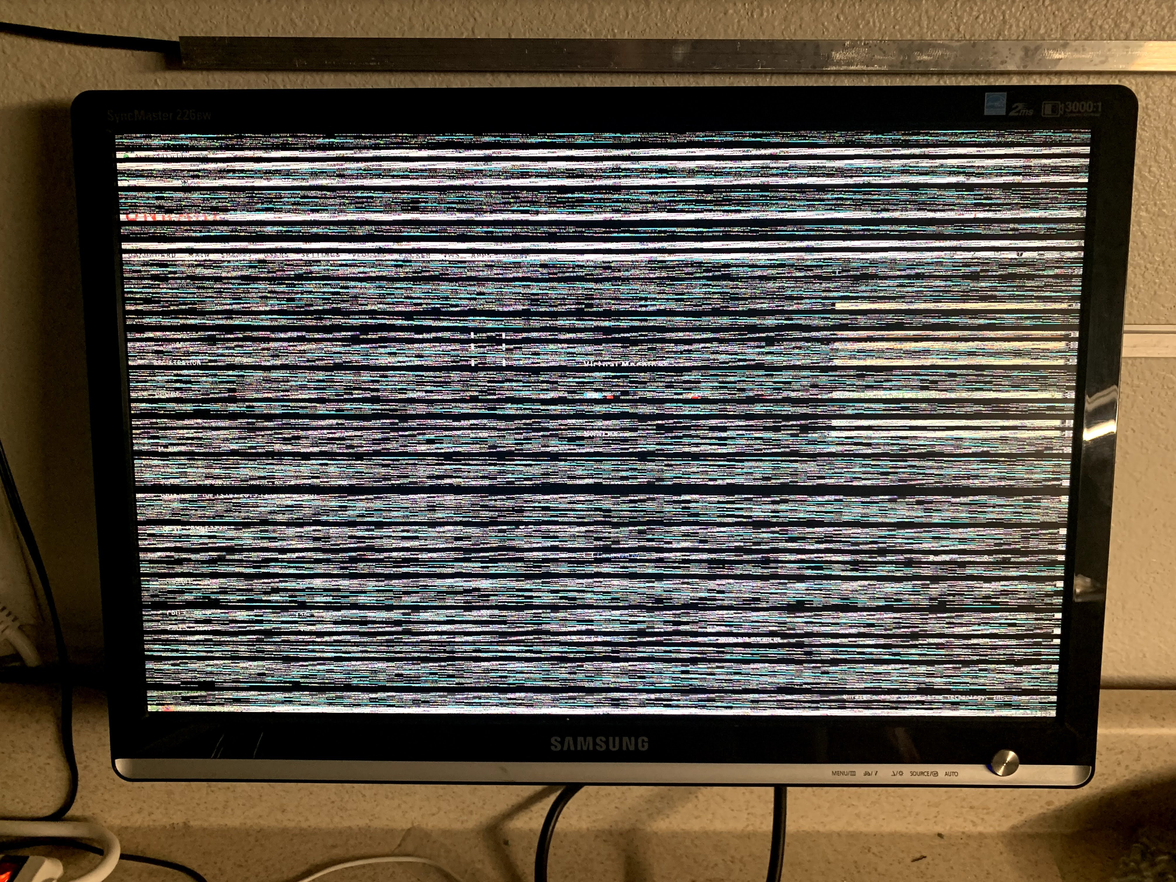

I was trying some more troubleshooting last night and the system managed to crash in the BIOS. I'm afraid this CPU/Mobo may have met it's end. See attached video of a crash in command line mode. Yeah, it looks borked.
I guess I'll try to move the USB, Cache, Data and Parity drive to another machine. However, the BIOS won't detect the 8TB HDDs. Only the SSD Cache and USB Flash drives. Why would this be?
That screen photo looks like bad video RAM.
