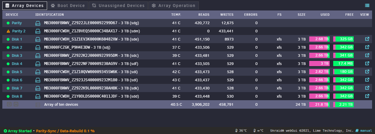

I've just discovered that my Parity 2 disk has been disabled and is in error state
07-09-2021 18:50Unraid Parity 2 errorAlert [TOWER] - Parity 2 in error state (disk dsbl)MB3000FCWDH_Z1Z0VEQ50000C348AX17_35000c50056c10d63 (sdm)
Surprised I haven't noticed sooner! On the day that the drive has been disabled I did replace my CPU coolers so it's possible I've knocked the cabling a little and I know the temperatures are rather high (hot weather at the moment).
I've attached the diagnostics log, would anyone be able to help determined if the disk is at fault or possibly just been disabled because of cabling or something? Thanks! :)
tower-diagnostics-20210909-1149.zip

I did notice a little kink on one of the cables, hopefully it was just this, currently resyncing/building so fingers crossed :)
Those bar colors hurt my eyes :)
I'm not a fan either, rest of the theme though I like :D
