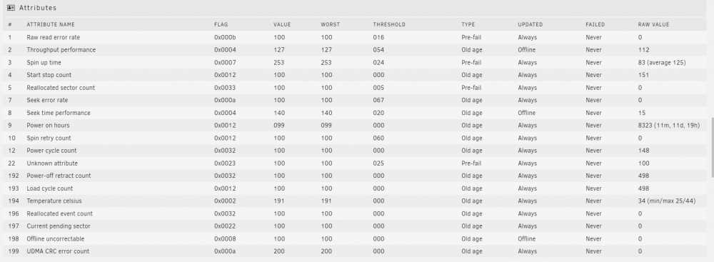

Hi all,
I'm experiencing quite a bit of frustration with one of my drives in my array. Every 24-48 hours or so, when i go to my main dashboard, one of my drives shows a * for temperature and its data is inaccessible. When I boot the array into maintenance mode, I can do a filesystem check and repair, which results in a mountable drive with my data still present. After running the extended SMART test, everything came back as good and all of my pre-fail and old age indicators are clean. Not sure if its UnRaid or one of my docker applications causing this issue, but it's definitely worrying.
Thanks in advance
