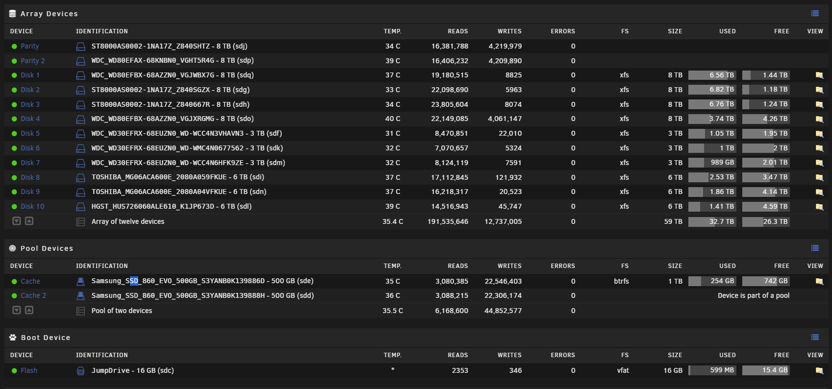

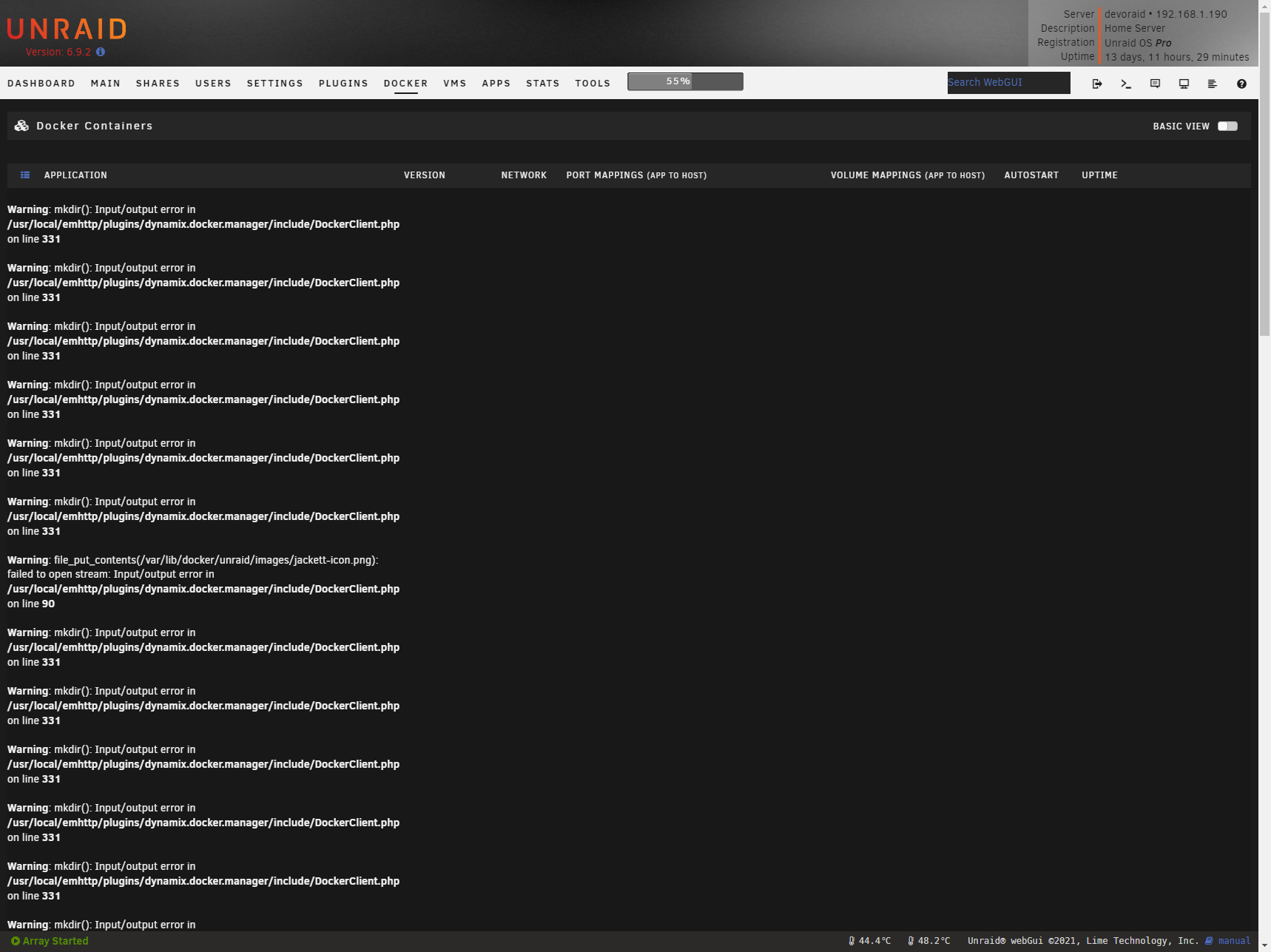

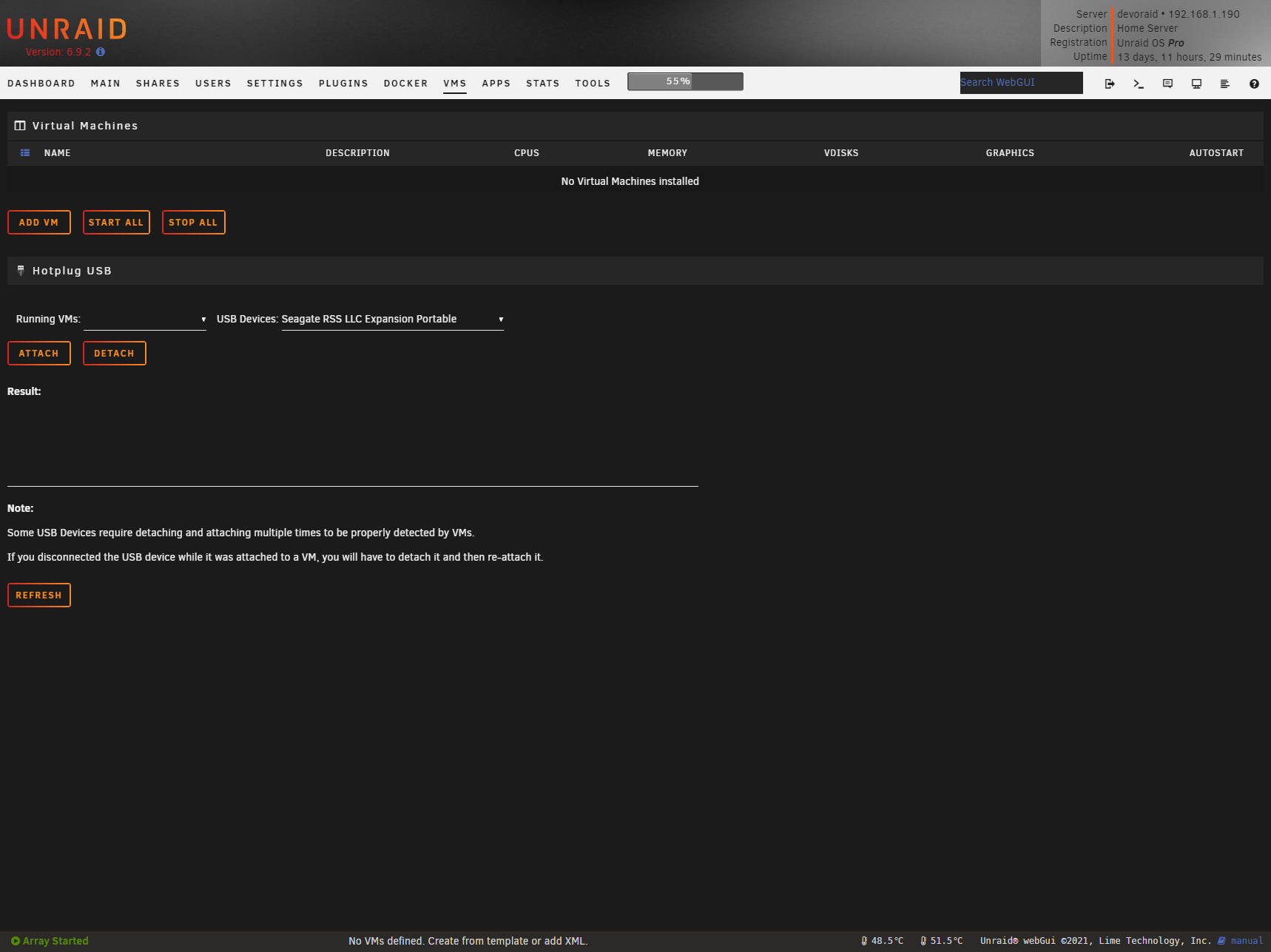

Approx every 2 weeks or so i run into an issue where my server goes into zombie mode, for lack of better word, where all my docker containers malfunction and VM's disappear.

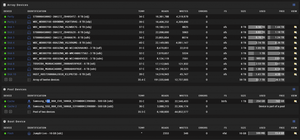

I've gone through the logs (attached), and as far as i can see there are issues with devices SDD and SDE, which in my instance are two Samsung SSD cache drives connected directly to the motherboard (rather than the HBA that the rest of my array is connected to).
Both of the SSD's are less than a year old, and both were purchased separately at different times. The disappearance of my VM's and broken docker container i would assume is due to the fact that they're all hosted on my cache drive.
