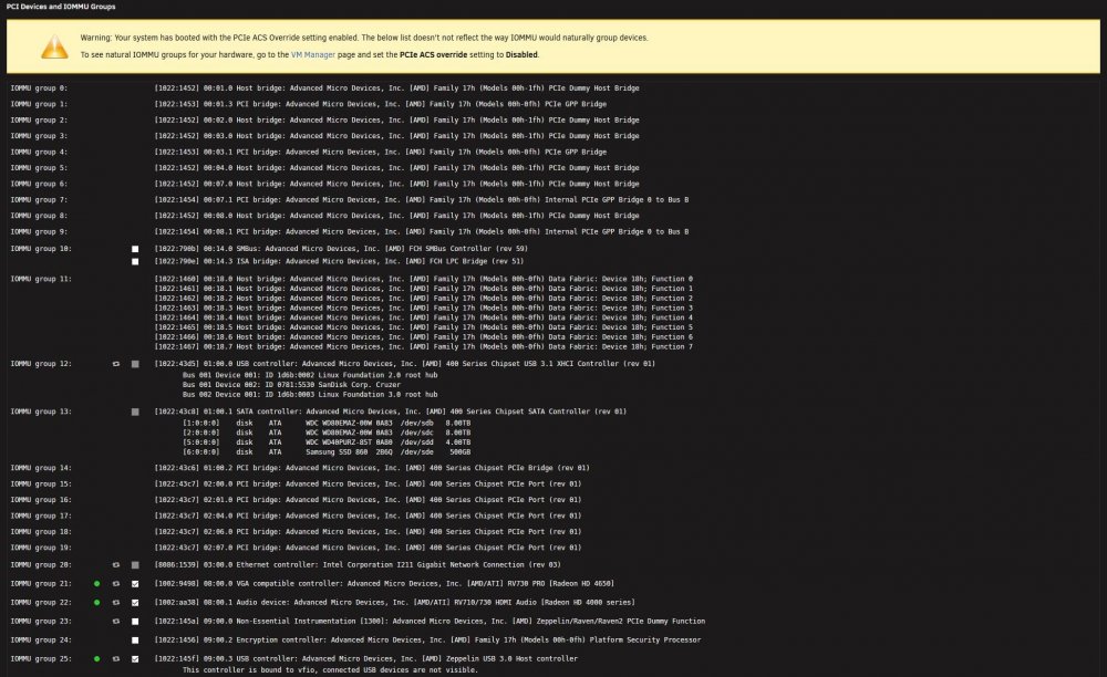

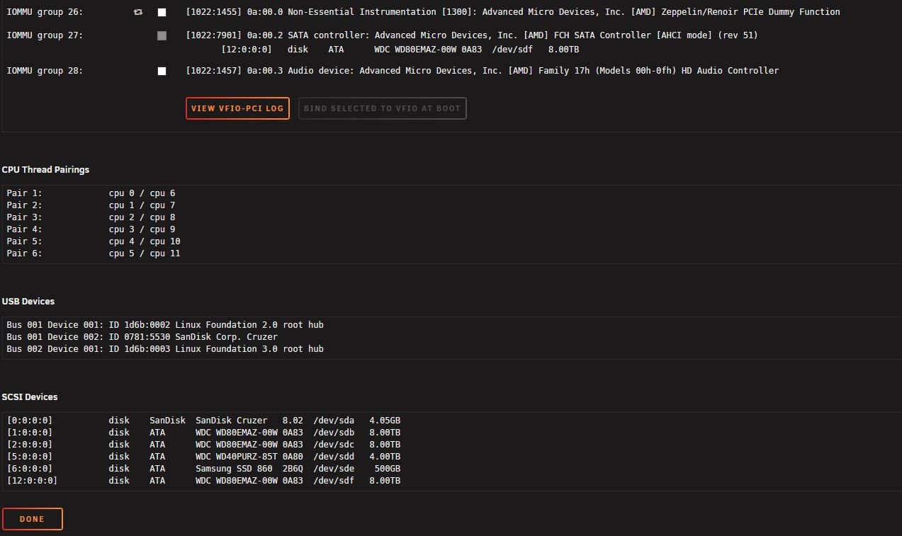

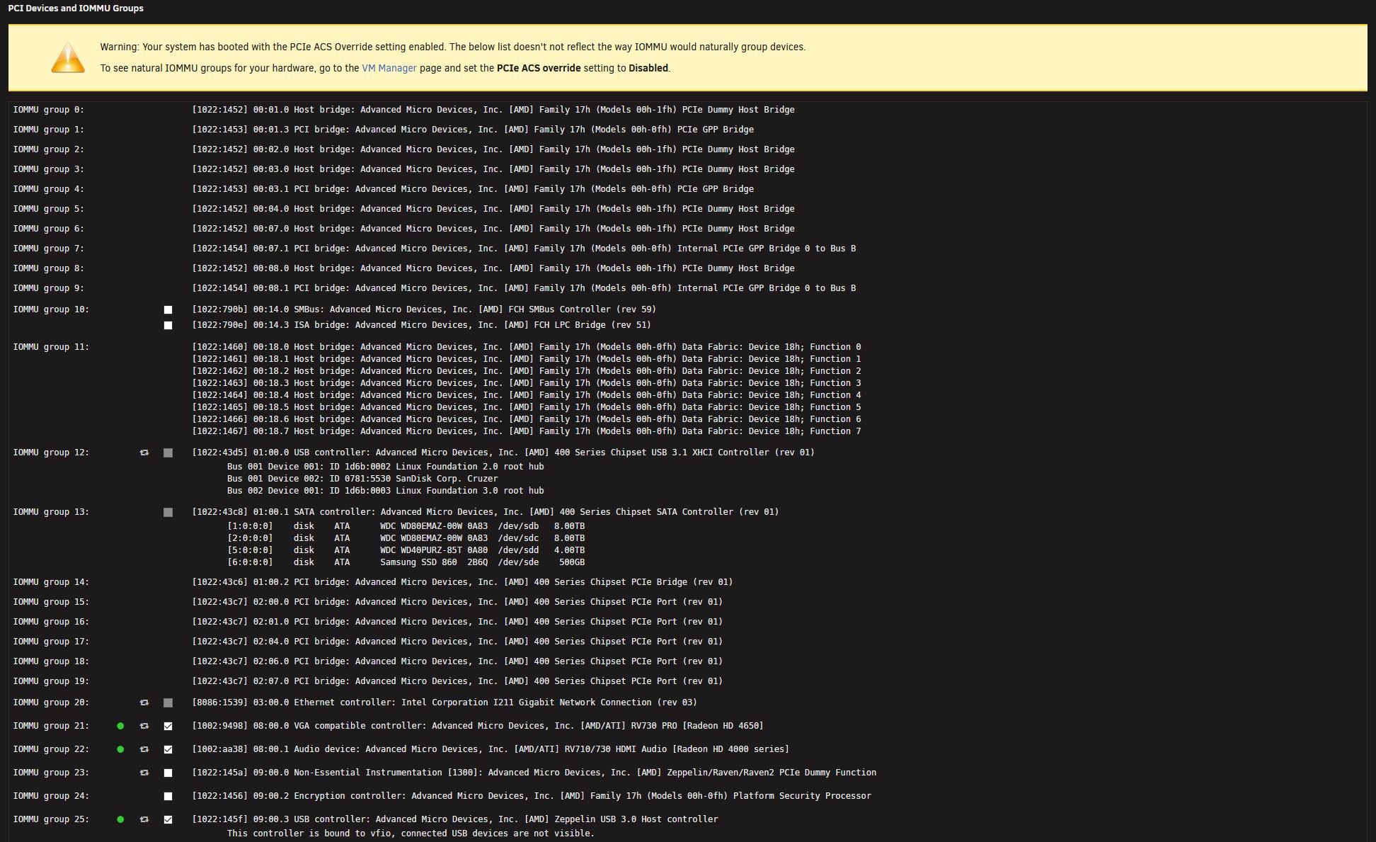

Under Tools > System Devices I see I've PCIe ACS Override setting enabled to pass through my USB 3.0 controller to a VM.  I also see the primary GPU listed as in-use ... images attached.
FWIW - I vaguely recall adding some code to a black list file(s) but not sure if it was on this server.

5 hours ago, bugsysiegals said:
Thanks for the reply.  I've only 1 GPU in the server which is attached to a monitor and I can watch it boot  UnRAID GUI mode with all the command lines it's just that the code freezes at the vfio-pci line and I desire it to continue until command prompt.
Ok, if you have only that gpu it's normal that you can't see any output once it attaches to vfio.
You choose to bind it to vfio driver, or in other words, to not be used by unraid.
To have it back available for unraid you need to uncheck the gpu and the audio part from vfio (iommu group 21 and 22) and reboot unraid.
