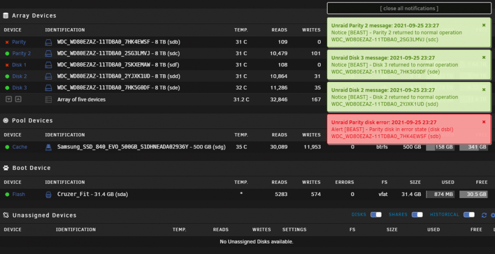

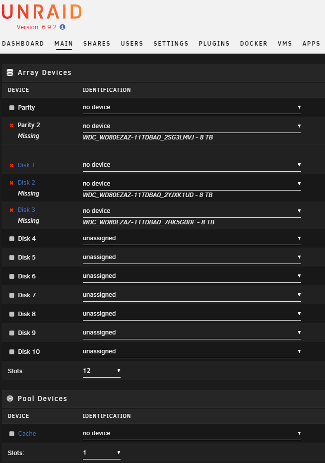

On Monday, Jellyfin stopped responding. I thought a cache was full but all cache said they had room. I stopped and restarted the array anyway. Jelly fin worked for about ten minutes then stopped. Then, I stopped the dockers and some drives showed up as unassigned. I stopped the array which resulted in Parity drive 1 and disk 1 showing “no device” and showed the missing drive name. Even though, I haven't change anything, now Parity drive 1 and disk 1 still show as "no device", yet don't even have the missing drive names and the rest of the drives are showing "no device" with the missing drive names.

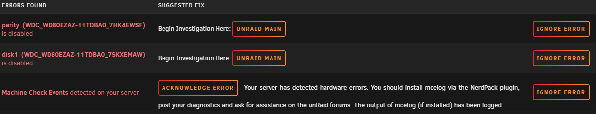

Fix common Problems shows
mcelog shows
Array Devices shows

I rebooted it and the same errors of “no device”

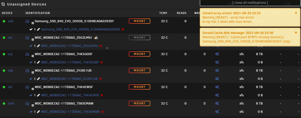

I tried again with the power removed. It started the array with 4 disks and filled the log file to 100% with read errors faster than I could check it.
Then all 6 disks showed up in Unassigned Devices and the system was almost completely unresponsive.
All cores where at 100%. I was able to stop all the dockers that auto start but could not get the array to stop. I waited an hour then did a system shutdown. I let the system run for two hours then I had to you the idrac to force a shutdown.
