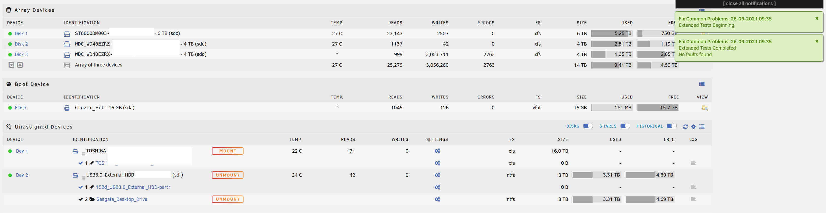

I ran into a hickup while migrating/copying from my HDDs to Unraid. The first 2 discs went perfectly, now the 3rd disc is throwing the error mentioned above while copying data onto it.
What I tried so far:
move data via Krusader
move data from other PC via LAN to share
use different SATA cable
use different power cable
use different SATA port on mainboard
connect sata cable to my 9207-8i instead of onto the motherboard directly
sadly everytime the same outcome and I ran out of ideas...
Mainboard: MSI Z170A Gaming Pro Carbon
PSU: BeQuiet Dark Power Pro 11 1200W
The error from the Log:

SMART Status from the HDD:

If you swapped cables with a working device and errors continue it suggests a disk problem, despite the healthy looking SMART.
Oh OK, so I guess I move the data from that disk via unBALANCE and buy another one...
After the problematic disc is empty, I could preclear it and see if that throws up any issues...
