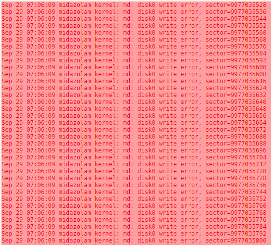

It started this fine, got mostly through and:

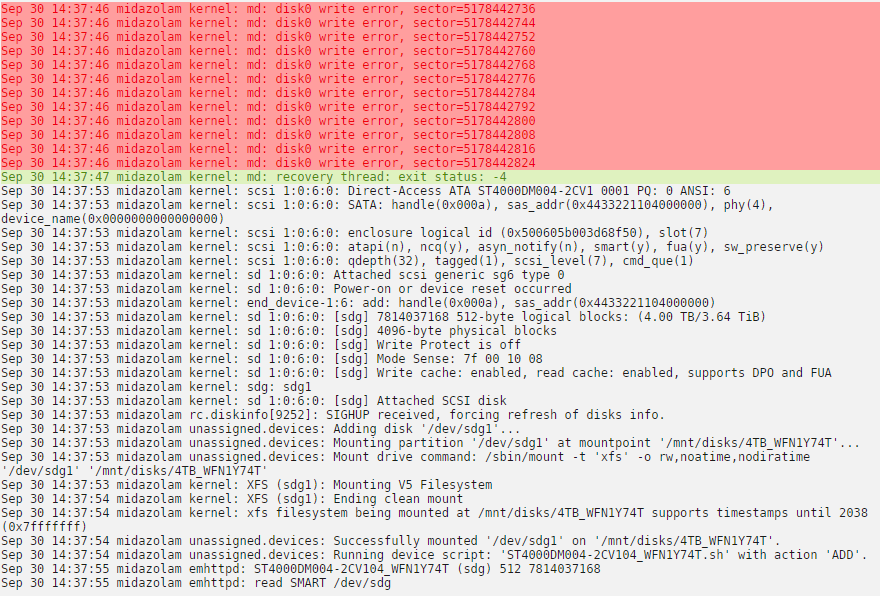

Tried remove/add/rebuild again but this time caught it in the log when I was sitting next to it and heard a drive click:
However, the ST4000 drive noted after those errors is NOT the cache drive, but one I used with Unassigned Devices as a storage/transfer drive - so could be unrelated too.
Is there anything else I should be checking, or just get the RMA'd drive and see how it goes.

Diags are after rebooting and you didn't capture the beginning of the problem, SMART for the disk looks OK, but clicking noises suggests it might not be, you can replace/swap cables to rule those out and try again.
