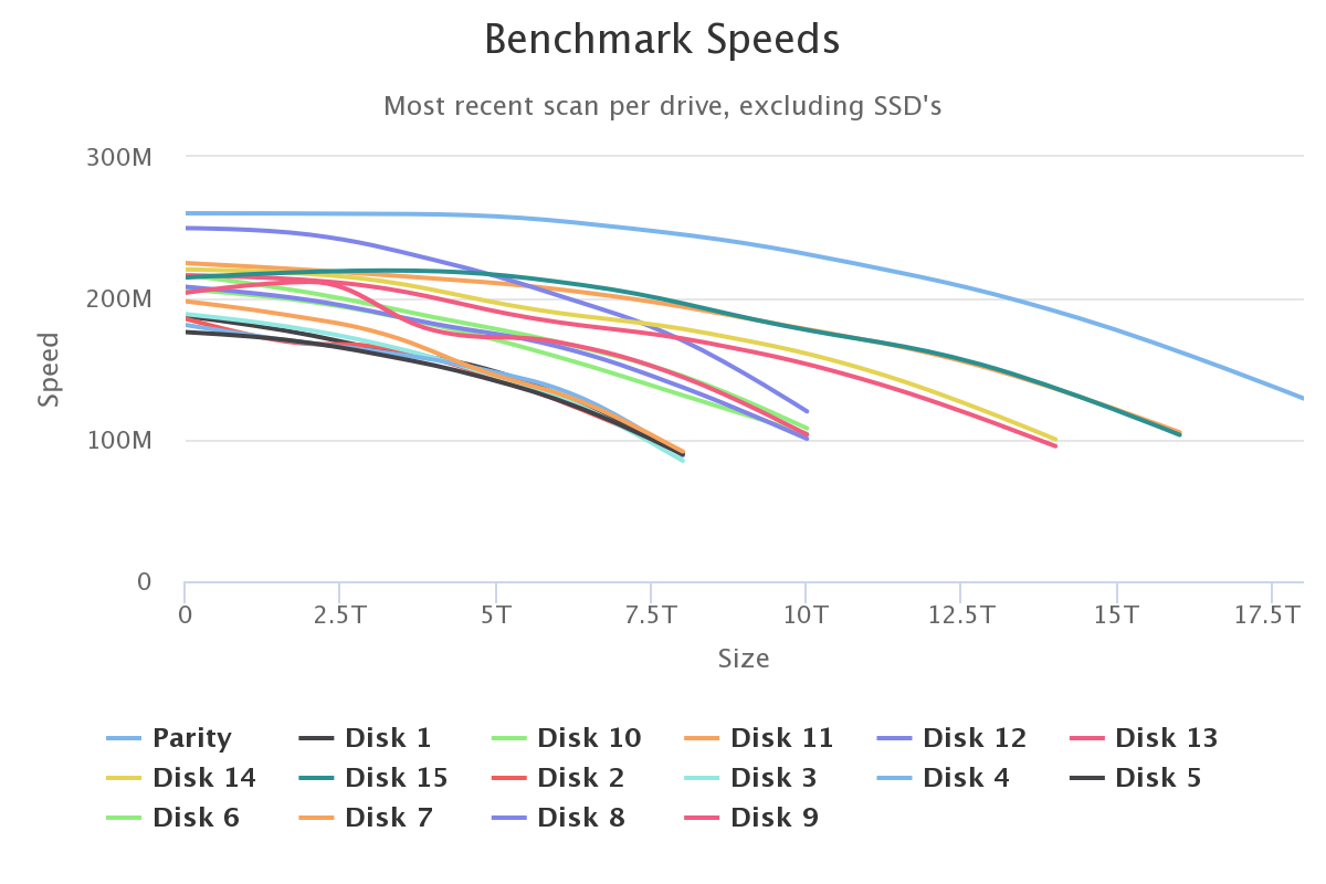

  • Run drive benchmarks
  • Disabling Parity to test stability
Other Details:
When the issue is happening and I catch it early I can usually get the system to recover with "mover stop".  But it doesn't go back to normal for anywhere between 10-30 minutes.  It will still spike CPU.  Stopping docker altogether similarly does not immediately resolve the issue, nor doing both simultaneously.
Attached are unraid diagnostics and the syslog from before the mover process started until I had to hard reboot the server a few hours later.  In this example I could access the unraid WebUI but not the docker tab.  Some docker containers were still working (emby, for one) but others were not (tdarr server node).  Also attached are the recent results of drive.  Parity was building during this lockup.
