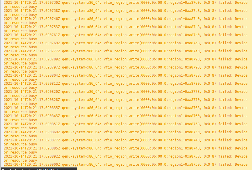

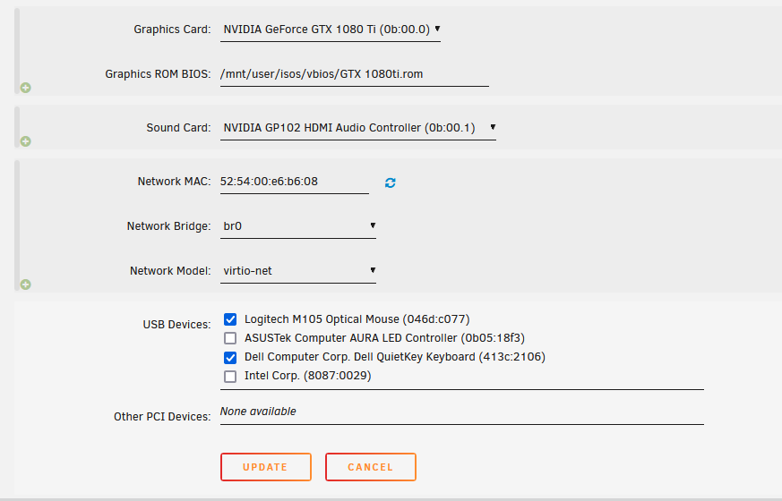

windows vm don’t want to run i get the errors ,

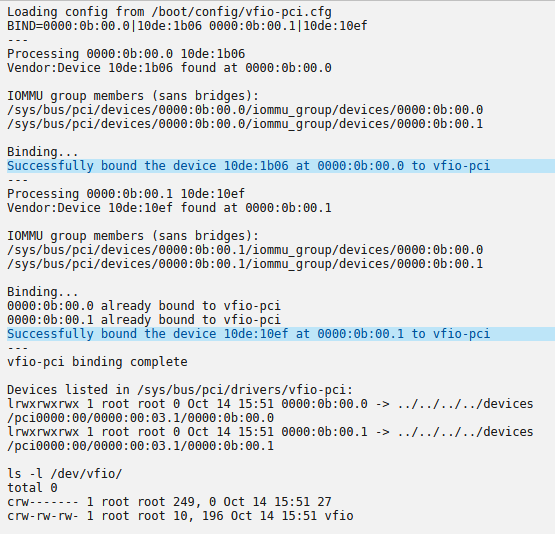

i also tried binding but result stay the same, i gave it multiple tries,
as you see the vm screen shots had gtx in front of file name ,
i don’t know what is wrong , the error screenshot is the gpu adress,
i also tried to re-create gpu bios with enabled binding but that don’t work,
i need some support fellas,
If you are booting unraid in uefi mode, most probably the gpu is in use by unraid itself, by efifb, if you want to check run "cat /proc/iomem" in terminal and check why qemu cannot write to that addresses highlighted in yellow.
If you find efifb is using that, one way is to disable efifb in syslinux:
video=efifb:off
Note that you will need remote access to unraid because you will not have a video output anymore.

i re-created the unraid usb with uefi disabled, booted into unraid with uefi off in bios, or so i think it is off because it boots , unraid started just fine, started trial again , gone to the vm, swapped vbios files to see witch one would not give problems, but windows keep saying there is a problem, but atleast it shows video , at a lovely 800x600

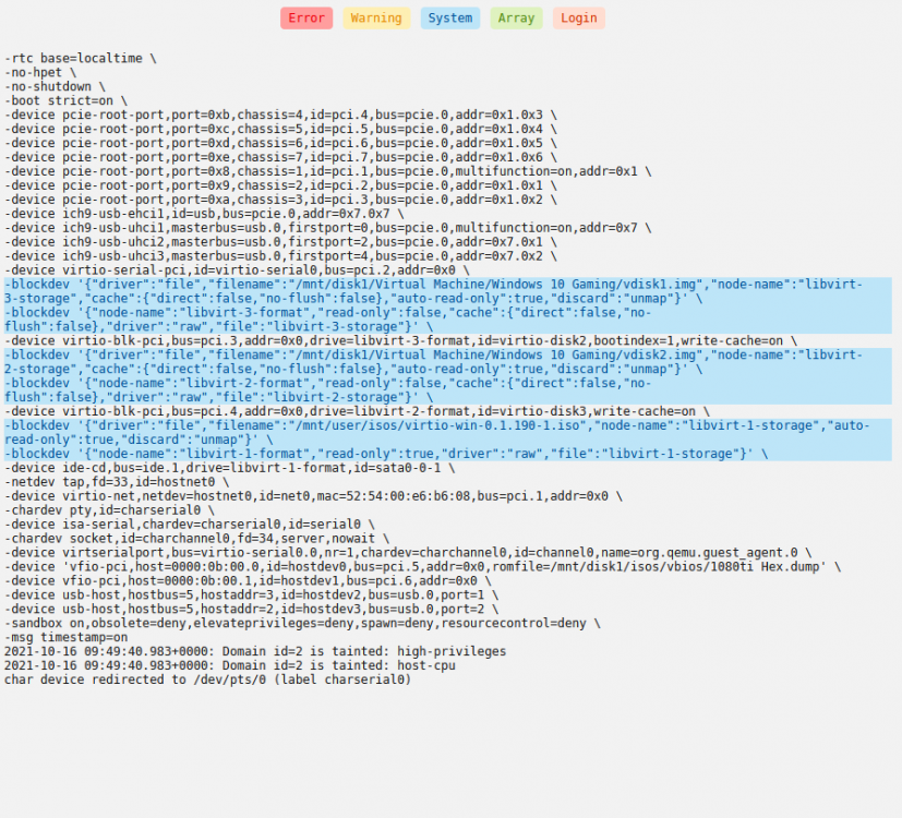

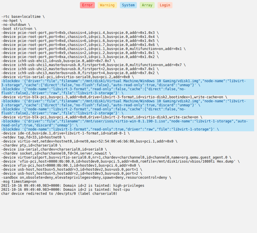

this is what vm log says
Edited by Hanako
Screenshot above doesn't show any error.
So you are able to boot unraid in legacy bios mode, run the windows 10 vm and you get a video signal, at 800x600, but in the gpu device status some problem is reported (which problem)?

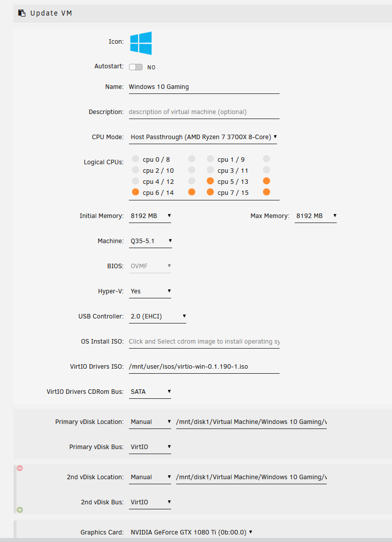

1. does your vm is configured with ovmf?
2. are you passing through all the components of the gpu?video, audio, (usb controller)?If you don't know what I'm talking about attach the diagnostics file.
3. are you using a proper vbios for the gpu?Dump your own, do not use a downloaded one.

i sloved it, with support of discord people and forums,
i had to change my mobo settings to legacy,
i recreated the usb with no uefi,
and yes it all works fine for now,
iommu checked gpu audio/video

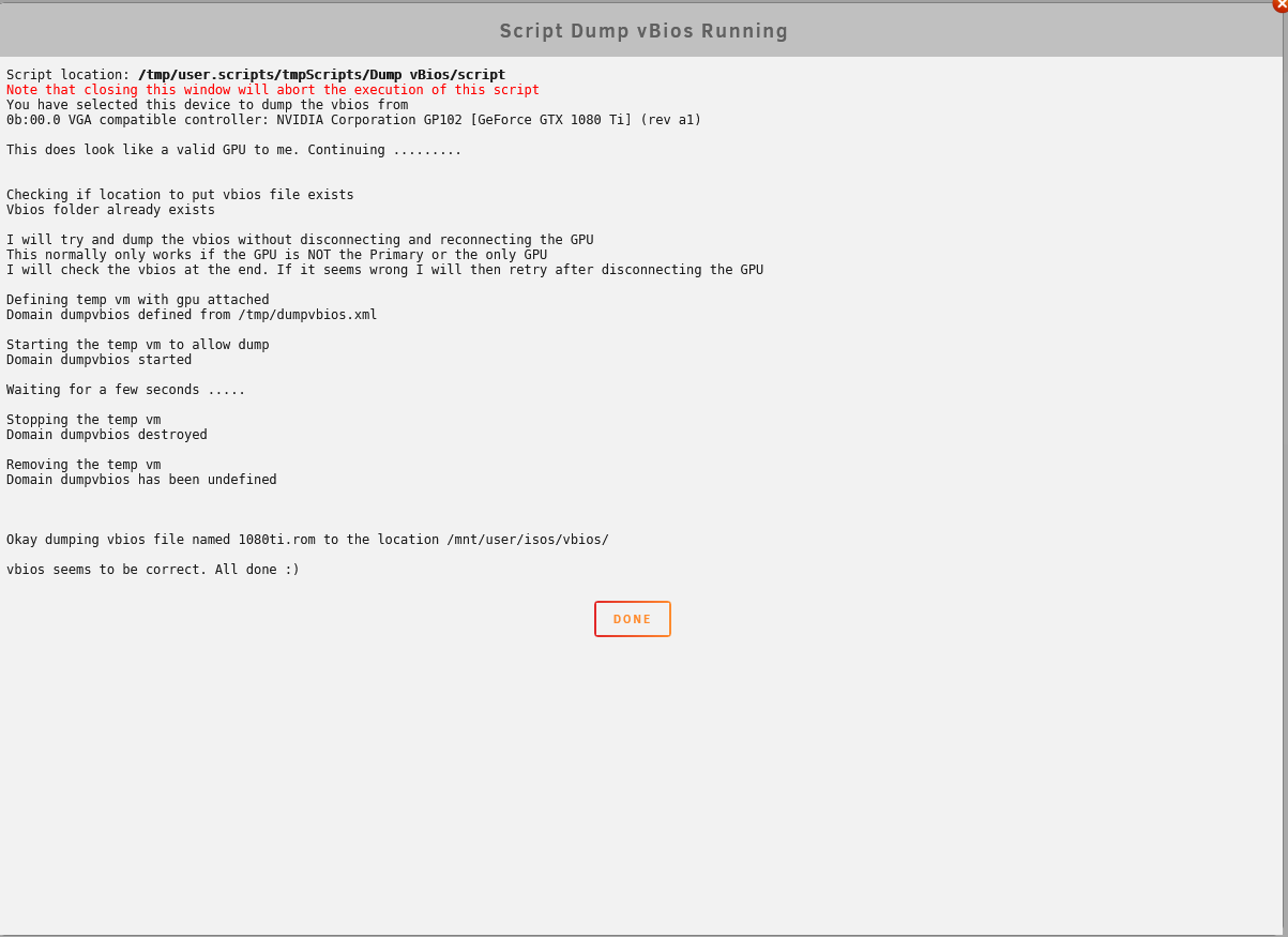

and the vbios i used is created with that script from that youtube video,
i assume he knows what he created ,
so far so good it all works except i wont get full resolution of 5120x1440,
but i think thats because the hdmi cable i use,
